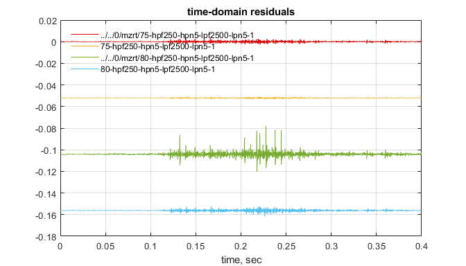

How is the Barkhausen noise graphs in post 31 obtained?
Am I correct in understanding the assumption here is with current drive the Barkhausen noise is absent because the magnetic circuit is more stable than with voltage drive?
The Barkhausen noise graph was obtained by using https://www.mathworks.com/matlabcen...peakers-for-aec-measurement-and-linearization. You can get the same with the latest beta of REW choosing FSAF as your measurement method.
My speculation on the absence of Barkhausen noise is that the domain flop ends up in EMF, i.e. a voltage spike. The current I=V/(Zspk+Zout), where Zout is the output impedance of an amplifier. For voltage drive, Zout->0, for current drive, Zout->infinity. Then F=I*Bl, and a=F/m, etc... A specialist such as Esa Merlinen would be the guy to confirm or discard my speculation.
Yeah, exactly, that's the logic that makes sense about, compared to some others floating in the forums.

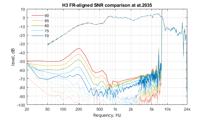

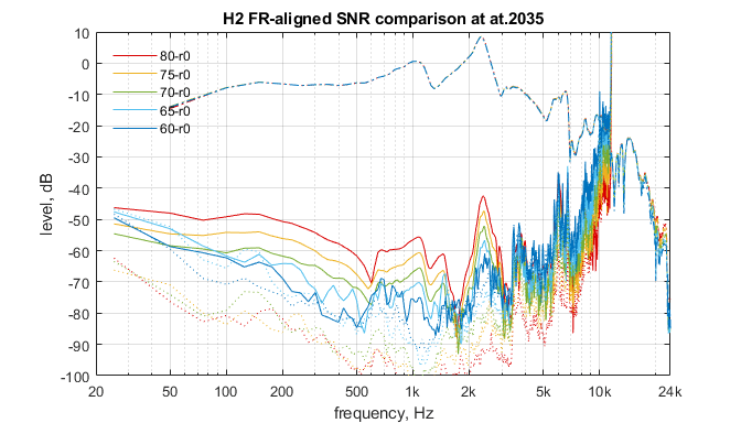

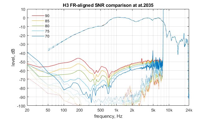

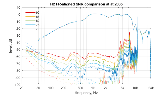

Dayton Audio DSC-165 subwoofer. Unfortunately, I did not have a good-sized box, and put it into ~6L, so the Fs went up.
Voltage Drive, H2 H3, for output varying from 60 to 80 dB SPL:
Same on the current drive:

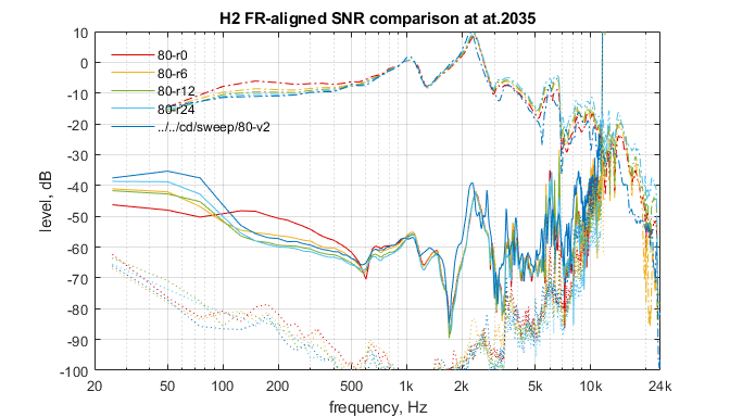

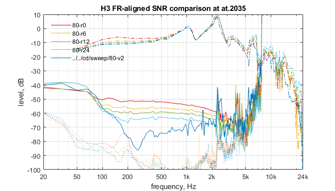

Finally, comparing how distortions change depends on the series resistor 0/6/12/24 Ohm - and Current Drive.

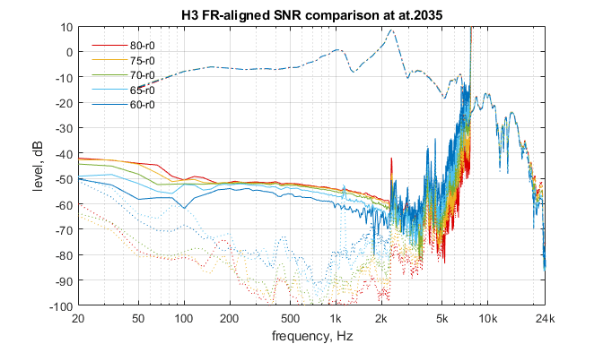

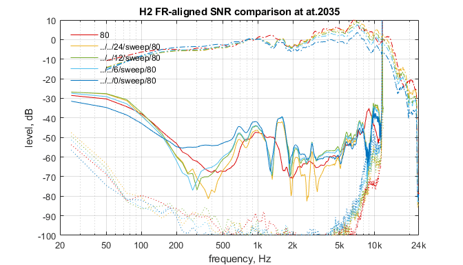

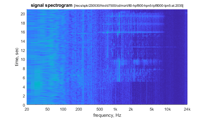

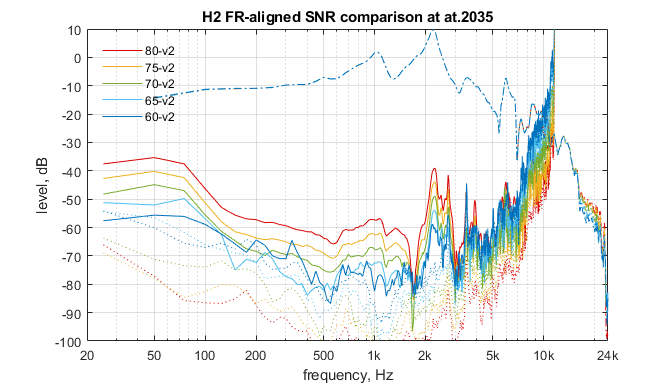

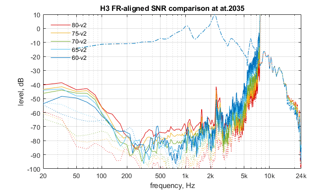

HiVi D7500 midrange dome.
Voltage drive:
Current drive:
I also experimented with driving D7500 with series resistors 6/12/24 Ohm, current drive with LM3886 (GBP=2MHz, yellow curves) and LJM's MX50SE (GBP=7MHz, red curves). MX50 SE shall apply an additional 10dB of feedback loop gain, which could have lowered the distortions even further... but it did not. It appears that applying more feedback than LM3886 does not bring any lower distortions, you "run into a wall":
You can not observe any differences in objective exponential sine sweep measurement data of the acoustic output.

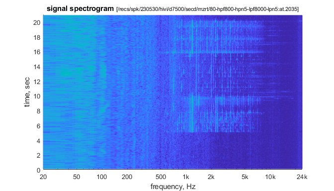

However, the differences are clearly audible when music (Mozart piano concerto) is used instead of sine sweep, and the residuals are objectively lower. If you can see it on spectrograms ... while ignoring different background noise... I am not so sure.
LM3886:
LJM's MX50SE:
LJM's MX50SE is certainly a better amplifier than LM3886, even if the sine sweep tests do not show it.

Great work! Could you specify the series resistor setup? Is it a current drive amp and resistor in series with the driver? Maybe a simple sketch would be the easiest way?
Thank you! The setup is a usual "voltage" amplifier, with resistors added in series to the driver, and the volume adjusted so that it produces the ~same acoustic output. Well, it can not be exactly the same due to calibration errors and the FR changes, but as good as possible.

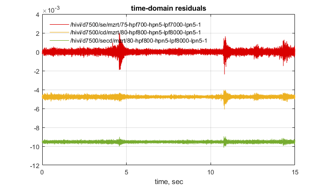

BTW, the comparison of residuals between the voltage drive (red), current drive with LM3886, and current drive with LJM's MX50 SE (green):

As I hoped, Barkhousen's noise is gone with the current drive. These noises are the short spikes, like Dirac's delta functions, during loud passages, corresponding to magnetic domain flops. Being delta-function alike, they have a very wide spectrum and therefore are not maskable. For my ear, they are especially annoying on piano.
Here are the non-linear residuals of playing a Mozart's 20th piano concerto's tutti through HiVi D5.4 on
red: RMS 75 dB SPL , voltage drive
yellow: RMS 75 dB SPL, current drive, distortions are much lower.
green: RMS 80 dB SPL, voltage drive: Barkhousen noise is prominent, emf/Zspk, when Zout (of amplifier) = 0.
cyan: RMS 80 dB SPL, current drive: Barkhousen noise is gone, emf/(Zspk+Zout), when Zout->inf
Wow, that's a very interesting observation when using current drive. Thanks for posting your measurements on this.

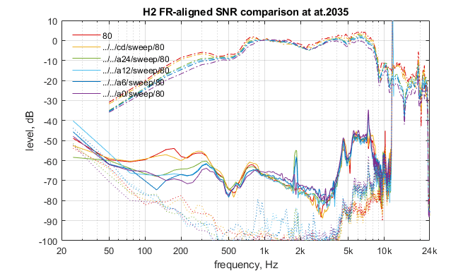

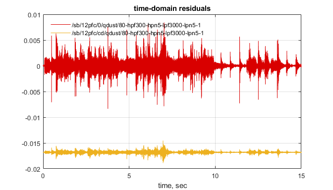

SB12PFC25-4 is a typical corners-cut junk to get to the lowest price. Can the current drive make it usable?

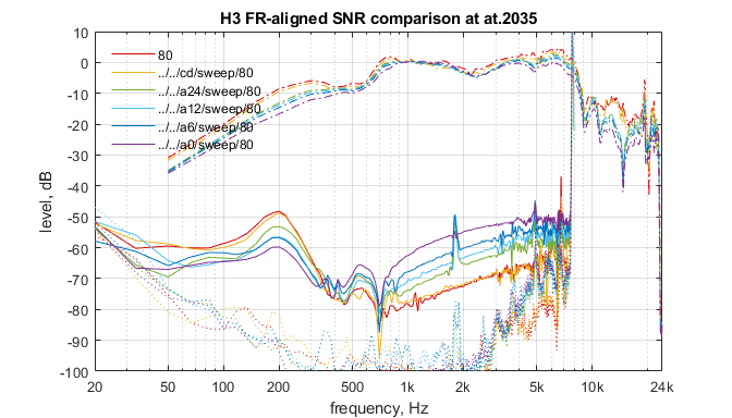

Current drive (red) vs voltage drive with 24/12/6/0 series resistors:

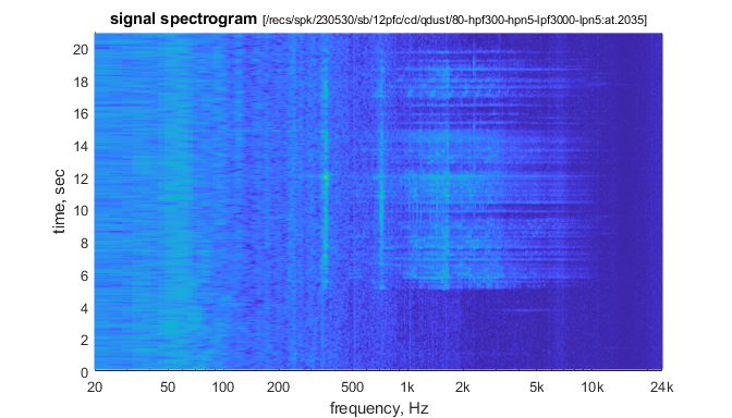

At first glance, it looks promising. The LTI distortions on music (Queen's Another One Bites The Dust) filtered 300...3000Hz,
Red= Voltage drive, Yellow - current drive:
However, it is not as rosy as it may look. Alas, the sine wave measurements do not show the full picture. (Any) music shows stubborn spikes on 350Hz and 700Hz:
Where do they come from? I have no idea.

How these sound like to ear? If you can could you post audio sample for voltage and current drive?
Try mounting it 'backwards' in the baffle and feeding sine wave to the driver at these frequencies, I suspect at least one of them is basket resonance.Where do they come from? I have no idea.
Very nice info you're presenting! I found similar effects reducing H3 when adding series resistors or inductors. I like using multitone signals and looking at the 'grass' between the tones. I think it's a quick and easy visualisation.

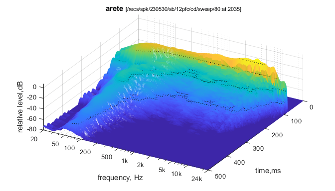

That was a non-linear artifact, current drive only. You can't see it in the linear IR. Here is a wavelet-ish view of IR, with the window scaled up 1/f.
The box is 2' long, tapered at the end, and full of acoustic foam, least dense at the driver, and most dense at the end. You can speculate that 350Hz is about half of a standing wave lambda, but why is it only in the current drive?
Because it is hidden by the incredibly brutal noise in the voltage drive?but why is it only in the current drive?

My guess is that is around resonance (seeing now it's below 100Hz) of the driver in box, you have some ringing because the resonance has no electrical damping, only mechanical damping. Maybe you can check impedance curve to verify it?
IME once you really exactly(!) clone the driver terminal voltage of voltage drive those difference tend to go away completely.but why is it only in the current drive?
The cloning method is to measure the impulse response of the driver current under voltage drive and then use that IR as the EQ (FIR convolution kernel) for the current under current drive. It contains all the warts seen in the current**) under voltage drive, including the effect of internal standing waves etc.
**) The linearized equivalent of the current, that is, precisely speaking. When the current is loaded with gross distortion then it could be the current steering may not fully/correctly EQ.
Many of the better softwares do a full Farina Log-Sweep where we can see the distortion in the current right away and know the problem zones.
[...] These noises are the short spikes, like Dirac's delta functions [...]
When such a spike excites/stimulates a mechanical resonance the result is a non-linear artifact?[...] That was a non-linear artifact [...]
An artefact yes, but not necessarily a nonlinear one. But it might now be noticeable while it wasn't with voltage drive due to the better damping of the latter. So current drive is probably not a cure-all but another tool in the toolbox that has to be applied wisely in order to get the most out of it.
