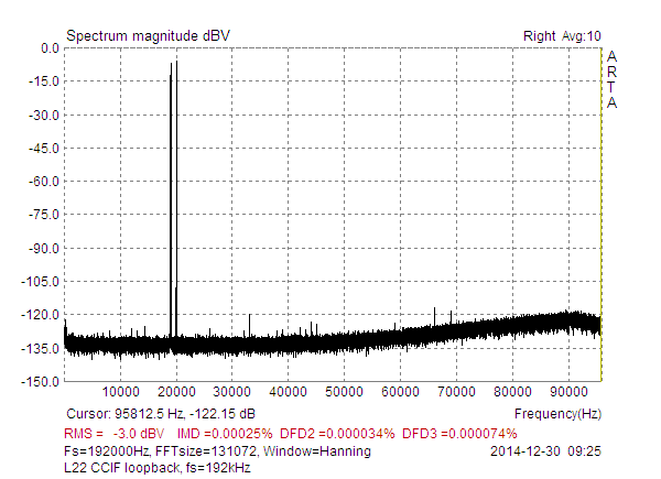

If I want reliable measure real distortion performance of preamp and power amp, it is simply unusable..not enough resolution and informations.
And do not swap THD+N (16ppm) with THD alone (0.69ppm). To make isolated bal/unbal conversion is easy , use quality signal line trafo (e.g. Jensen, Lundahl) with active distortion compensation, frequency response is flat to more than 80kHz, distortion in audio band about 1ppm.
And yes, card performance is level dependent , for L22 is best distortion performance obtained with levels about 0dBV, both input/output. It is not so complicated to make some dividers at impedance about 1kohm and lower, for audio band no need for compensation. It is not UHF band..
I own Neutrik A2 analyzer, new bought.. It is convenient to use, safe, but THD limit is about 0,001%, no information about harmonics content and about 10times more expensive as Lynx22.Any used 16 bit audio analyzer you can get for less than a L22 ... will do the same job as the sound card, without any of the soundcard pitfalls.

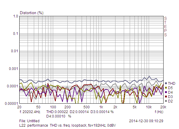

Try to show us real performance of Your solution , something like in attached pictures..
This was done about 10 years ago with a M-Audio Delta-something or other PCI soundcard inside a desktop PC. It was running in 16 bit mode as the software I had at the time didn't support anything more. I think FFT windows have improved considerably since then. 🙂
