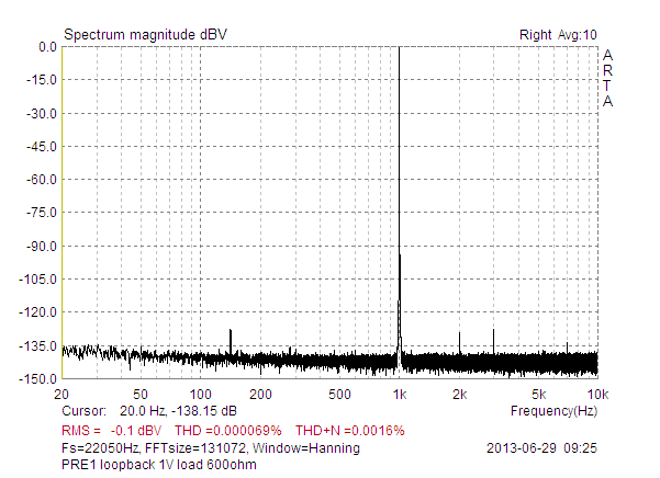

10ppm THD would be exceptionally good for a soundcard-based measurement. If I saw a figure better than that on a loopback test, I would suspect someone had put absinthe in my Buckfast. 🙂
Another thing to ponder: The guys at AKM, Wolfson etc. who design the audio converter chips. How do they measure the performance? They probably stick the new chip on an eval board and hook it up to an Audio Precision system. So the graphs in the ADC datasheet really show how the chip performs compared to AP's latest gizmo.
I forgot to insert a smiley. An audio expert would not come up with such a claim of 10 ppm thd obtained with sound card measurement.
Believe or not, preamp measuremet obtained with Lynx L22 soundcard.."Tempora mutantur"😉
