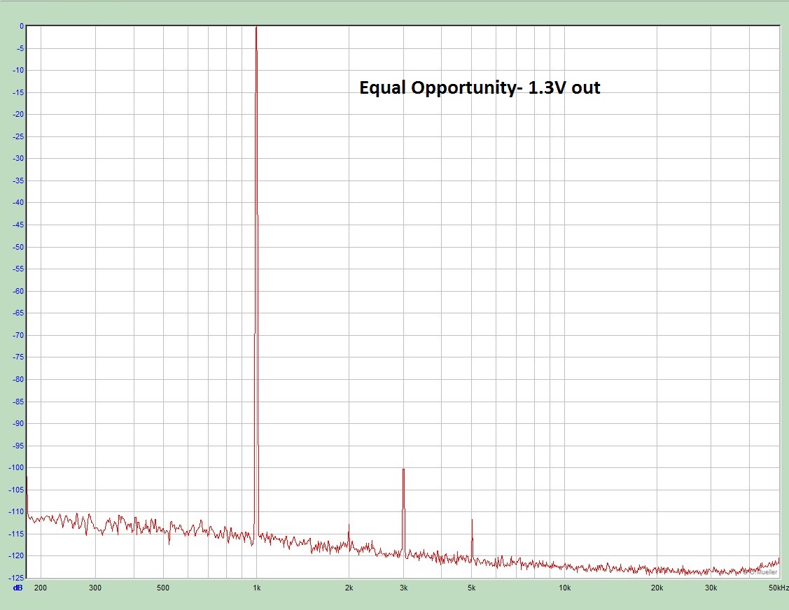

Which is as it should be. But it's important to point out to readers here that Windows-based measurement systems can achieve great results without getting into a lot of complication, and that the worries of 20 years ago just aren't relevant any more.
