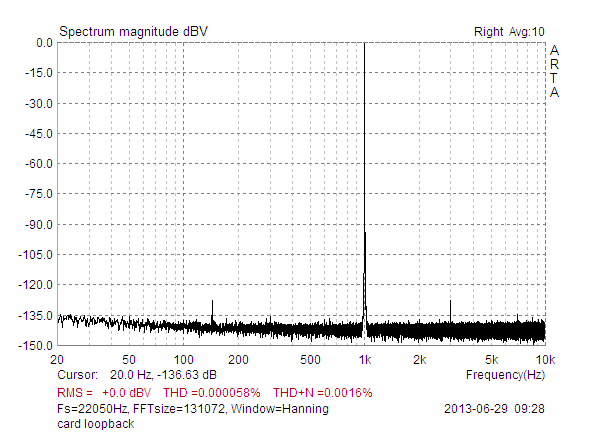

LTspice sine source is intended as ideal, so a,b,c answer is zero THD (not THD+N!!)
Fourier components of V(in)
DC component:-2.27707e-015
Harmonic Frequency Fourier Normalized Phase Normalized
Number [Hz] Component Component [degree] Phase [deg]
1 1.000e+04 1.800e+00 1.000e+00 -0.00° 0.00°
2 2.000e+04 1.834e-12 1.019e-12 -0.15° -0.15°
3 3.000e+04 2.750e-12 1.528e-12 -0.08° -0.08°
4 4.000e+04 3.668e-12 2.038e-12 -0.03° -0.03°
5 5.000e+04 4.585e-12 2.547e-12 -0.01° -0.01°
6 6.000e+04 5.501e-12 3.056e-12 -0.01° -0.01°
7 7.000e+04 6.418e-12 3.566e-12 0.01° 0.01°
8 8.000e+04 7.334e-12 4.075e-12 0.01° 0.01°
9 9.000e+04 8.252e-12 4.584e-12 0.02° 0.02°
Total Harmonic Distortion: 0.000000%(0.000000%)
THD= the ratio of the sum of the powers of all harmonic components to the power of the fundamental frequency (expressed in % of power for fundamental frequency).
What is power of harmonics for ideal (without harmonics, only fundamental frequency..), non distortive sine source??
But if you want to play with words, "infinitely close to zero"..
hahfran, THD calculation formula is attached.
For ideal sine wave source, all components at the top are zero, so THD = 0.
As simple as that. No approximation required. Number of digits normally used for calculation is enough to consider it "zero".
In a live measurement, you run FFT, get the values for each V and then use this formula to calculate THD. Of course, you can take in account more or less harmonic components, but in the end the level of accuracy is mostly influenced by the level of hardware linearity. I don't mention noise now - a separate story.
P.S. I was writing in parallel with BV 🙂
P.P.S. I still don't understand what you are trying to prove. The level of precision we show cannot be reached with the computer card? This is not the case. Depends on the card. If you want to do a direct comparison of the results from the good computer-based measurement system versus the well-known-branded hardware analyzers - you can do it. It will take some time and money, but why not, if you need it. Although, most of the people here don't, I believe 🙂
External loop-back measurement gives you resolution level of the measurement system with particular equipment. If it's good enough - ok. If not - one looks for some more expensive / precise solution. External loop-back does not lie. If you know what I mean 😉
