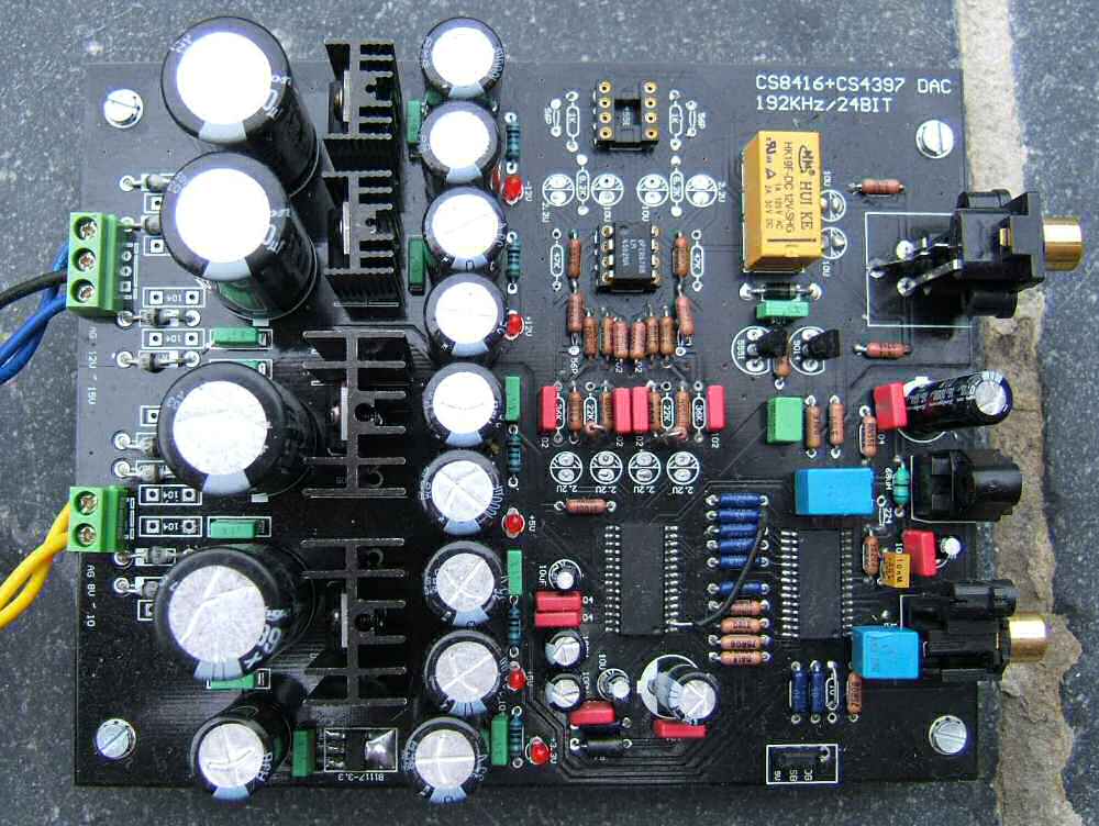

Would like confirmation on the pin 20 mod to the CS8416 chip; since there seems to be many different models of this DAC in this discussion.
The photo is of one of the model boards that does not use an adapter for the CS8416 chip, and is soldered directly to the board.
So regarding the pin 20 mod in this case; would it only require connecting a 47k resistor to a 3.3v or 5v digital supply direct to pin 20 of the CS8416.
Or do I need to lift pin 20 off the board then connect it to the resistor.
Thanks all.

Well, my second DAC arrived today and there are a few changes on the board as suspected. There is an area on the board (not populated) for a PCM2902 USB interface. The transformer for the coax digital input is gone and the area around the CS8416 is dfferent. The signals between the 8416 and DAC have been brought out to wire links so they can potentially be disconnected and perhaps looped through a reclocking chip although none is included on the board. There is an input select jumper on the 8416' piggy back board now.
On the analogue side the coupling electrolytics between the DAC and the filter stage are gone and the filter component layout has changed a little but the values still look the same so the filter is still likely to need work.

Hello
I ordered a obviously similar kit from the eBay seller gigawork shop.
And I got this version:
Sounding quite good up to now.
But it has no input tranny for spdif an in the upper right corner there seems to be a connection for a switch to externally select the input source.
But this is not documented.
And also the jumpers in the same corner. The silkprint shows how to set the jumpers.
I will ask the seller. A layout of the print would be nice to have.
This version also seems to have electrolytics in the signal path. I think, I will replace the audio circuit by a tube circuit.
Franz

Hi Franz,
your DAC is the same as offered by Lawrence Chan. If you stick with the op amps, the mod's to the low pass filter is the same as described in this thread.
Have you tested the USB port? Is it working Ok and did your PC/OS found it without any problems?
Nice amplifier!
it's not a problem that you don't have spdif transformer on board,one situated at the transport side it is enough .
I see that the vertical upsampler board is missing (i think you can order it separatelly and place it instead of those 5 jumpers)
but i see on board some nice silver mica caps (6 of them - 2 near spdif,4 near opamps),also some handy feritte beads near the dac for power supply noise rejection...i also see variable adjusting for opamp power supply,so i think it can be adjusted to 15V instead of 12V giving more headroom
