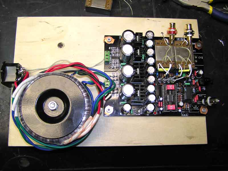

I just attached this 1:0.62 transformers, completely bypassing the output filters:
[/url]
This is amazing, a very big step. I am surprized, give me some time for an opinion...
Even when I have to turn my amplifier now a little louder, the output level is still high enough. And I drive very short cables, 1ft.
Franz

With this setup, I clearly prefer the upsampling version!

Congratulation ! You have done what i considered the best for this dac. With this setup you forget op amps, fets, tubes and everything.
This is what i'v done and it ended all the circuits I tried to get better and better sound.

If buying from scratch what would be the best value of input transformers to use on the outputs? 1:1? I'm very keen also on by-passing op-amps altogether and having to forget having to desolder all those components with the hard to melt ROHS solder!

Hi guys. Could anyone tell me where to get some of those output transformers Franz Gysi has used on his output stage please? or any similar will be appreciated.
This trannies, you will hardly find some. Look for used Studer equipment...
I work with Studer and I found them in the garbage box, really!
But you will find suitable transformers from Lundahl or Sowther or other manufacturer. Look for 1:1 versions.
And be aware: this is not a good solution to drive long cables to the preamp!
Franz
Lee
I am not an expert in trannies, I just had good luck :)
The trannie should not have to low impedance. 1k or greater is O.K. for the CS4398.
And it should be 1:1
Everything usable as line driver or input-trannie with above specs is suitable.
