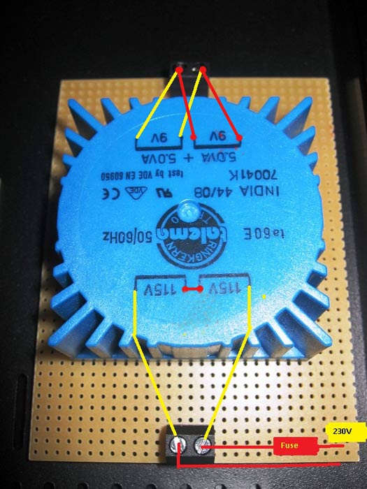

Well here are some Pics:
In the first picture i used paint to show the connections, are they right ?
Im not sure with the 230V connetion, maybe you have to connect the end and the beginning from the 115 parts, where i made the red cross. 😕
Yes you will have to connect the end of one 115v to the beginning of the other 115v winding.
You can use just one 9v out or if you need more power connect them in parallel..
