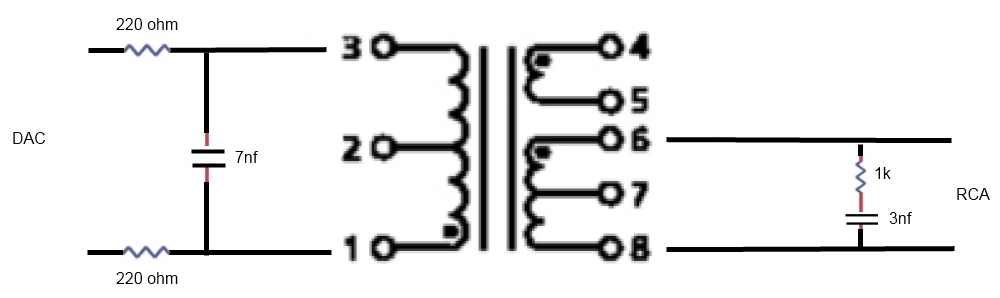

He states how he has connected them:
Here is a picture of my monacor implementation.
Input from DAC (before capacitors at L+/-, R+/-) through series resistors of 220 Ohm to connection 1 and 3.
In between 1 and 3 a capacitor of about 7 nF. (4,7 + 1,8 in my case).
From 6 and 8 to the output with a resistor of 1k and cap of 3nF between 6 and 8
The 7nf cap he has across 1 & 3 after the 220 ohm resistors on the primary, and the 1k and 3nf cap in series across 6 & 8 on the secondary.

Yes, I only got one Monacor for testing purposes only, of course you need two of those...
As for the filter I started with Jensen filter, not that exact values but pretty close, capacitors were the same value, the resistors were 250R and 1k...
Although, you can start with no filter, just resistors in series on DAC output and see how it sounds... Worked pretty good with my Monacor, but the sound was better with the filter, highs settled a bit...
As far as i know it's important to put the secondary filter to filter out HF noise because some people had problems with amplifiers oscillating because of that...

here you go, I have just used the values in that discription - I think by that diagram 1 goes to 6 and 3 to 8, so if you connect 1 to the dac's R+(positive) 6 goes to the positive on the RCA and like wise the 3 is connected to the R- (negative) output leg of the dac and 8 to the negative of the RCA.
