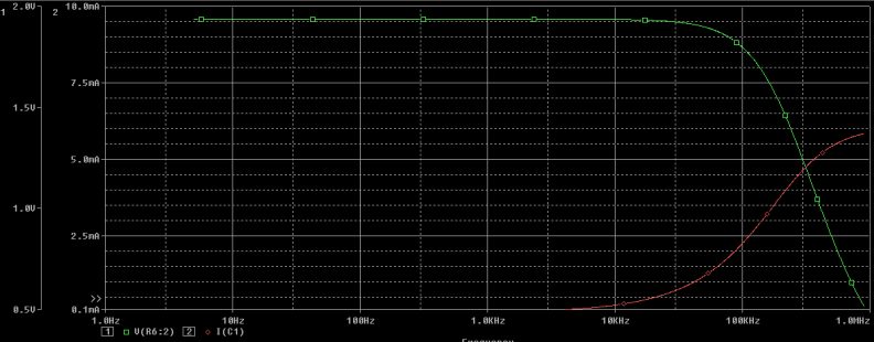

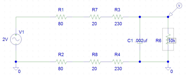

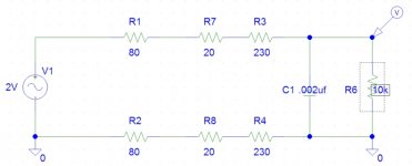

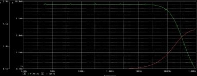

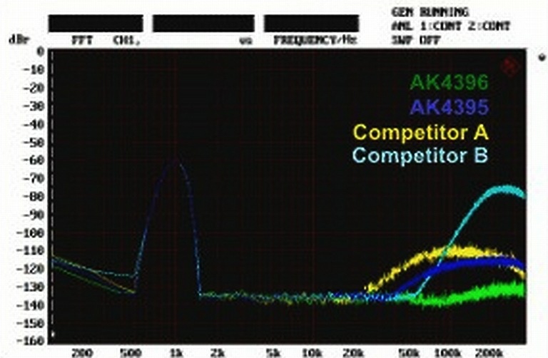

I looked at the simulations again and there is a loading issue with using a filter with minimal series resistance. Even with 900R resistors in series with each leg, the filter cap will be shunting 2ma above cut off with a 2v peak to peak noise signal. With 250R and .01uf the load is 6ma above 100KHz. Is the level of noise that high? Probably not but it might be half of the full scale output level with the CS (or PCM) chips. Does adding an un buffered passive filter with low series resistance increase distortion in the audio band due to ultrasonic loading?
250R, .002uf filter
250R per leg with a .002uf shunt is a good compromise but doesn't really accomplish much, the -6db point is not until 440KHz. So, not really filtering much of an amps problem area anyway but still loads the dac to 1/3 the peak current level through the cap, whatever that may be, at 90KHz. Back to my original plan. Just leave the filter out.
