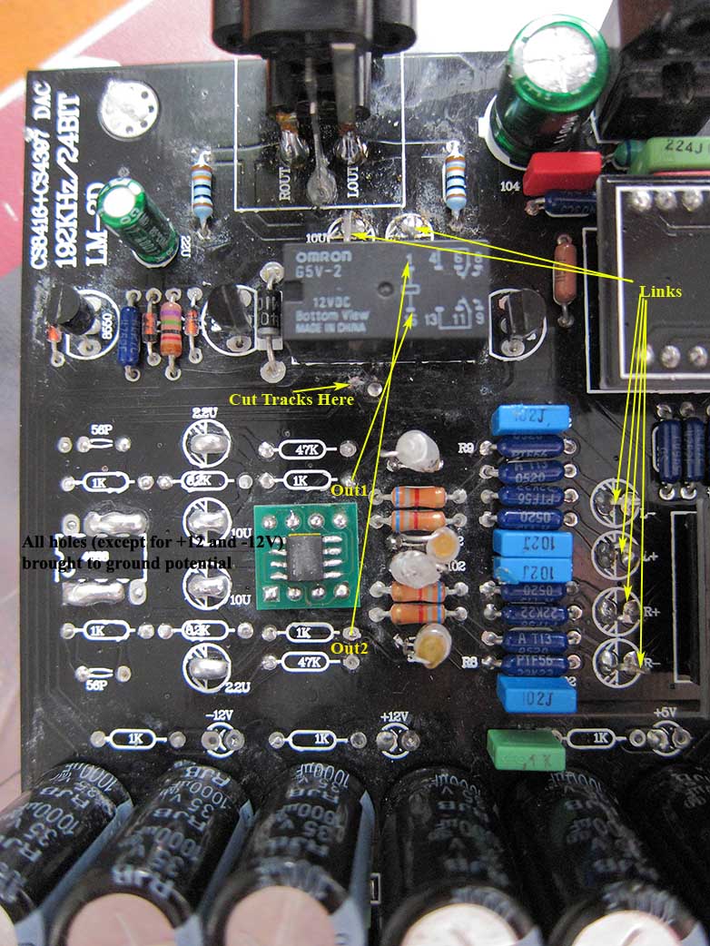

OK, so for those wishing to implement the 'Op-Amp' mod - using an LM4562, these are the steps involved (please jump in anyone if there's any obvious mistakes!) :
1) Remove both NE5532s. Insert one (only) LM4562 in the first op-amp socket - the one nearest the center of the board.
2) Remove the following 4 capacitors: L+ / L- / R+ / R-. Replace with wire links.
3) Replace R14, and R17 (both 22k) with 36k.
4) Run a wire directly from the output pins (1 and 7) of the LM4562s to the phono sockets (via the output rely if you prefer this added safety measure).

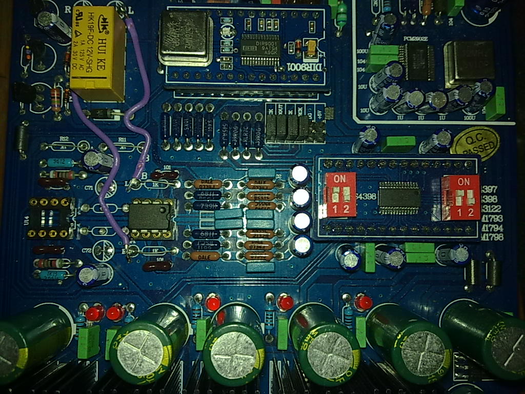

Hey guys! I made this mod, but i didnt found R14 and R17 on board! Can somebody help me? After removing L+ / L- / R+ / R- capacitors i hear a very big distortion! (at the attached picture not shown, but i shorted 4 capacitors links)

Check the photo.... You have links in place of 1 k resistors which is most likely the reason for distortion.
Remove all parts that are not needed and bring ALL the tracks to ground potential
Feed the signals from Out1 and Out2 to relay pins 13 and 4 respectively.
NOTE: my arrows point to the relay coils - that is a mistake!!!
Cut the tracks around pins 13 and 4. The remaining coper should be brought to ground potential
What I haven't shown is the wires underneath connecting Out1 and Out2 to relay pins 13 and 4... various IC’s will require careful routing and / or series resistors…
DC level at the output is less than 4 mV with good IC....
For the proper symmetry (high frequency attenuation on both halves of balanced signals coming from the DAC), the capacitors should be matched as per my photo; 4 X 1nF and 4 X 100 - 200pF (choose the value between 100 to 200pF…. that suits your taste and your system. I use 4 X 150pF). Use FKP2 if possible. The cost of this DAC (with mods shown) is around $130 and that’s with the mains transformer included in price – truly unbelievable… the mods shown will give you very good sound.
Installed in nice box (another $100), this DAC with the mod shown will easily match $1000 - $1500 commercial DAC's...
Boky

coupling caps
Does it sound ok with caps back in instead of links at L+ / L-/ R+ / R-? How much dc is on the RCAs?

Yes, if i remove links, all works ok. DC in both situations is about 10mV. I think, electrolythic capacitors in signal line is not very good for sound, maybe just replace them with film caps?Does it sound ok with caps back in instead of links at L+ / L-/ R+ / R-? How much dc is on the RCAs?
Yes, after removing links it sounds OK. DC in both situations is about 10 mV. Maybe just replace caps with film caps? (i think electrolythic caps in signal path is not the best thing)
I've spent some time trying to get absolute best from this DAC for bare minimum spent in parts; I found interesting thing while minimising noise on Vcc / Vss pins....the only DAC chip that will give some reasonable results is in fact 4397 - all other plug in modules are seriously compromised...
