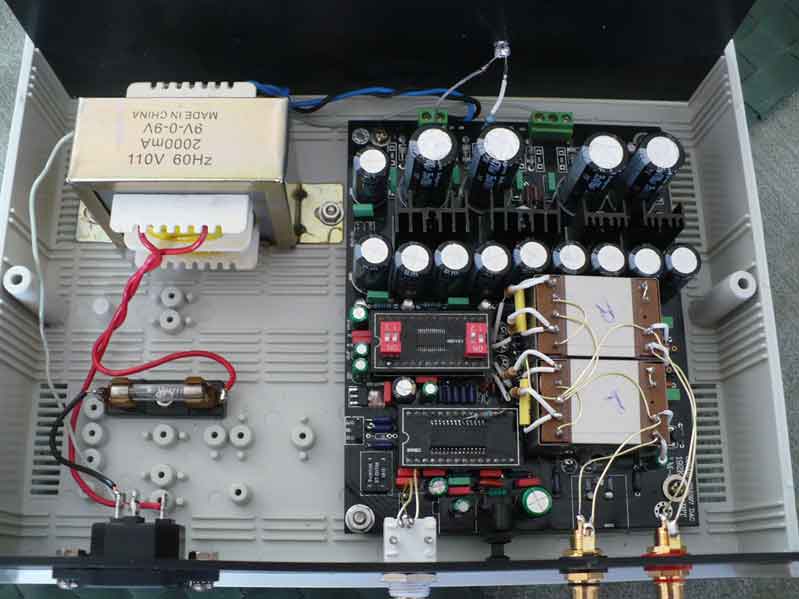

Layout
For those who wants to do simple things, here is one of the dacs I modified with Lundahl LL1690
There's no wires between the dac and transformers.
The transformers were simply glued with hot glue on the board.
I also have the new dac with upsampling and I have to decide if I like upsampling better or not.
I'm really happy that everyone seems to love this transformer topology. I still think that this the best way to go.
