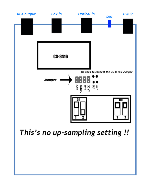

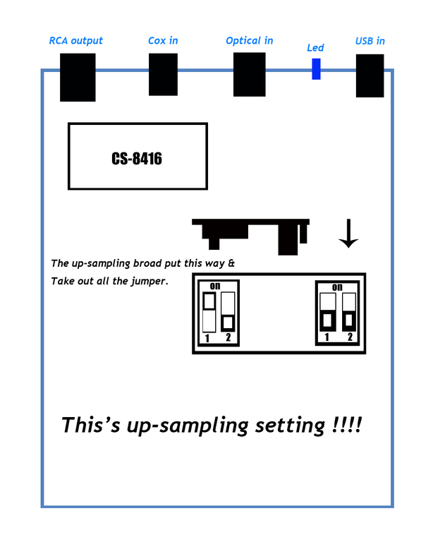

I bought the new version from ebay seller gigawork smooth transaction and delivered in under a week.With the new revision dac I also received a cdrom with some settings info which I'll attach if I can figure it out
