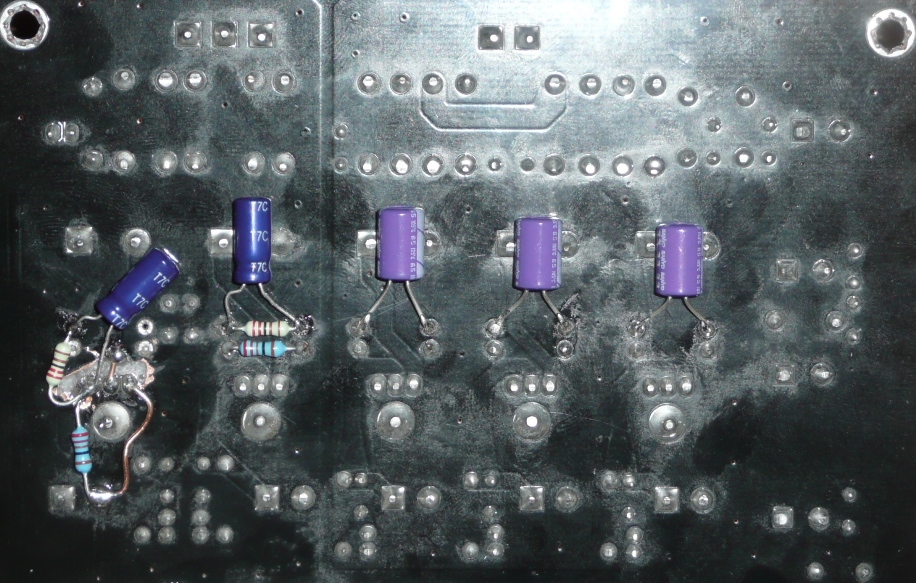

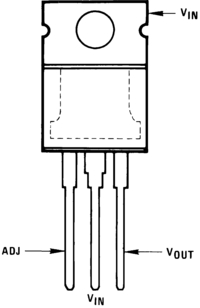

Error in LM337 routing
For those of you using this DAC with opamp output i have to say that i found an error in my board with the LM337 routing; ADJ, Vin and Vout was routed in a wrong way.
The attached images show the modified (and corrected) board and the pinout of LM337.
I also desoldered the two trimmers and two resistors (one R and one trim for LM317 and one R and one trim for LM337 rispectively), used to set the +/- Vanalog for the opamp, from top and soldered on bottom (using fixed R in place of variable).
Another mod visible in the photo are the capacitors soldered in parallel with the resitor going from ADJ pin to ground to improve ripple rejection as stated on the LM317/LM337 datasheet.
Other important hints for using the DAC with opamp are in posts #212, #229, #233, #241, #258 and nearby posts. The argument of this posts is the optimal values for the LPF opamp, simulations and measurements for the original (not so good) and proposed (way better) values.
