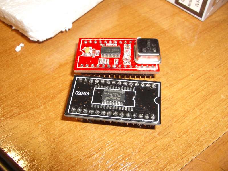

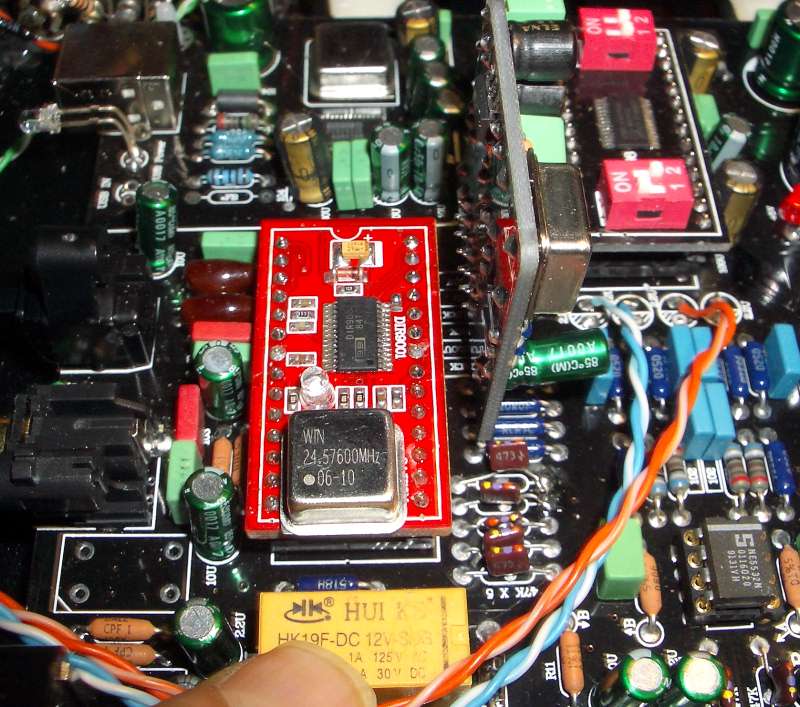

To all,
This DAC comes in two version, with upsampling board 8421 and without upsampling board - closed jumper.
Can anyone explain differences in sound between these two version ?
Mine is w/o upsampling board. The ebay seller offer me the 8241 board for USD35 and the new version with PCM1798 chip for USD45.
Please let me know if this is could be consider a worthwhile upgrade.....???

After some debate I ended up using mine without upsampling board. Some would probably disagree with that.
For my needs the stripped down version(no USB, no upsampling and even no toslink) is fine.
The PCM1798 board looks interesting but I believe(correct me if I'm wrong) that it will not work well with 1:1 output trafos - if that's what you're using.
I think the PCM1798 chip is generally more natural sounding than the CS4398 and I've noticed a few manufacturers are using it in their high end DACs. Personally I would have given it a try but, for now, I don't want to have to buy new trafos and parts again.
