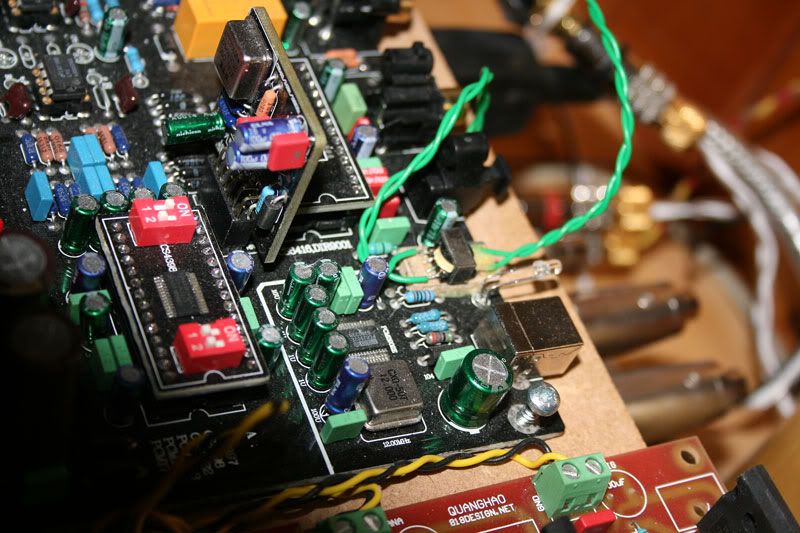

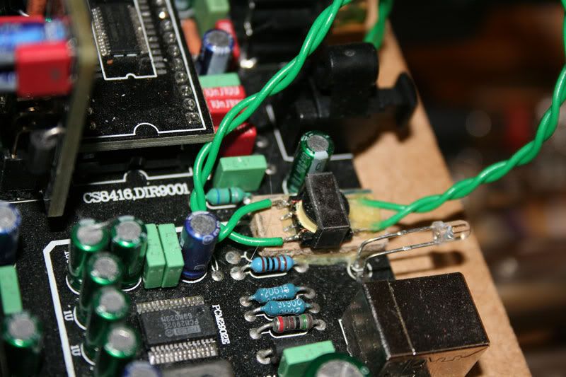

Ok,here are some pics:
The other side of the trafo is connected to an RCA input jack (you could use RCA on the PCB,but you have to desolder the capcistor that is there originaly) that is connected to the source,(The CD or DVD player ).
The CS8416 is connected on the underside of pcb,with a twisted cable to the trafo.
Anyone can see what brand the trafo is?I have forgotten..
