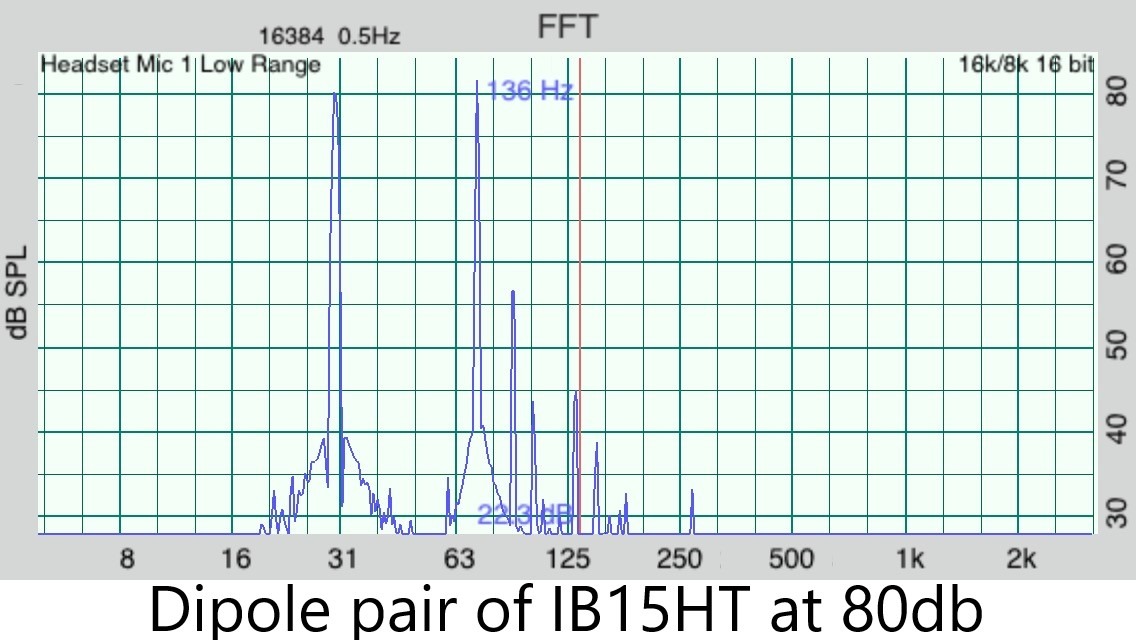

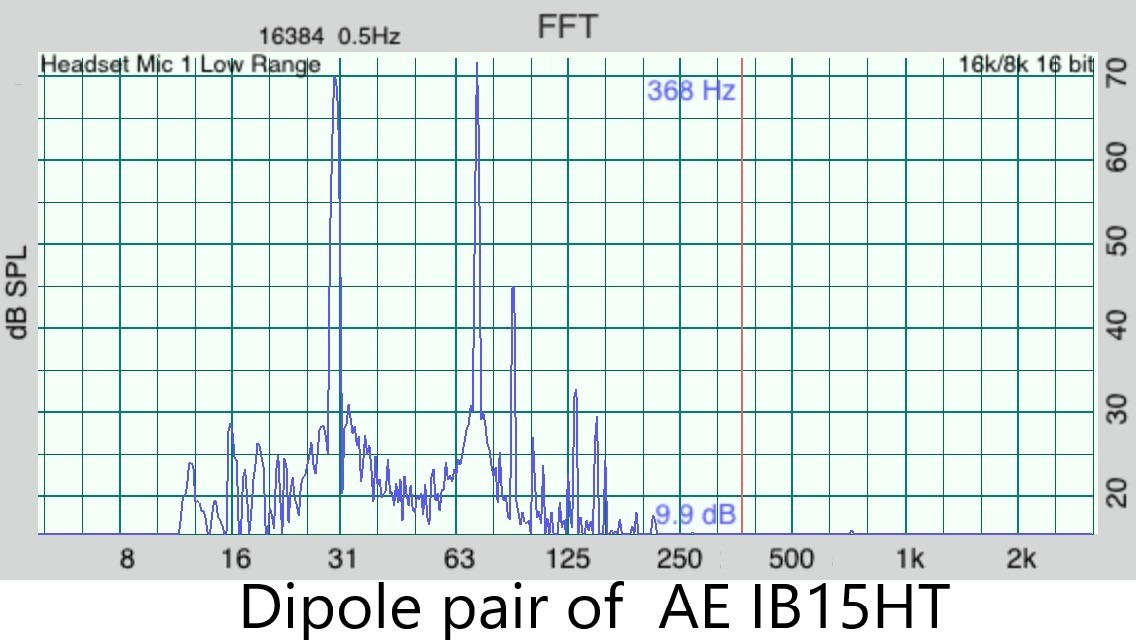

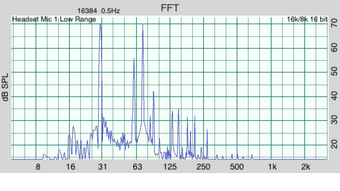

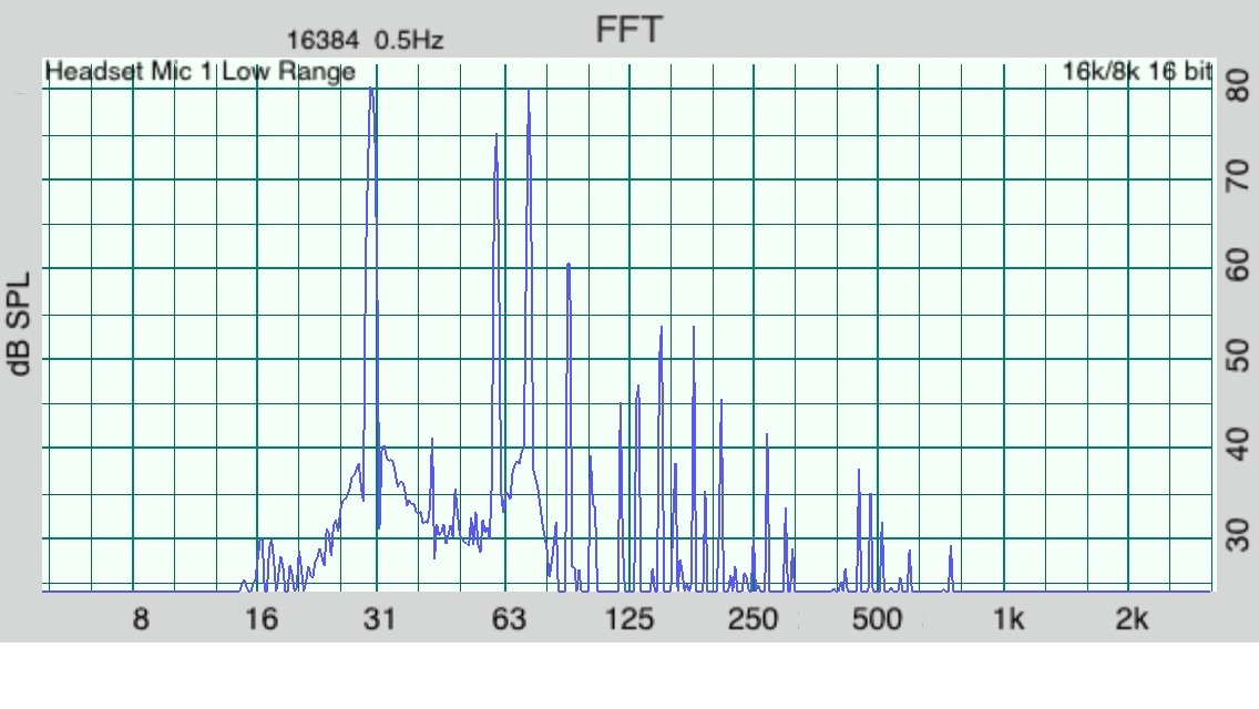

I don't have experience with the LO12 but I have used the AE IB15HT in dipole and the AE SBP12a in a sealed box. To give an idea of the demands of a dipole system 2 15" woofers about equal a single monopole 12". Attached is the 30 and 72hz IMD test of a pair of AE IB15HT woofers compared to a single AE SBP12a in a 85 liter sealed box. I have used the trick that Steinway uses to reduce even order distortion and one of the 15" drivers is reversed mounted with polarity flipped. You see in the graph that the 2nd harmonic distortion of 30hz(60hz) is almost lost in the noise for the dipole. The IMD3 at 132hz is about the same about -35db in all test. I'm not sure about using an underhung topology in a dipole, Mr. Linkwitz dismissed it many years ago: https://www.diyaudio.com/community/...st-bass-i-have-ever-heard.163914/post-2209229

Forgive my ignorance, why does this reduce even order distortions ?I have used the trick that Steinway uses to reduce even order distortion and one of the 15" drivers is reversed mounted with polarity flipped

Studley, good question. Asymetric nonlinearity, such as having more motor force when going out versus going in is one of the causes or even order distortion. If you flip one driver and reverse the polarity, one driver is moving in while the other is moving out. Any asymmetries can therefore be cancelled to a certain degree. This causes causes a reduction of even order distortion.
OK thanks for that. Has this type of asymmetric behaviour been measured in many drivers and is it considered to be a significant source of distortion? I use the word significant in the sense of worthy of addressing.
