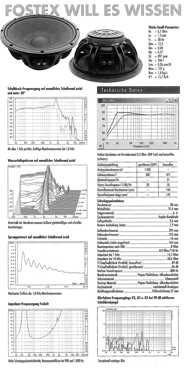

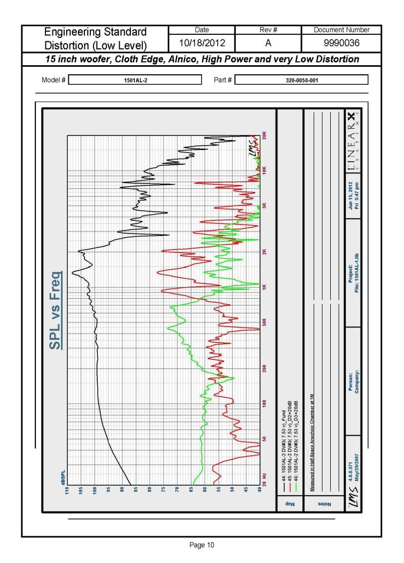

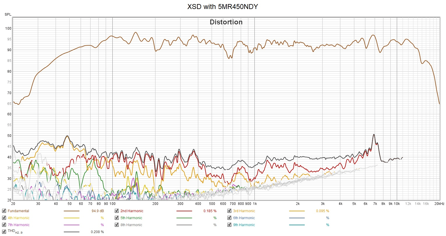

This is not unique to Purifi, and already at 95db the measurements in the bottom end start rising as normal.What I find interesting about the HD levels is that they do not climb below 100Hz like most drivers. Instead they stay relatively flat down to IIRC 30Hz or so. This might due to the Purifi surround design, which helps to keep Sd constant as the cone undergoes greater amounts of excursion. For a driver with a normal half-roll surround, Sd modulation is causing some distortion to occur.
Just as with any other woofer.
You will find the same behavior in some other well designed woofers, i don't know of any other 10's though.
Linked a few 15" examples below.
All 3 drivers have different surrounding designs, soft parts, cone materials, and very different motor structures / tech.
So the Purifi surround is not the likely decisive solution.
Measurement microphones have a lot of noise, esp 1/4" ones. So THD at lower levels is probably masked from that. But as you raise level you are able to do proper measurements again.@CharlieLaub: In Troy’s recent video about his design study for a bass cab using 2 x 10” Purifi woofers (drool) he mentions that Lars told him that the distortion levels of their 10” woofer is so low that their test equipment can’t measure it. If you read this Lars perhaps you’ll tell us more ?
Our Purifi surround is only part of the solution. The rest cones from the innovations in the motor design and suspension. Measurements: distortion at this low level is definitely measurable but but challenging since the noise floor of the mics are close. We measure at 40cm distance rather than 1m which increases the SNR.
