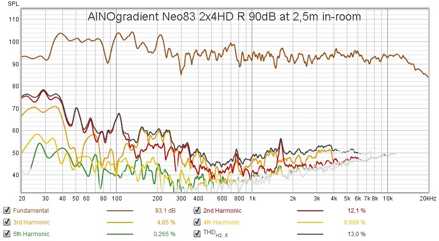

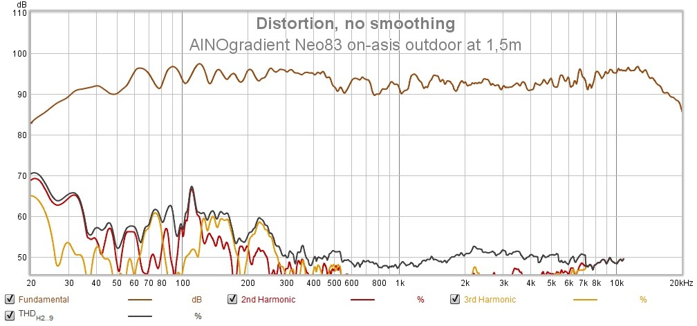

Kaamelis's measurement is not nearfield, but obiously at some distance. To get high enough spl (and excursion) to show relevant distortion behaviour above noise floor of the environment, also introduces vibrations in the stand of the speaker and room (if done in-room)
I have done manymany indoor and outdoor measurements of drivers and speakers with microphone, so I have become very cautious about a single result, I mean making conclusions and deductions on it.
Also, the quest for the best or perfect bass driver for dipole, will be very difficult, one should decide what parameters to use, but not at the expence of all the others. High Sd and high number of drivers always helps, I suppose. I haven't tested compound systems at all, I am very happy with a single nude 12" pro driver highpassed around 150Hz LR2. Below that a sealed box woofer (in each speaker) gives the thump that I like and all the spl I can use in my living room.
This measurement outdoors at roughly 1,5m
And this same speaker indoors at roughly 2,5m (a bit different eq settings)

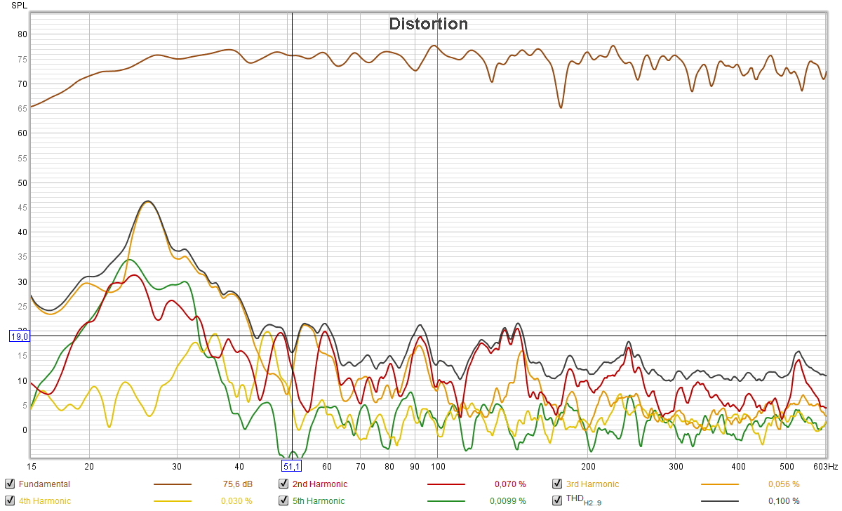

Nearfield measurements are not that helpful for dynamic range and/or distortion measurements for woofers. Mainly because it overloads the mic. Suppose you’re expecting a woofer to hit 90dB @ 1m, which is not unreasonable. At 1cm that’s 130dB well beyond the capabilities of most electret condenser mics that hobbyists use.Have you looked at the HiFiCompass nearfield HD measurements?

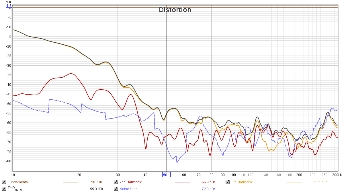

Recently I did some nearfield measurements at 1cm, then double the distance gradually eg. 2cm, 4cm, 8cm, 16cm until 1D, 2D, 3D; D representing the diameter of the woofer, as well as 1m and then 2m ground plane measurements. all with the same woofer, in 1 cu ft cabinet heavily filled with fibreglass wool.
I found that measuring in the nearfield was excellent for determining the anechoic frequency response up to about 1Khz (exact figure depends on size of cone diameter). BUT, I did easily overdrive mic and forgot that I was sending a full 2.83V!
So a 85dB/2.83V@1m woofer; the mic is trying to
anywhere above 1-2W eg. 2.83V or 4V and the mic is supposed to read 125dB at 1cm. Well, compression sets in and the mic didn’t like that; showing up high levels of H2 distortion.
Without an anechoic chamber ) or Klippel Near Field Scanner) I’ve found that the best way measuring large woofers is at a distance like 1m. If you have a small room eg. 10m^2; or a room with lots of background noise, then you may need to move the mic closer eg. 50cm (+6dB) or 31.6cm (+10dB). But if room is and large then (eg. 30dB(C) then measuring at 2m or more on the ground plane is better.

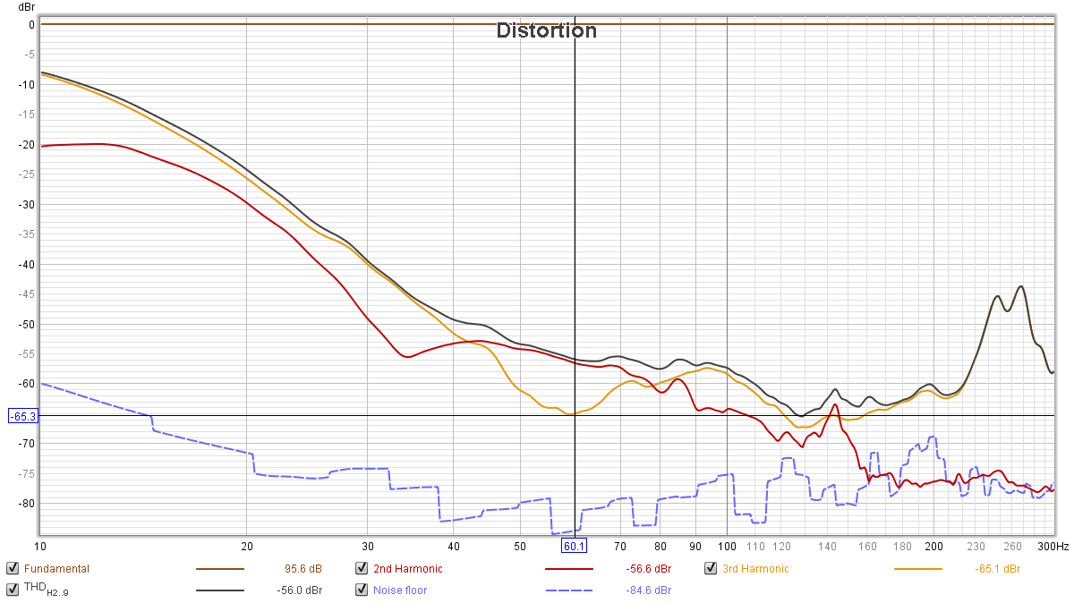

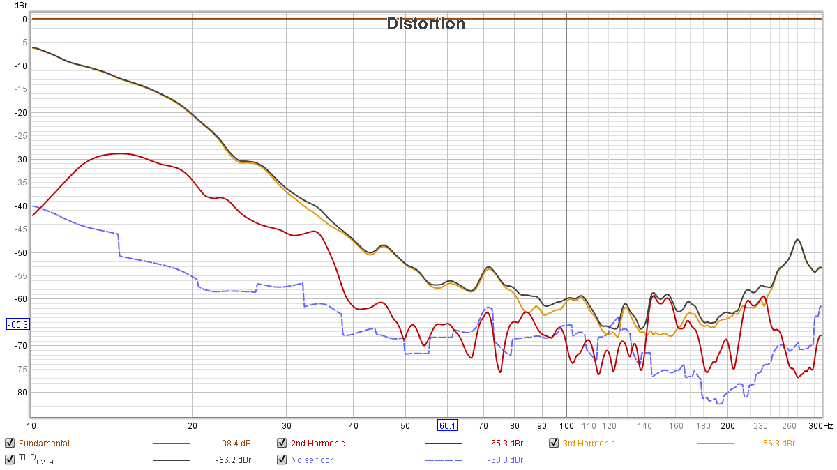

No, HiFiCompass nearfield measurements of drivers alone are correct. But if drivers are installed in OB frame and target is to measure asymmetries cancellation caused by one driver flipp, then very driver cone close nearfield measurements cannot gve reasonable result.Ah, sorry for any confusion. I was directing my remark to the OP, not to you. But I am curious now since you believe the HiFiCompass nearfield measurements to either have been done incorrectly, or in any case done in such a way that the results are not useful?
I made better measurements to take clear asymmetries cancellation caused by one driver flip.
Both are made at same voltage level on drivers, room correction EQ and filter is turned off, +6db/octave compensation down from 100 Hz remains on.
Fist is single driver working, neafield 1 cm from cone center.
Second is 60 cm from drives installation plane, on same distance from both drivers center, one driver is flipped.
Mic amp gain is changed to keep maximum signal close to full scale 0 dB, both are 8 times repeated measurements.
Nearly 10 db of 2nd harmonic improvement can be seen on some frequencies. But general THD is same, where 2nd harmonic is decreased, there 3nd harmonic is increased.
