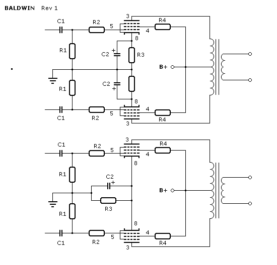

I would guess that in the first set of measurements, pin 5 measured 0.24V instead of 24V, it is easy to misread a DMM, the numbers look the same. The grid (pin 5) would likely be very close to ground in a self-bias amp. That gives a bias voltage of 33V for the 6P3S and 28V for the 6P3S-E. Ahhh, possibly gassy tube, is that what you mean Anatoly? 24V on the grid?
I attached a schem, which shows two possible variations for the output section of your amp (for one channel). The upper one shows individual cathode resistors and cap for each output tube (R3 and C2). The lower one shows a shared cathode resistor and bias cap (R3 and C2). Perhaps you can trace the circuit and see which variation you have, and fill in the values of R1 to R4 and C1 and C2. That will give you the output schematic of your amp, which is a good start. If the value of R3 is known, it is easy to calculate the power dissipation of the tube at quiescent conditions (idle). One quick check to see if you have the upper or lower schematic is to check the resistance between pin 8 of each tube in the same channel, if it is around 1 ohm or so, then the lower schematic would correspond to your amp.
If you can measure the cathode resistor/s (R3), you can calculate the power dissipation of the output tubes very easily. For example, if your amp is like the upper schematic, and R3 is 470 ohms, and your 6P3S-E measure 28.4V at pin 8 (cathode), then V = IR, 28.4 = I x 470, I = 0.060 amps = 60mA. The power dissipated by the output tube would be voltage across the tube x current through the tube = (390 - 28.4) x 0.060 amps = 21.7 watts.

270K?! Shouldn't that be more like 200-300 ohms? And if you remember, the seam of the plates WERE glowing red.
No, it should not be like 200-300 Ohm, it should be 1000 times more. However, as soon as some your tubes are gassy you may try to solder in parallel with that resistors some 100 kiloohm additionally.

Speaking of 270 kiloohm, you can see it on your picture. Resistors from control grids to ground have strips: red, violet, yellow. That means 2, 7, 4. I.e. 27*10^4 Ohm.
I was under the assumption that the control grid resistors were those large green ones bolted to the chassis. The only two 270K ohm resistors I see are on those small solder strips next to the rectifier sockets. They also have a couple of 3.9K ohm resistors with them, but it looks like they go to the driver sockets.

You probably measure wrong pins. Pin 8 is cathode, where that big green resistors are soldered to. They should be in hundred of ohm range.
No, I didn't "probably" measure the wrong pins. I measured the cathode resistors for a reason, to find out the size of them. And yes, they are in the hundreds, 244 and 199 ohms. I just made a typo last night from being tired and all that talk about Kohms, not to mention I got mixed up with cathode bias resistors and control grid resistors.
It looks to me like there is a shared cathode resistor for each output pair of tubes, like in the lower of the 2 schematics in post 63. The 2 green power resistors close to the rectifiers could be part of CLC power supply filters, and the other 2 green power resistors are the cathode reistors for the output tubes.
Those 2 green cathode resistors should be the same value, and there should be a capacitor wired in parallel to each resistor. Are those caps old ones? Also it can be difficult to measure a resistor when a cap is in parallel, usually the DMM will wander and then settle on a final value.
It does seem the amp is definitely biased on the hot side, even with 33V on the grid and a 244 ohm common cathode resistor, you have around 24W dissipation, the info I have for 6P3S is 20.5W for the plate and 2.75W for the screen.
Being that the value for each pair of output tubes is identical, I also assumed that each pair shares a single resistor. I believe the caps for those resistors are the two brand new 47uF - 160v caps that I installed as they replace part of the old original three section can caps that died. And the DMM did take a few seconds to settle down on a final value.
