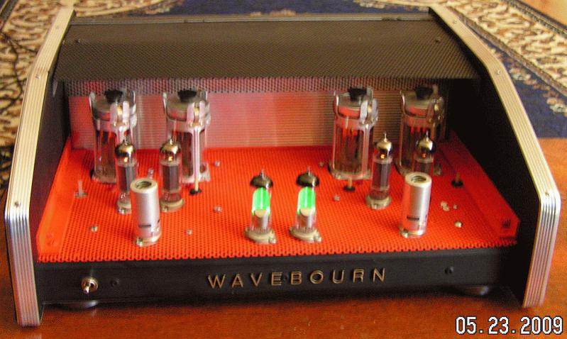

Here is my 6П3С-Е prototype:
Interesting arrangemet.
You have all connectors, switches and pots at the same side.
Can you tell how did you come into such design and what is the main purpose of the use ?
Some words about the construction of the output stage would be interesting.

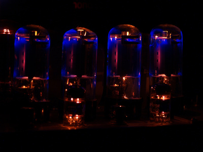

This one was a 30 second exposure at ISO100...
I couldn't help but notice the tinge of color along the plate seam on all four power tubes. I'm not referring to the blue, it's the pinkish-red that has me curious. Can you really see that with the eye in a darkened room, or is that just the digital camera being extra sensitive to IR?
I have some old Russian 6550 tubes that also show signs of plate color, even well below their dissipation ratings. The odd thing is that the coloration only appears along one side of one of the plate seams. Both tubes in this amp are doing it, but one tube is rotated 180 degrees so the color is on the opposite side. And yes, you can clearly see it with your eyes.
http://i69.photobucket.com/albums/i43/Ty_Bower/Simple SE/P1130044.jpg
Hi Ty, it's a time exposure photo so it just exaggerates the light intensity depending on how long the exposure was. If it was IR, the camera would have to convert its frequency range up to the visible spectrum before we could ever see it. That's how night vision devices work.
This exposure was a bit longer than that required by our eyes requirements in that same light level. It's really difficult to get it exactly the same as our eyes see without a lot of trial/error exposure timings and ISO settings.
But for tube shots the extra intensity of a longer exposure is nicer looking than reality anyway.

I did not have all connectors on the same side. Power socket and 8, 16 Ohm sockets are on the rear panel. They are flat, so well protected when the amp is laid on it's back. The amp was designed for double usage: for high quality PA and for home stereo. For PA ins/outs are better on rear panels, controls on front panel. For home stereo it is fashionable to have connections on front.
How did I come to this construction? I don't know; probably, the main reason was ergonomics that we learned in university. I tried to make the simplest and optimized construction. Convection path designed such a way so hot air from tubes going up creates forced flow through transformer compartment, that sucks an air from under chassis.
Output stages use 4K P-P transformers. Tubes are paralleled, so each 6L6 sees 8K P-P load line, for lower distortions. Also, screen grids are powered from low stabilized voltage supply, that additionally decreases distortions in output stage. Phase splitter is combined Concertina and LTP. All 3 driver stages are direct connected and use triodes (6N2P input/concertina, 6N6P LTP).
The project was called Pyramid. I found it too complex, and next class AB tube amps were called Pyramid-V and Pyramid-VII; they had improved design, and military tubes GU-50 in output stages. Input/Concertina use 6F12P, LTP uses 6N6P tubes in Pyramid-V. In Pyramid 7 I used 6F12P input, 2 x 6P15P LTP driver. Pyramid-V-M and Pyramid - VII had parallel feedback by voltage in output stages. There are other projects, Pyramid-8 and Pyramid-VII-M, but they are not finished yet.

Nope, the seams on all four of the tubes glow like that. Not quite that bright, but plenty bright enough to see with the naked eye.
Yes, I see it now in your first daylight photo. I wonder how long the tubes will last like that? I also wonder exactly what it was the Russian assembly workers did "wrong" to make them act that way? I've confirmed with several others that some versions of the 6550 do it, but this is the first I've noticed in the 6p3s.
Many older digital cameras were sensitive in the IR region. My older Sony DSC-F828 makes a good glowing tube detector. I can turn up the juice on some tubes until they glow and then back off until there is no visible glow in a totally dark room. Take pictures with the old Sony and the new Canon. Glow is visible in the picures taken with the Sony, but not with the Canon. If I back the dissipation off about 2 more watts on a big sweep tube there is no glow visible in either picture.
I would expect that running these tubes this close to the glow region will shorten their lives.
That pic was taken with my iPhone too and I never even noticed that glow!

The blue glow of the tubes is not as much of a concern as the thing that really concerns me is the one seam on all four tubes glowing an orange-red. This is why I ordered the new tubes. They are supposed to be much better built and can handle higher voltages.
Also, concerning the blue glow and the seams glowing, I tested the tubes on my B&K solid state tester and all four tubes are perfectly fine. No gases, leaks, shorts or anything. I also have a really nice HP desktop DMM that I would love to probe around with under the hood of the Baldwin amp, but not knowing what to probe, I don't dare do it. I would really like to know what the voltages and bias is at on this thing, but like I said, I'm not going to just go in there and start probing around. 🙁
