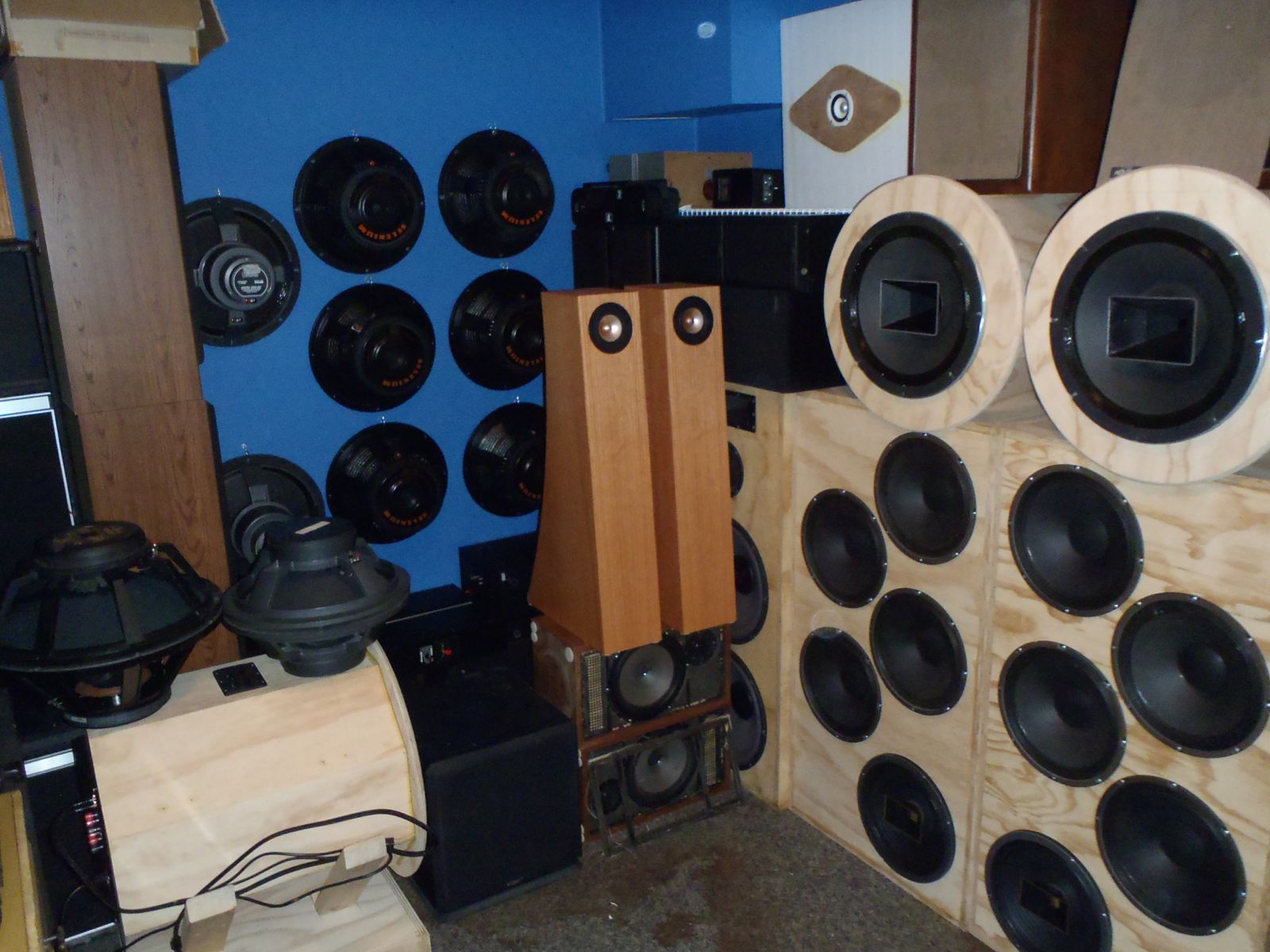

Are the woofers on the wall an IB setup?
These poor little frugelhorns look intimidated in there 😀
Yes X.
I'll show this to my wife so as not to get so many complaints as I do now... and I only have a couple BIBs and two small and flat Nagaokas for the FE108ESigma...
I'm drooling for that Altec horns...

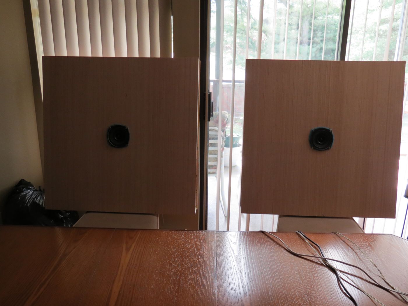

The drivers arrived today 🙂 At the moment i'm busy painting the front. Just a quick question, should i use stuffing? or first see how it goes without? i guess putting it in after the front is glued on will be next to impossible because of the small channels an cutout..
You can put the channel stuffing in a small mesh bag (pantyhose stocking material) and use a pull string to adjust/remove. The driver chamber definitely needs stuffing. You can pull stuff out with a wire hook through driver chamber to a certain extent. If you used foam core back panel, surgery to remove a small window in channel can be used to remove or add stuffing and glued over later.
