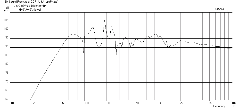

X, if it's not to much trouble.. could i bother you for 2 sims? I decided on building my third (and probably final) pair and Cal convinced me, they're going to be big. 😀
A while back you did a sim for me of the Fostex FE166En in a 40inch cornu, which looked really good. But i was hoping to get away with 36inch, could you do a sim of that? i'm guessing 5inch dept like Cal has for his 36" cornus. And the other option i was looking at was the Mark Audio Alpair 10.3.
Alpair 10 Gen.3

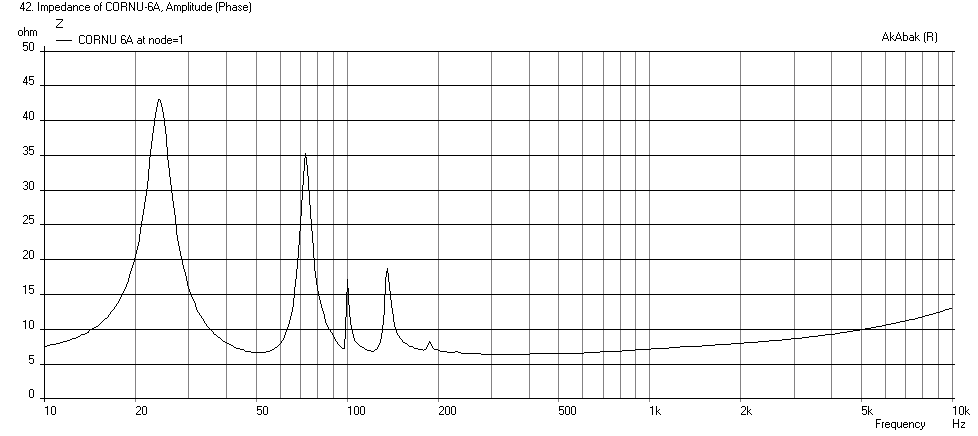

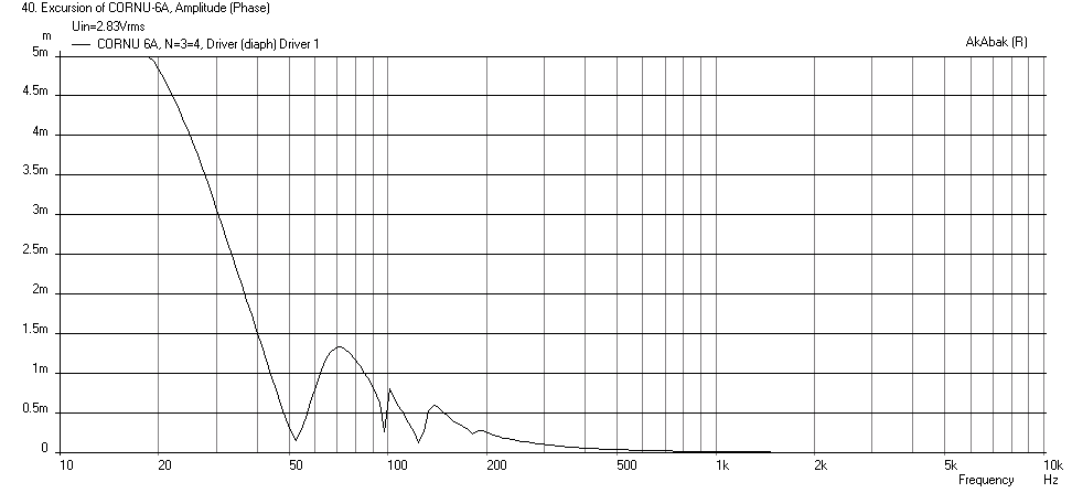

Here you go... looks like it will work well in 36 in x 5 in deep.
Thank you so much! that's the fostex right? or the alpair? 🙂 if it's the fostex, i remember the 40 inch one 🙂eek🙂 looked better
> The FE166EN is a 6.5 in class driver and will not physically fit in the driver chamber unless you scaled up to a 40 in x 6 in deep Cornu. The Freq response looks very good and it will go all the way to high 40 Hz.

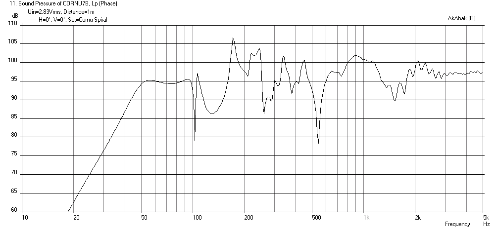

Ah gr8 😀 dont suppose you still have that FE166 sim you did with the 40 inch and can see what it looks like in 36 inch?

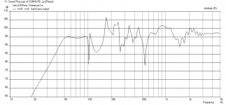

Here is the FE166EN in a 36 in x 6 in Cornu. You may have a had time getting the basket and magnet to fit in the central driver chamber. Check scaled drawing and trim chamber if needed.
I have a soft spot for orange tabbies...
Thanks you so much! you are the greatest
As far as the driver chaimber goes, if you build the horns all the way to the edge of the box the size is 17.1% (the mounting hole on the drawing was 14.3%) So it should fit with a few mm to spare on each side.
