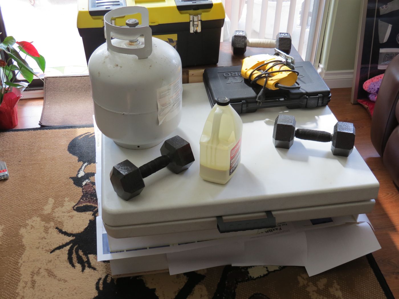

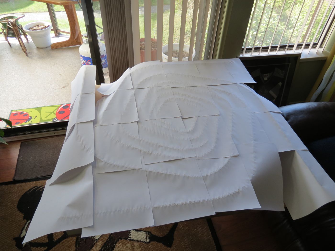

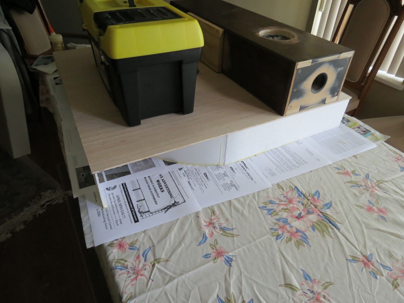

So, I'm waiting for the glue to dry a bit. This time instead of using strips of paper, I laid the glue on the foam edges and flipped it over onto full sheets that I will trim later. Left it for 15 minutes while I did the other and weighted it all down. I am hoping to glue the backs on soon.

Nice progress there Cal. I must say it appears to be going much faster on this one. You have nine square feet of baffle. Where are you going to hang them?
In "the room" with the rest of course. 🙂 Saturday I will have more to tell you guys. I am really looking forward to these. Nice thing, being so big, I have choices if the 1354's don't work out. Aw, what am I saying, these are going to be awesome...

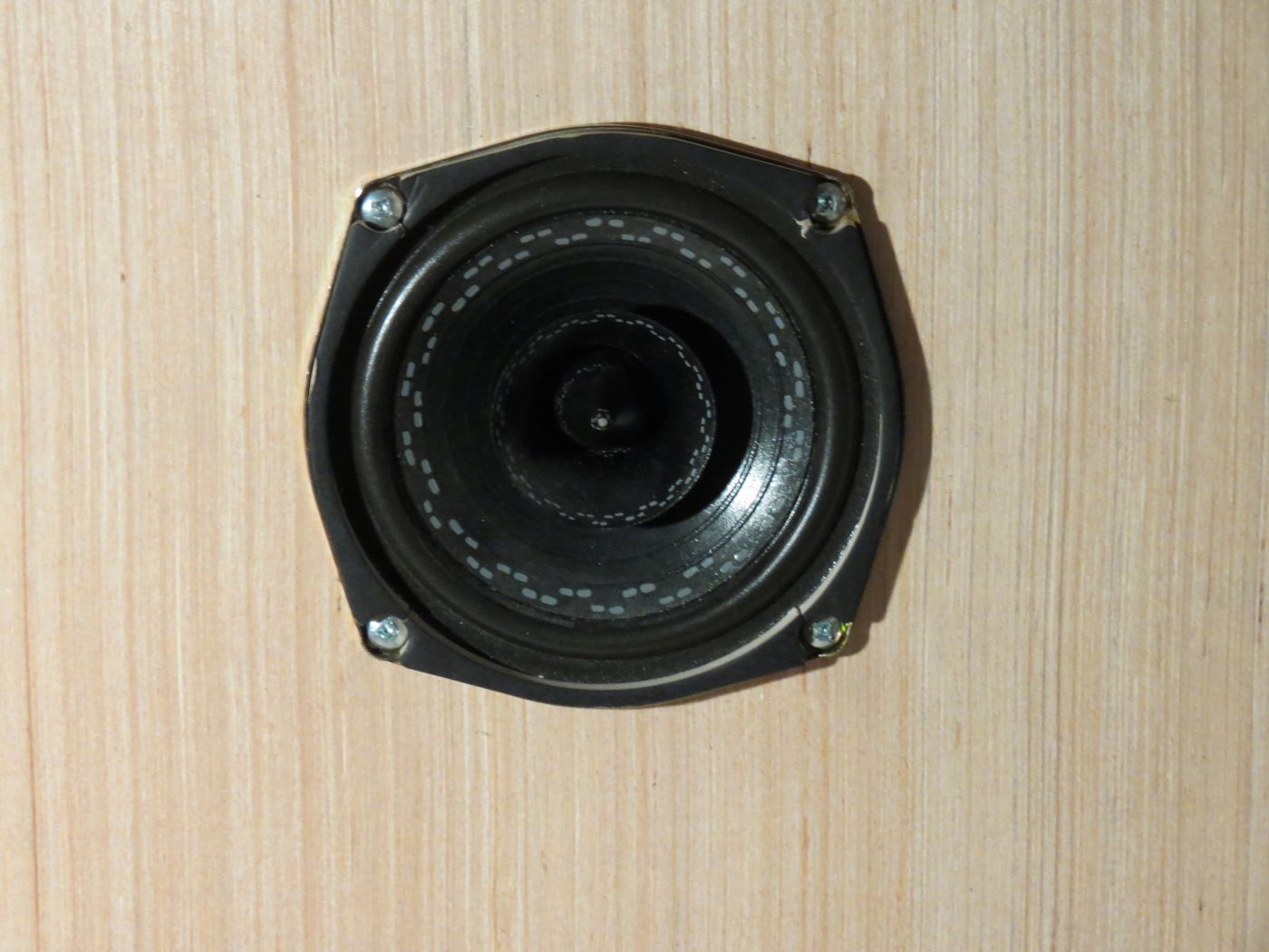

They look very nice Cal. Is that the natural wood finish that came with the ply? I thought it was the floor underpayment which normally is kind of reddish.
Thanks X. Remember, you're the reason I can do this.

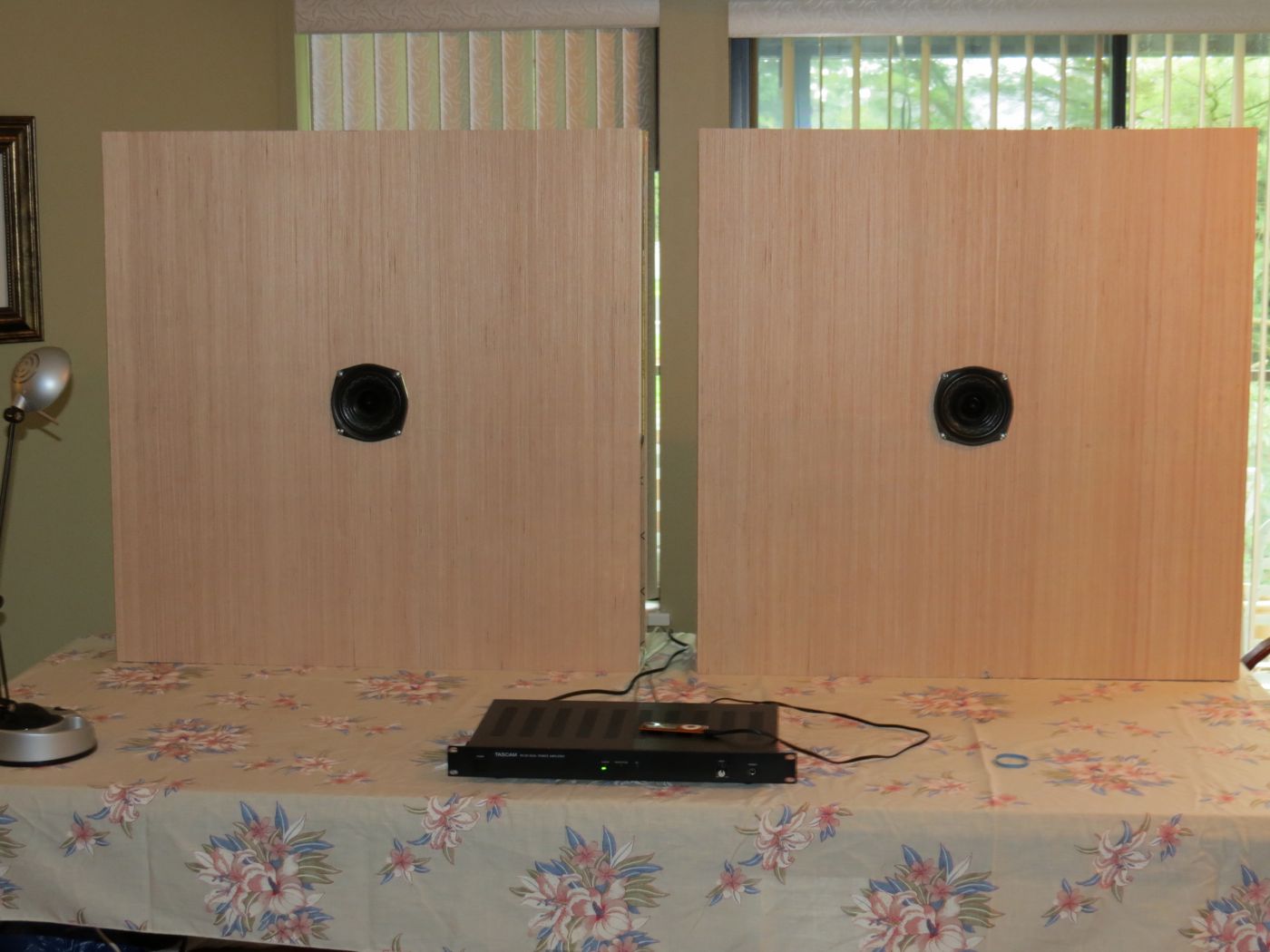

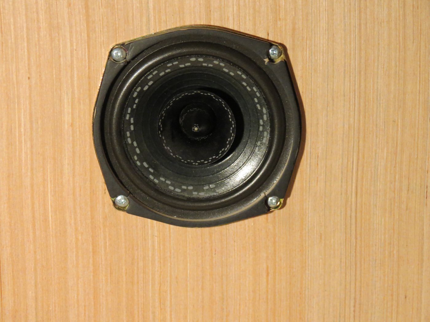

Sure-Ply at my Home Depot has changed since set 1. What you see is without finish. Here they are under natural light rather than flash. The rflection on the cone is from the halogen light on the side.

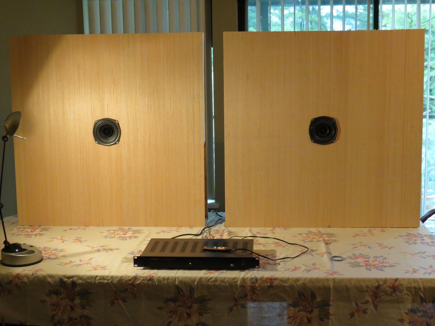

OK, got some time after tennis to do these babies. They sound fine, I'll want to play around with the stuffing a bit but not too far off first go.
Yes, they sound BIG. 🙂
You're fast. They look nice 🙂 how is the sound compared to the ff125wk cornus? Would they be good for livingroom use?
Thanks Coen,
They sound that much bigger than the 27". They fill my livingroom nicely.
Highs are a little nicer too. Bass is fairly controlled but still staggering in amount. Sounds like a couple 12" woofers from the 70's. 🙂

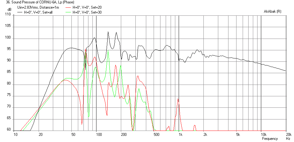

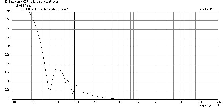

xrk, could you model the visaton BG20, or does the size of the cutout prevent it from working with your model? Wondering if it would be possible to get a f3 in the 20's
It can work if you scale the plan to 48 inches x 48 inches x 6 inches deep. It is HUGE. The f3 is about 35 Hz (average SPL is 93 dB at 2.83 V at 1m). Nice looking response though and 35 Hz is plenty deep IMO.
48x48 means 2 sheets of ply. Cut in half, overlay the channels, done! Should oontz quite nicely.
