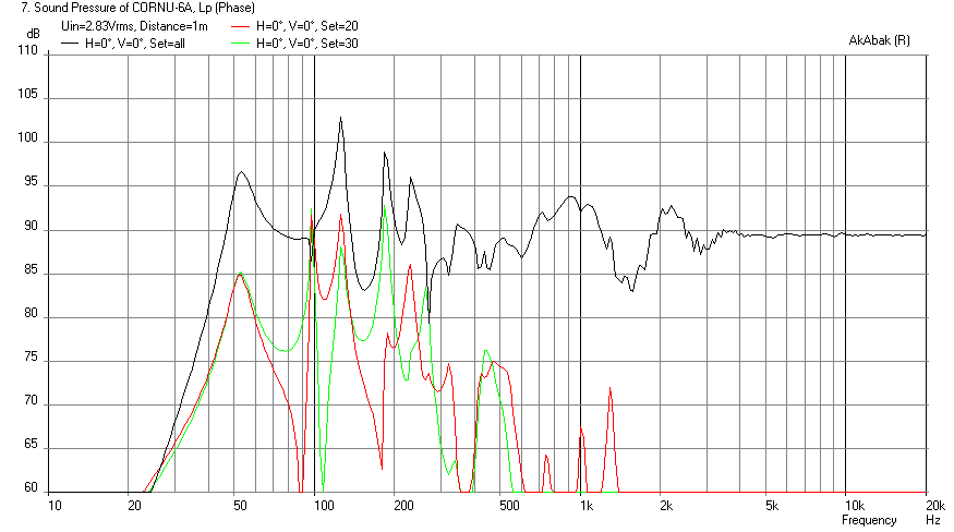

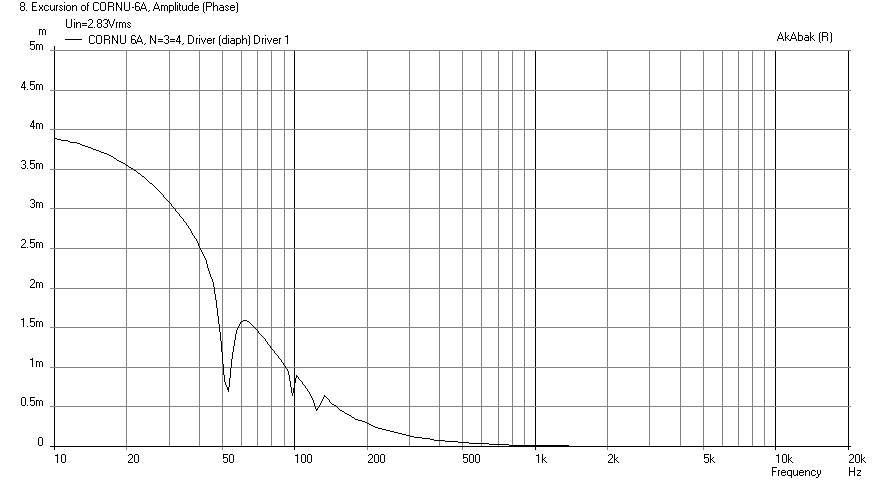

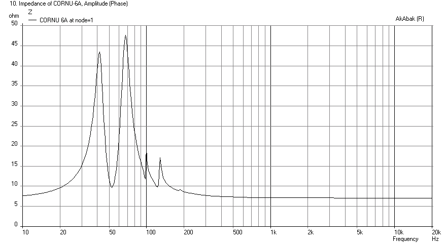

Cornu for RS 40-1254
Cal,
Your hunch on sizing it was good. The RS 40-1354 will work very nicely in a 36 in x 5 in deep Cornu. Here are the simulation results assuming good amount of stuffing in the driver chamber and light-to-moderate stuffing in the channels up to split point. Mount the speaker 53 in (at centerline) above the floor to minimize floor bounce null. Let us know how the build goes and good luck!
X
SPL vs Freq:
Cone displacement:
Impedance:
Cal,

Cone displacement:
Impedance:
