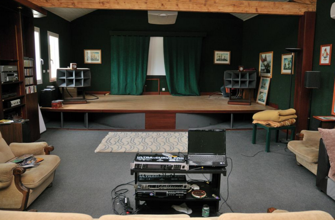

Somewhere there is a pic of a guy who built a spiral into his floor and just elevated the platform a bit to accommodate.
X did you post that?
