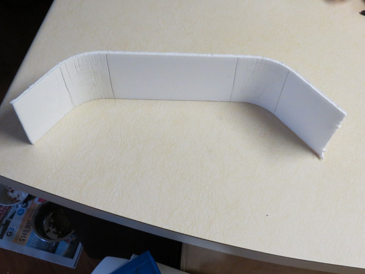

I am getting down to making the fins of the horn, can someone please remind me how far apart I need to make slits in order to curve the foamcore?

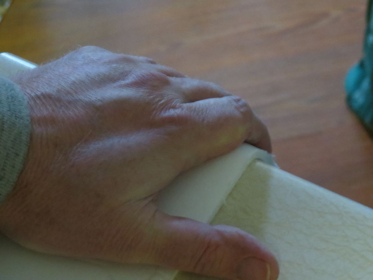

Curving the channels requires scoring cuts on the concave side. Cut deep enough to piece through top layer of paper. For right radius bends use 1 mm spacing and vary from there up to 5 mm spacing for gentle bends. Use round object with curve like a PVC pipe to form curve by pressing against strip of now scored foam on one side and palm on other side. Pre curve channels then glue section by section.

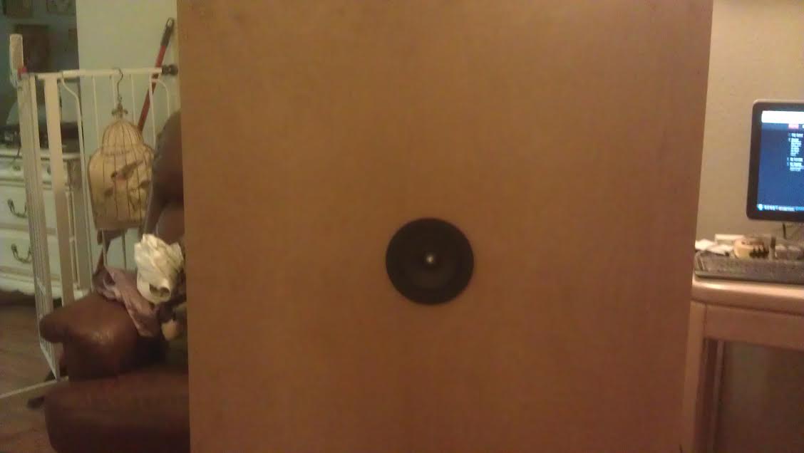

Do you have photos of the internals before gluing on final side? Wow, 3x3 ft is a lot of baffle! Which 5 in Tang Band is that? W5-1611SAF?
Do you have it mounted in the wall and in stereo yet? Must sound really big. 🙂
It is the 1611. It sounds great, big yes. I haven't mounted it on the wall yet, but it sounds good everywhere I've tried it, even the backyard.
Couldn't have said it better myself X, except that I found I didn't have to cut quite as often as you are suggesting. I used the first click on the Olfa style knife which worked out to be about 1/2 the board thickness and just did it freehand. I didn't notice if one side was better than the other to score. For the rounding, I happen to have a kitchen countertop that fit the bill.
