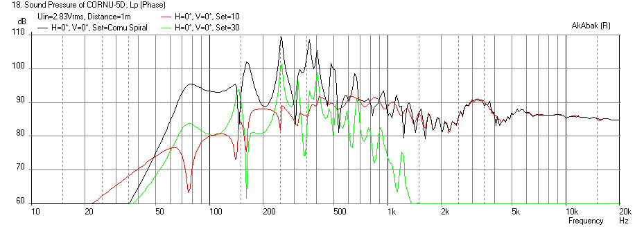

Get me the TS params and I will run a sim for you to make sure the depth is good.
Prezeden,

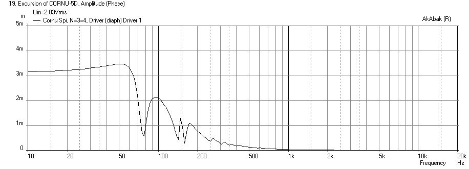

The NE65W can work in a 24 in x 1.75 in deep Cornu. The shallow depth is to balance the bass with the lower efficiency of the treble. Even so, you will have about 9 dB of gain in the bass down to 70 Hz and you will need some stuffing to reduce it to match the mids and treble of 86 dB. You will have to watch the excursion because even at 1 watt, xmax is already getting pushed at 70 Hz. Although for average listening, a couple of watts is more than enough. The driver may also have a larger physical xmax limit vs the low distortion xmax.
Thanks X- It sounds like the NE65W may not be the best driver for this project if I'm understanding you correctly. Can you or anyone else recommend anything else that will work in a 12" Cornu,
