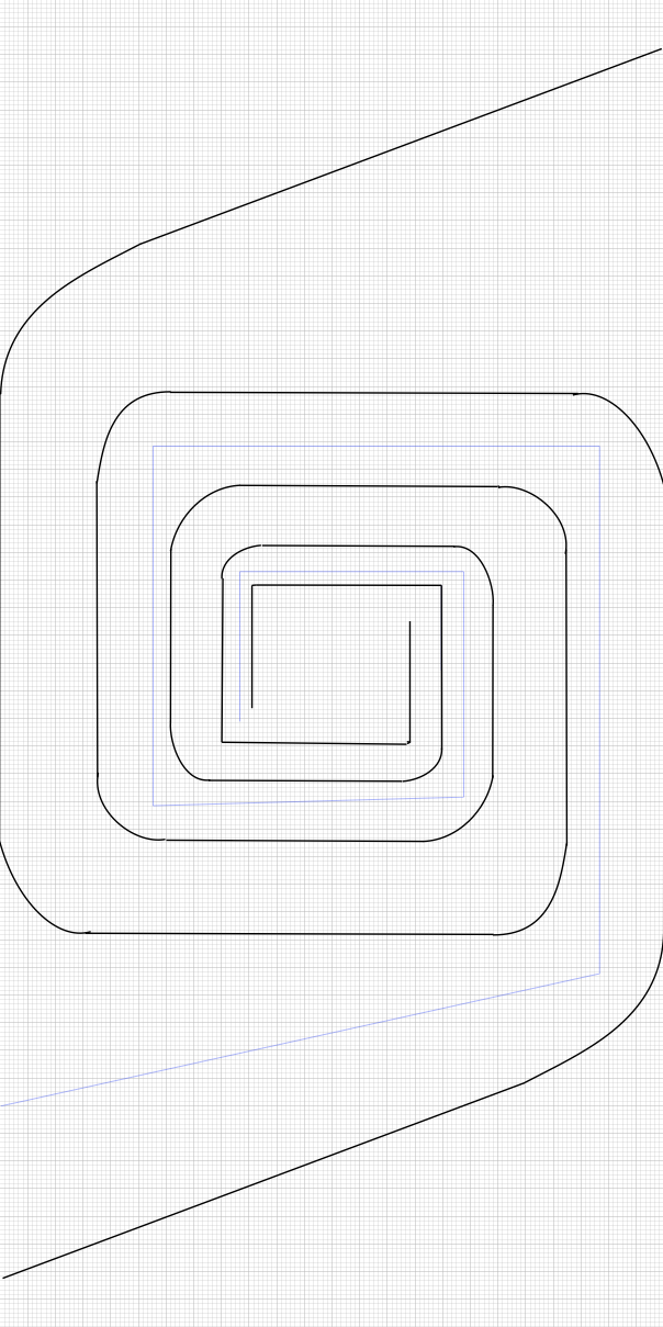

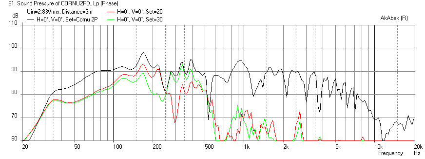

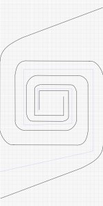

Hey all, here's a tentative 2 horn design under consideration. The goal is to get the design to fit on a 2' x 4 ft board, seeing as how they are available pre-veneered and cheap.
the graph represents a 2ft x 4ft board, so note that the horn flares could be increased by up to 2", or for that matter reduced. The blue line represents the trace I made totaling 8.5ft. I'm also wondering whether the flare could be bifurcated to reduce panel resonance, and what implications that would have for the horn output.

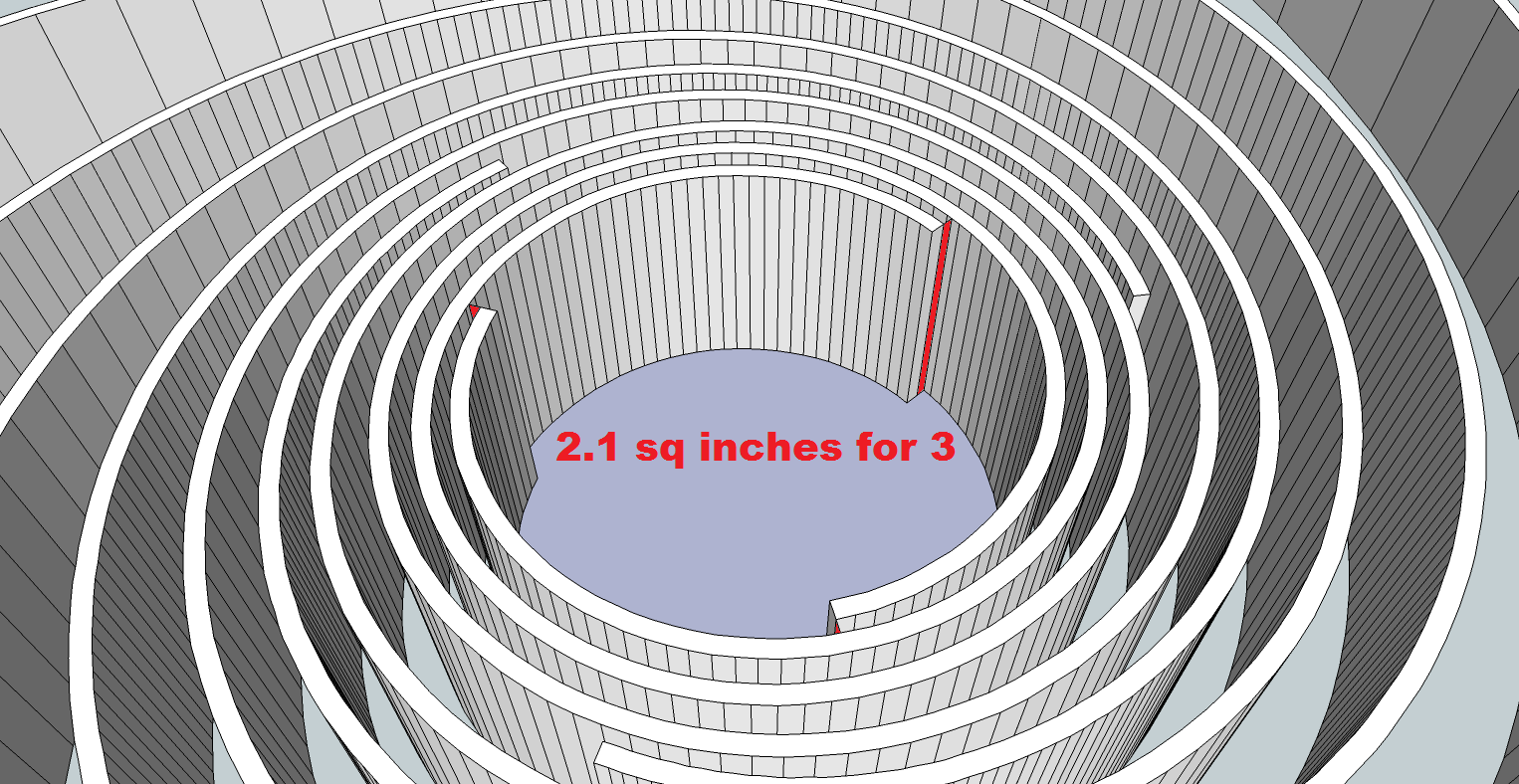

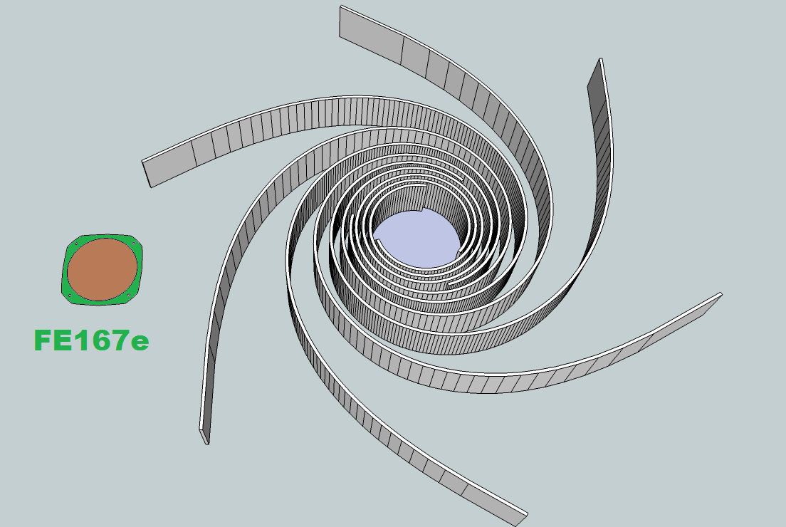

The 6 sided true cornu horn got my interest from earlier in the thread as posted by xrk971, shown again below in the pdf.
I scaled it to nearly 4x4 feet and arbitrarily assigned it 4 inches deep. That said, the sum of the areas of the 3 "throat entrances" (in red) to the horn are 2.1 square inches. The Sds are 20.5 (FE167e) or 10.25 (FF125wk) square inches. I read earlier in this thread that the throat should sum to .5 Sd.
Do you start removing spiral starting at the throat until you get to .5 Sd? That in combination with increasing the depth?
I'd like to be even able to use the FE167e if at all possible.
I envision cutting this thing out of cheap luan and forcing the foam board into the slots with an equal amount hanging out each side (the luan would then be in the middle). Then glue foam board on the outsides.

Tom,
It may be possible to go with a very small throat to Sd ratio. Now I have simulation capability and can run this setup with tight throat. It may work. You might have to go to 6 in thick. Let me check sim.

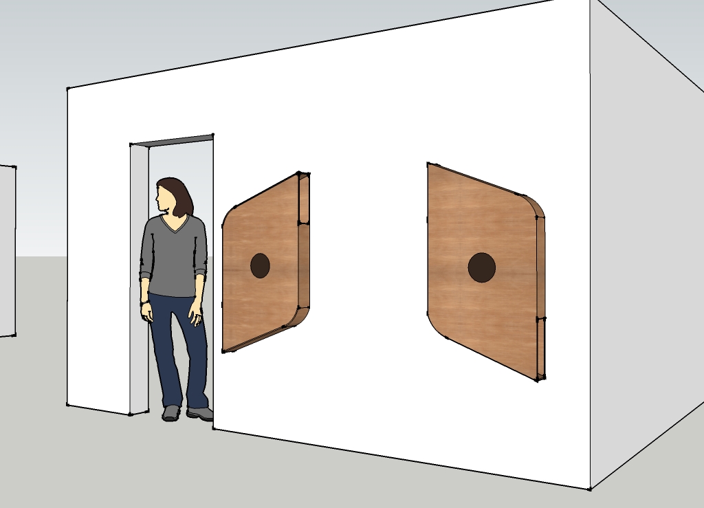

Picture a flower pot in front of the driver
Fronthorn

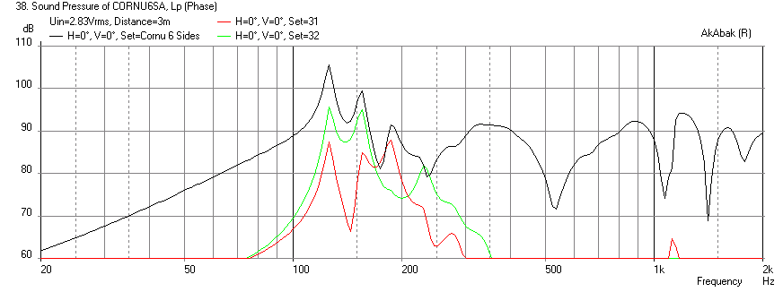

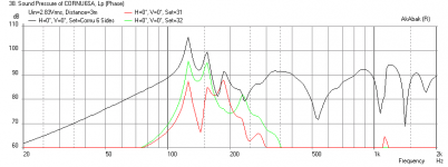

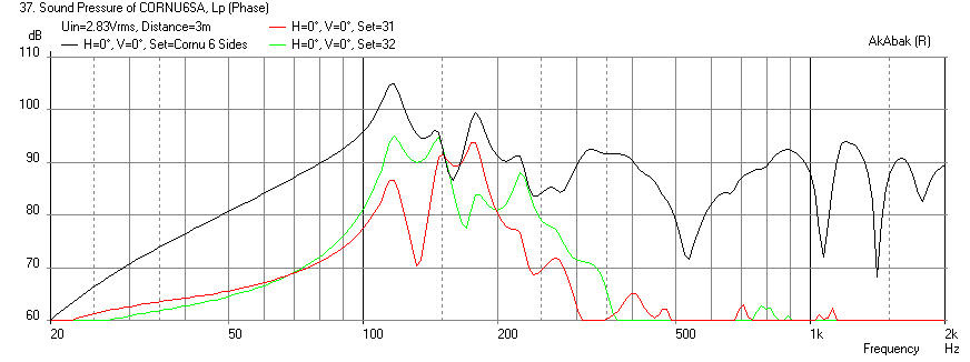

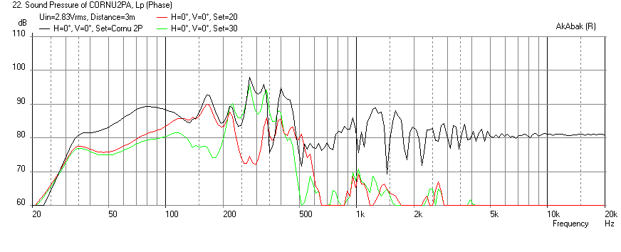

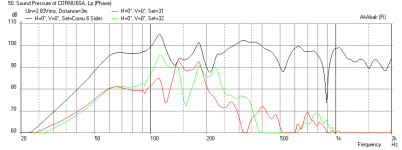

Sim of 48 in Round 6-channel Cornu
I built the model of the 6-channel Cornu with the true Cornu function spirals approximated by an exponential channel with mouth of same dimensions. The narrow gap of 0.175 in is as we suspected: a bass buster. It has to be increased to 2 inches with a 6 in channel depth before it will work reasonably well in the bass department. But it also has issues with the channel lengths needing to be fine tuned to eliminate the big cancellation dips at 140 Hz, 270 Hz, and 540 Hz. Below are the sims with sound measured at 3 m away with speaker at 1.2 m above floor (centerline of driver), horns arranged so that shorter channels are at 0, 120, -120 deg (0 deg is up), long channels at 60, 180, and -60 deg (180 deg is down). 1 watt input power. First plot is freq response for 2 in gap, second is 1 in gap, third is 0.5 in gap, 4th plot is 0.175 in gap. As you can see, the design could work if the gap is big enough, but the bass is not as deep as I think should be possible from a 4 ft diam speaker.
Short story is: don't build this variant unless you modify the channels to get a bigger gap.
Last plot: if you add a conical front horn 16.5 x 16.5 cm throat and 35 x 35 cm mouth 35 cm deep, you get improved sensitivity on the top end. 95 dB at 3 meters away with 1 watt input is pretty sensitive!
Back to the drawing board
Thanks for the wonderful modeling, I guess we'll toss that one in the dustbin of history.

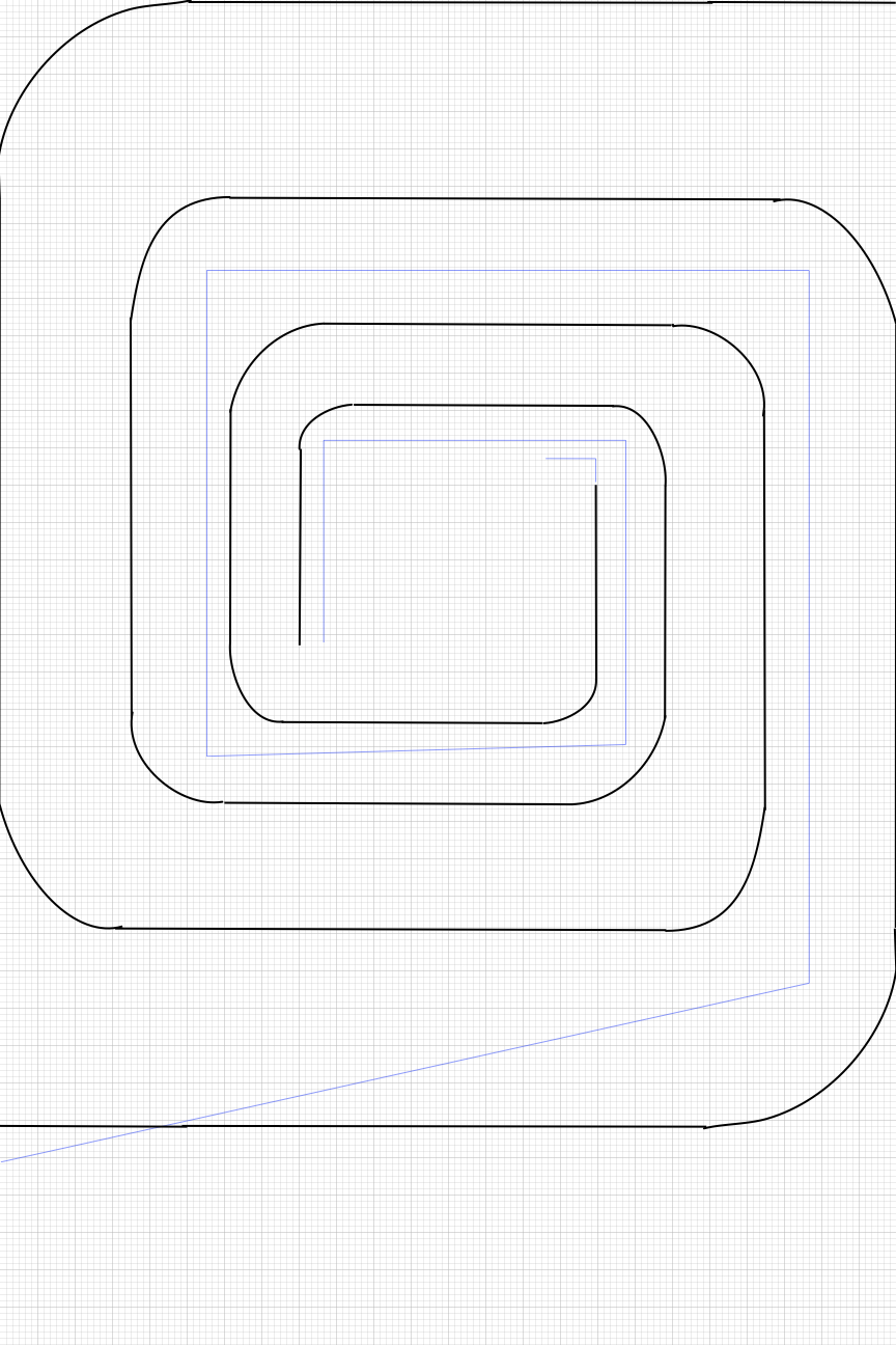

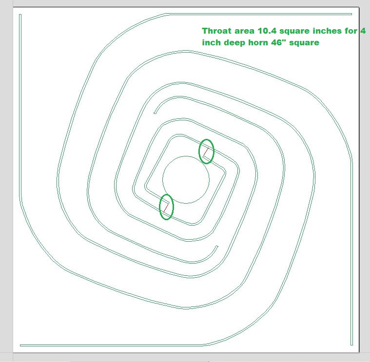

I took the "cornu original" pdf and scaled it to a 46" square horn. The "cornu original" pdf from earlier in this thread is posted below along with a jpg of the scaled 46" square horn. The white background is the 48" square piece of plywood to cut the slot in. The throat is 10.4 square inches for a 4 inch deep horn.

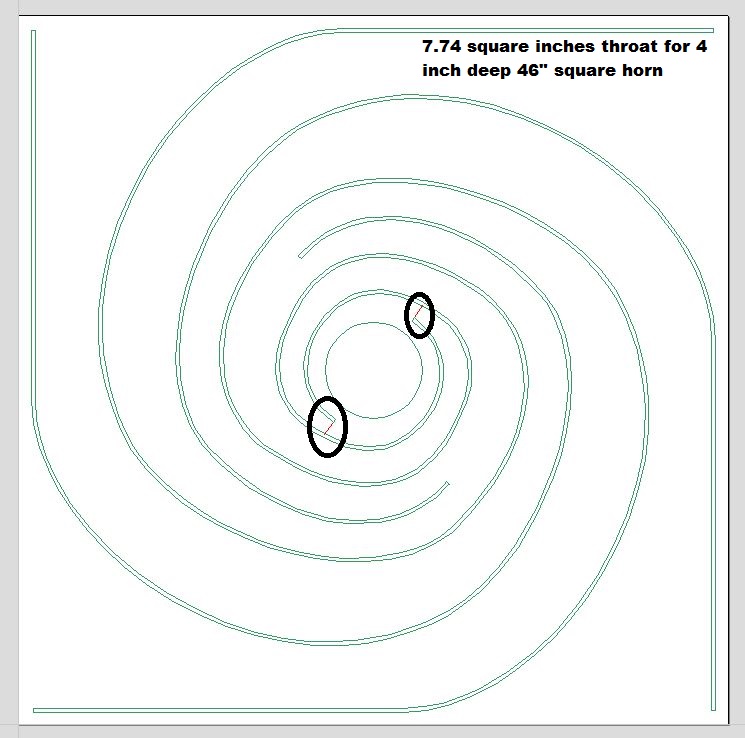

The "cornu spiralized" pdf from ealier is also posted with a jpg of the scaled 46" square horn. The throat is 7.74 square inches for a 4 inch deep horn.
I can supply cad .dxf files for those interested...
I'd like to build one these. Question is, which one? Like I said before, I have both Fostex FF125wk and FE167e to try...

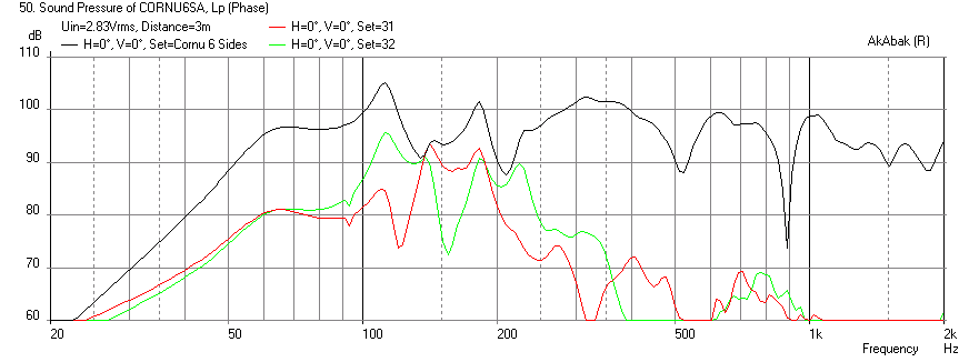

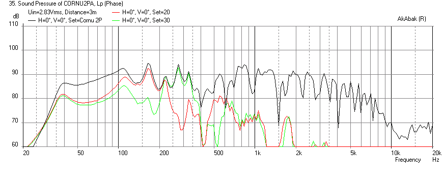

Sim of Chaz's rectangular double horn Cornu
Chaz,
Based on the dims you gave me for your double horn rectangular (48 in tall x 24 in wide x 4 in deep) double horn Cornu design, I built the model and ran the simulation in AkAbak using the TB W5-1611 driver (with measured T/S params as published on PE Techtalk). The design has very deep bass extension down to 40 Hz, but it is depressed compared to the output from 100 to 500 Hz. You will have really big peak at 300 and 400 Hz. The sims are for 1 watt input, 3 meters away, driver at 1.2 m above floor, horns exiting upper left, and bottom right horizontally as you requested. The black curve is total horn and driver radiator combined, red is bottom right horn (floor enhancement visible) and green is upper left horn output. The second plot shows what I tried doing to improve the performance: double the depth to 8 in and it helps to enhance the bass shelf. So one way you can save this project is to build a second set of channels on the back of your speaker, cut a hole to connect both sides and seal it up with a back plate. Additionally, you can add a simple square shaped conical horn of 11.5x11.5cm throat 20cmx20cm mouth, 7 cm deep and it will balance things out nicely.
Good luck and let me know how your measurements compare. Important to place at 1.2m height with 3 meter mic position for good comparison.

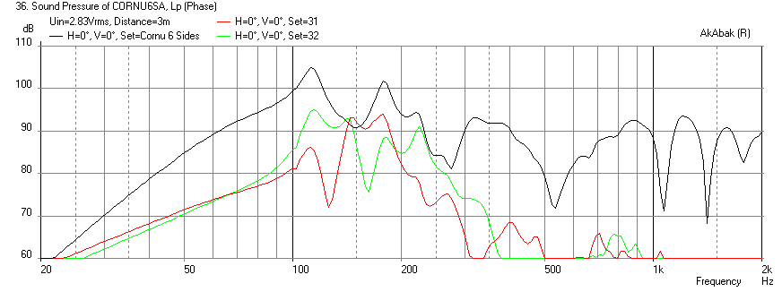

Chaz,
I think your design can work if doubled in thickness, or go back to 4 channel as I modeled for you earlier as 3x3 ft. You used the wrong foam (eps). What you want is the pink xps stuff here Owens Corning Foamular 1/2 in. x 48 in. x 96 in. Squared Edge Insulating Sheathing-36L at The Home Depot

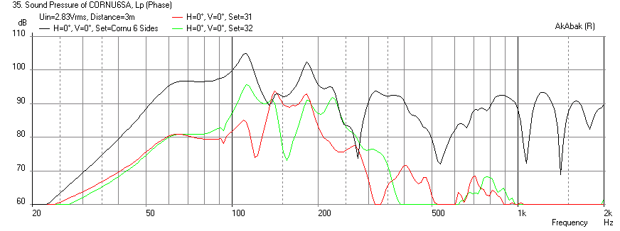

Chaz,
I'll see what I can do to tweak your 24x48 double horn. It will probably have to grow to 5 in depth as 4 is just too small for a 5.5 in class driver. Are you opposed to a front horn due to WAF? Because that helps a lot.

I appreciate your help, xrk. I'm not totally opposed to a front horn, but what I'd really like is a horn that has good extension but doesn't generate such excessive mid bass. I'm not totally clear yet on what elements of the horn need to change in order to achieve this, but I don't mind adding an inch of depth.
Chaz,
I tried constricting the throat, closing off the mouth, adding a throat upstream of the mouth, changing chamber volume. Nothing will really get rid of the mid bass peaks as well as rotating speaker 90 deg, adjusting height, and adding front horn. The extension in bass goes to 35 Hz but it starts a slow falloff from 70 Hz. That's about all you can do to improve things. Final config is 5 in depth, 3 liter chamber vol, 11.5x11.5 cm thoat by 20x20 cm mouth x 7.5 cm deep front horn. Mount at 1.1 m above floor.
