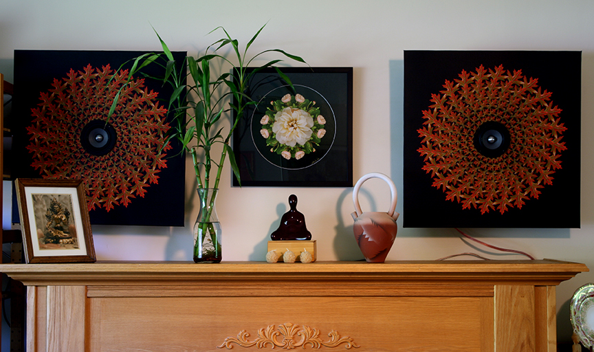

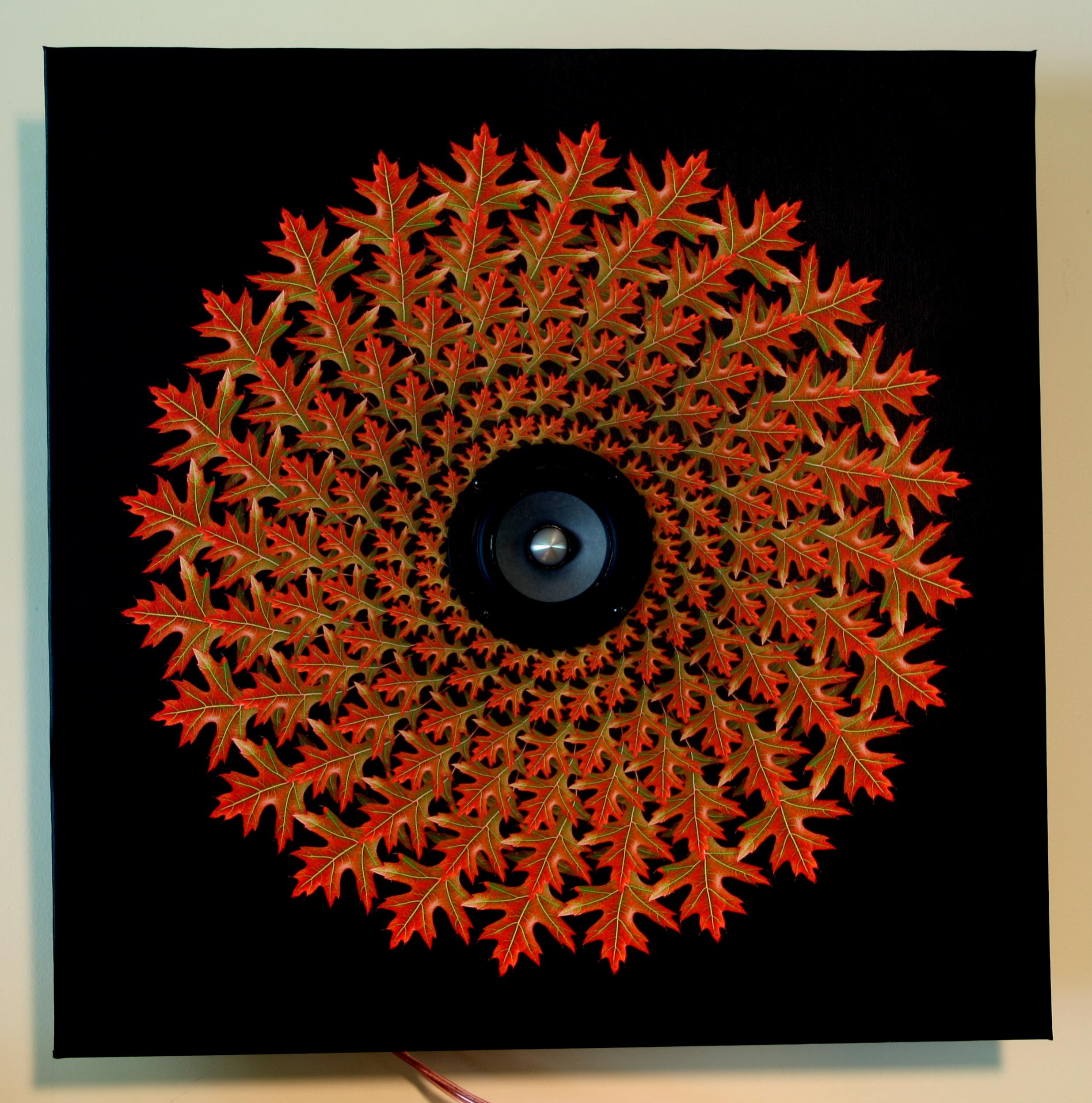

Prez,
That's a beautiful piece of art more than a speaker. I'm glad enlarging the driver cutout holes worked out for you. Congrats.
Did you do the cover design yourself?
How does this build compare to all the rest? Is the 4 inch bamboo driver really good?
Hi X- Thanks for the kind words. The artwork is a piece I did a few years ago recycled for this project.
I'm still breaking in the speakers but they sound quite nice. I'm using an unfinished Peter Daniels kit for the amp so have 2 unknowns going at once. At this stage they seem in between the 14" and 18" ones with the smaller being the fuller sound and the 18's being a bit thin. I have just put some new W3 bamboo's in the 18 inchers and they seem a little fuller with better bass. I don't think my poor old ears are so good to really be able to judge the subtle differences.
cheers- prez
cheers- prez
After a few week listening I think the W4 bamboo drivers sound great in the 22" Cornu's. The sound is very clean, detailed and well balanced. 😀
