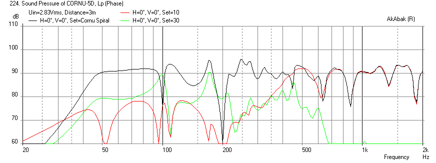

I got the blueprints today; looking at the size of these horns, if I don't get a solid 35hz out of this thing I'll be let down. I decided to try the two-horn version first since it will be easier to make.
Chaz,
The design has solid bass extension to 50 Hz (90 dB) and will only have 75 dB at 35 Hz. This is at 3 meters away. You are going "off-reservation" if you make the 2-horn version - I can't guarantee the 35 Hz extension because there are a lot of things at play here: throat, chamber volume, channel width, mouth expansion ratio end-correction. Making a mouth expand greater than original will reduce extension. I would be patient and do both passages - you will get a better sounding product.

maybe I'm not reading the graphs correctly, but just looking at the original design, isn't the 2-horn option showing strong output into the mid-30s?
Chaz,
The response curve for the 1.2m above floor case on post 880 I think is below. It starts to decrease at 50 Hz and has output at 75 dB at 35 Hz - don't know if you call that substantial. The Panpipe pentahorn BLH design on the FC thread goes to 30 Hz before it starts to decrease, but that is a completely different design that is my own and optimized from the ground up for the W5-1611.
Here is the Cornu response with the W5-1611and front horn
Here is Panpipe BLH with the W5-1611
Maybe you are mixing the two up?

This is the one I'm talking about.
