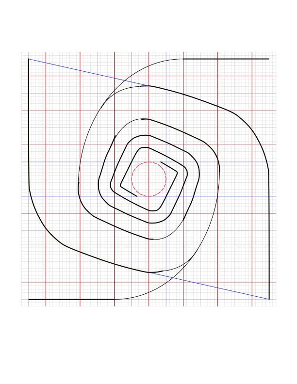

So before I commit to making the 3'x3' cornu, I'd like to see whether or not there was some optimizing that could be done for a 2-horn design. I took the original scalable design and removed the short horns, at the same time widening the long horn paths considerably. Xrk, I'm not certain what the total ramifications are for this but I wanted to see if you could sim it to see if there are any positive benefits. The blue lines represent an optional diamond-shape horn with no empty spaces. Let me know...
Chaz,
What you describe would be the same as blocking the short horns. Widening the paths just increases the gain amplitude but the dips and peaks will still be the same. Running sim with revised geometry is a lot of work as it requires manually measuring the horn path widths and lengths with dial calipers. I think assumption of similar response with higher amplitude should be good - see below. I would recommend going with the original plan as designed.
