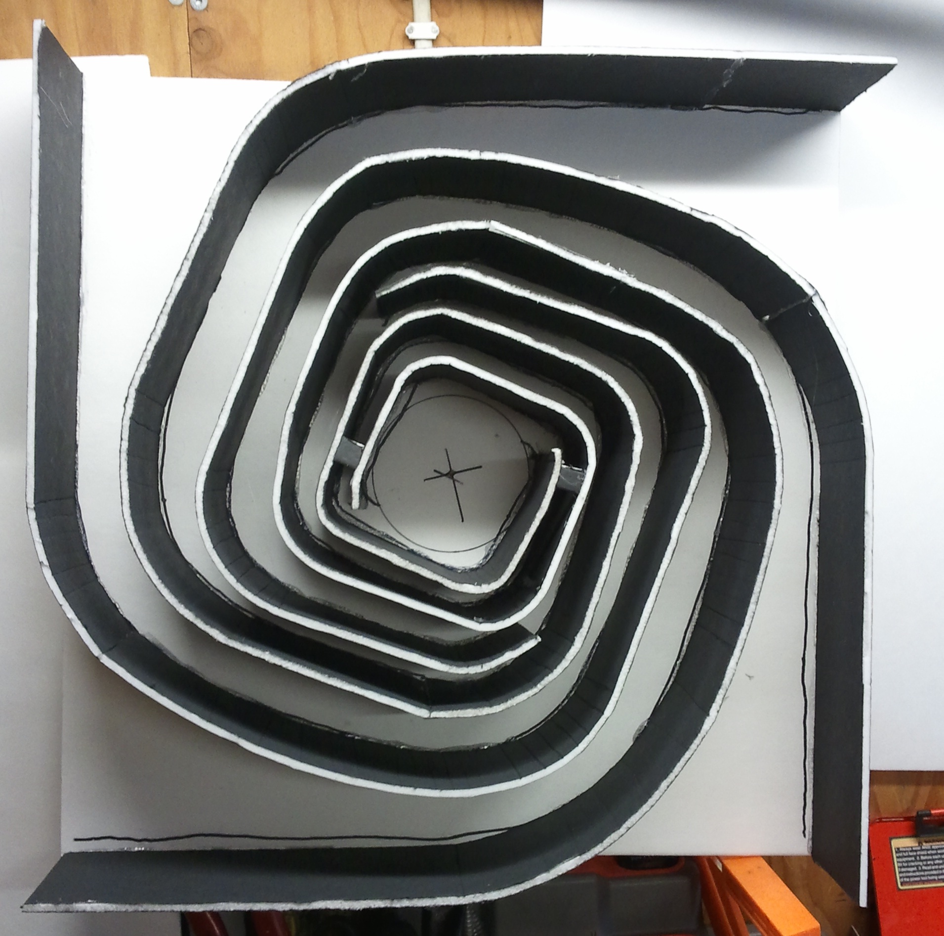

Hi: Having read this thread I put it on my ToDo list......
First made the mini's 16" with 2 3/8ths tall channels .....with the cheapest 2" speaker I had lying around,
( creative).
It convinced me to try and build a better pair.
.....So now am doing the 20" for 4" drivers, with 4" channels...
I used some 4" JBL's out of 3 way towers and there is no bass so need to order speakers.....
the ones at parts express that would fit are:
Celestion Neodymium 5" Full Range Woofer 8 Ohm 299-416
Visaton FR13-4 5" Full-Range Speaker 4 Ohm 292-518
any advice?
Thank you.

Congo,
5 in drivers are too big for a 20 incher. Try vifa tc9fd, Tang Band w3 or maybe smaller w4. Visaton Fr10. I suggest using one someone has tried with success.
Good luck.
Good luck.

Congo,
Your 20 in x 4 in deep design has a throat area of 44 sq cm. A 4 in class driver has 50 sq cm Sd typical. A 3 in driver is arond 30 to 32 sq cm, kind of small. The TC9FD is 36 sq cm. It's ok for a 50 sq cm driver to push a throat area that is 88% of driver Sd. A MA CHR70 will work very well too.

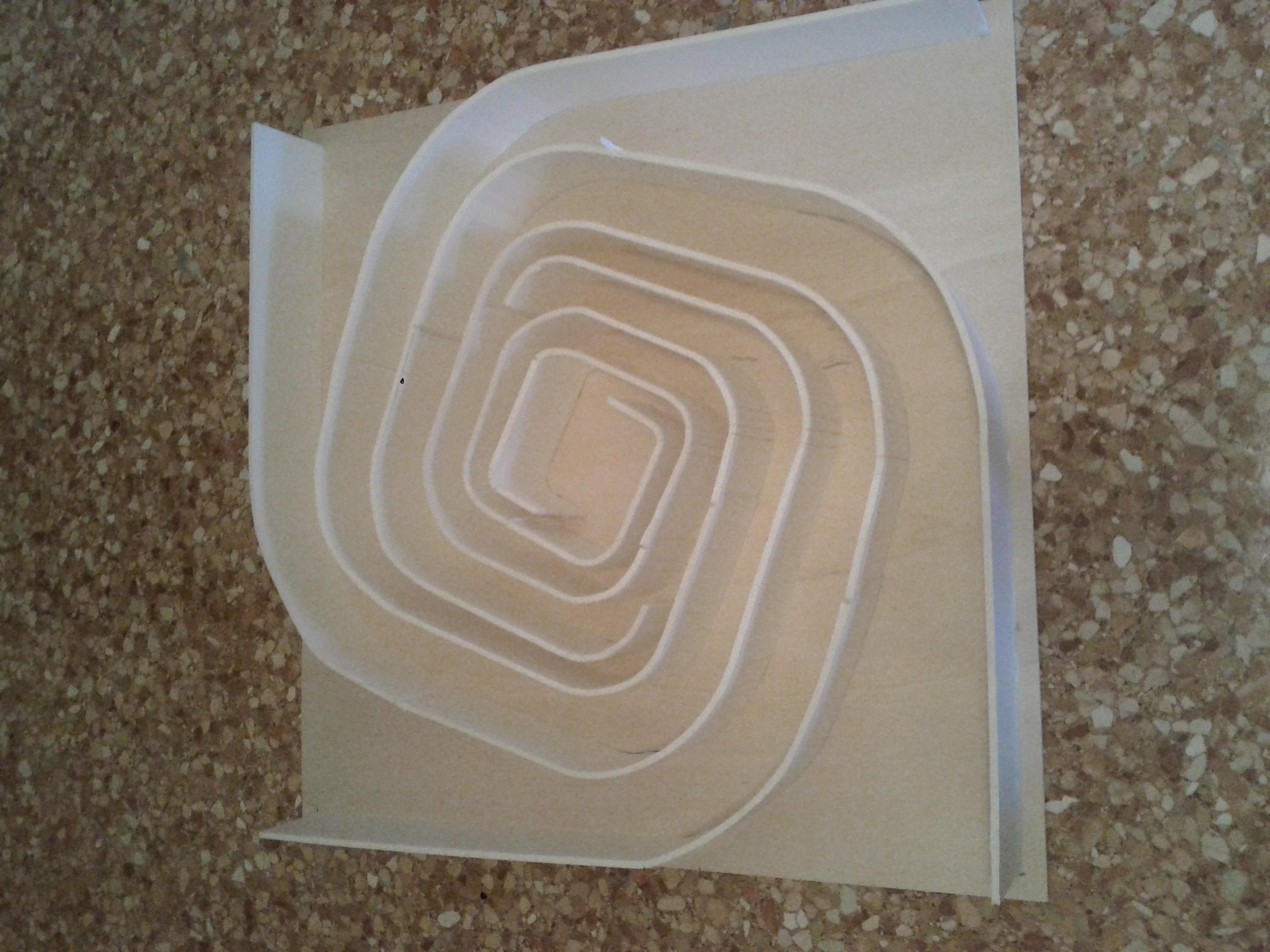

New Implementation - VIFA TC9FD
Reading this Thread and thanks to all the contributors, I decided to build a new 70 cornu speaker with the Vifa TC9FD. The channel depth is 9.5 cm to match the Sd=36cm2.
I mainly followed the building suggestions from the previous post.

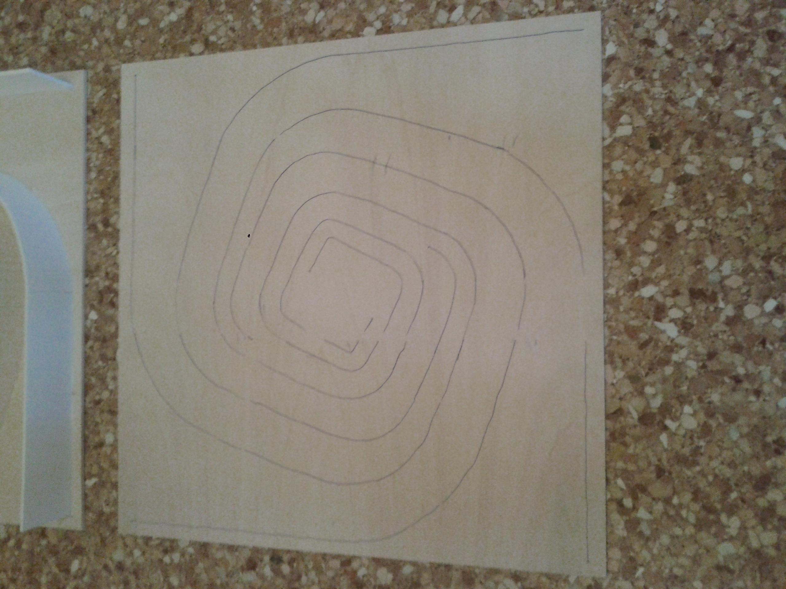

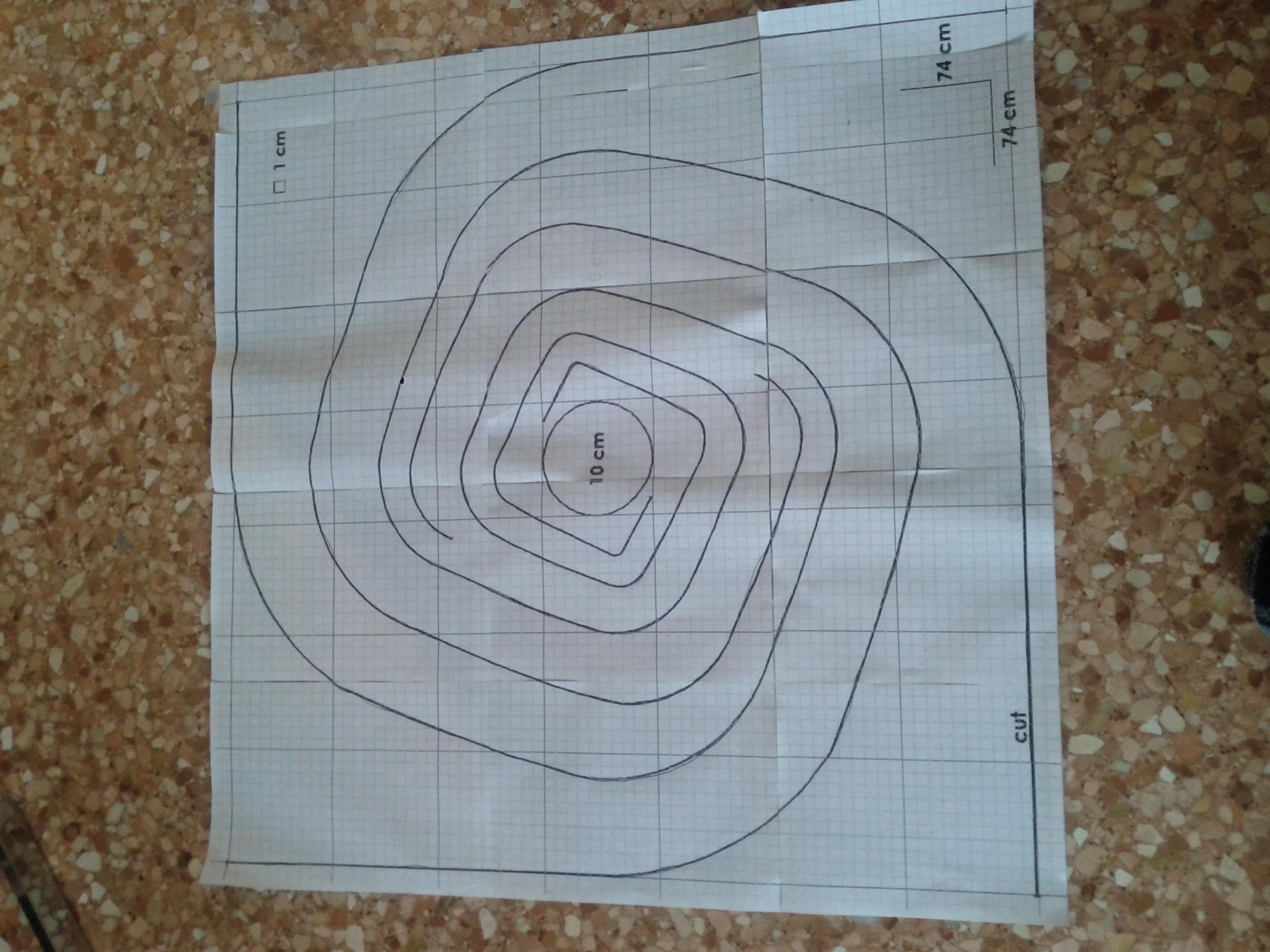

What can be of interest is the process to transfer the pdf cornu drawing (thanks to @endia) to the 74x74 ply plate. I used the free software PosteRazor and I created a 74x74 collage done with A4 sheets. See the picture below.
Then I transferred the drawing to the ply using carbon copy paper. That's it.

A little bit concerned on closing the speaker with the top ply plate: the internal foamcore strips are not so accurate in width and I cannot grant perfect matching. Any suggestion?

Nice work Meazz,
Use gap-filling glue/adhesive. Gorilla glue expands on contact with water. Household acrylic caulking is an option. 5 minute epoxy. Best is to cut strips accurately and use pva.
Good luck.
Btw, 74 cm is very big for Vifa.

Thanks for the suggestions. I'll go with Gorilla glue to fill +/- 1mm of difference on strip widths.
Regarding the size, that was the solution to match the Sd of VIFA without redesign the spiral (just scaling). Do you think I should stop the building and move to the 50cm version?

The overall scale can work for Vifa although the bass extension may not be well matched as 70 cm is tuned for circa 50 Hz. Non one has tried 70 cm with Vifa, it may work very well. Keep going with it.
