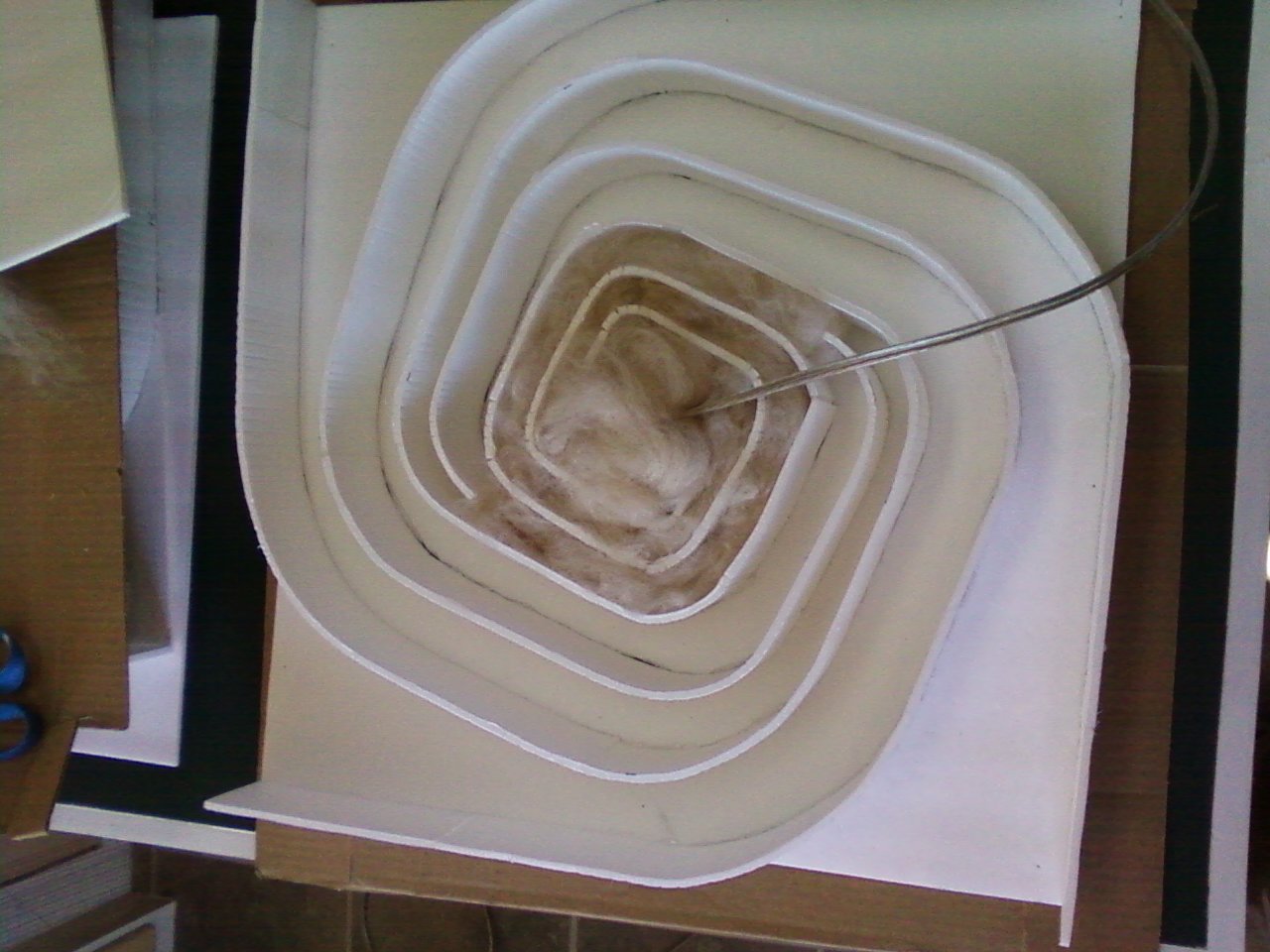

Got the 20" traditional Cornu pair finished. Have the TB W3-881SI 3" full range drivers. Instead of Cal's suggestion to stuff with rock wool, I used some real wool from a "roving" (carded fleece) from one of our sheep.

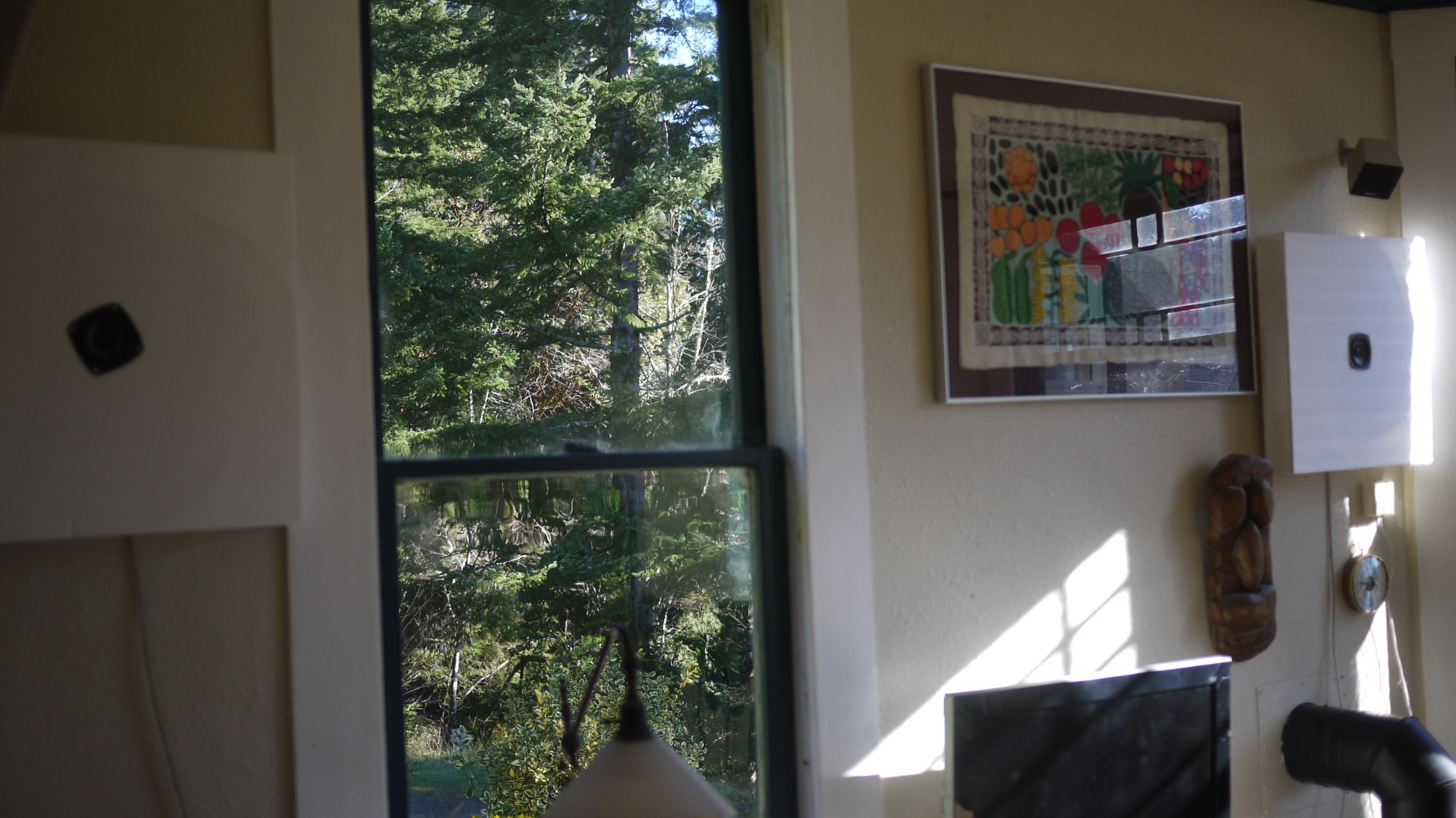

These do sound amazing! Listening to Herbie Hancock's "River: The Joni Letters" through a Lepai 2020A. So, let's see, this is about a $50 system (without the iPod). Unbelievable!
Jsouder,
Those look great! You did a really precise job following the plan for the channels. The genuine wool hot off the back of your roving sheep takes the cake though! 😀 I am glad you ended up with a sound that you like. What channel depth did you use? Those $10 Tang Band buyouts seem to be having good success in the cornu. It also looks like the amount of stuffing you used worked out well too. Yours could be a prescription for those wanting to try a very low cost version of the cornu's. Like you said, you got love how good they sound for $50 with amplifier.
Congratulations!

Distance between drivers will be 2.5m when I hang them each side of the fireplace.

My channels will have to be 5 1/2" deep at least to accomodate the driver. And I do have to reread the section on throat calculations and find the data on my drivers.
The channels on that one are 2.5" deep, which with a throat of 0.5" is about 50% of the Sd area.Jsouder,

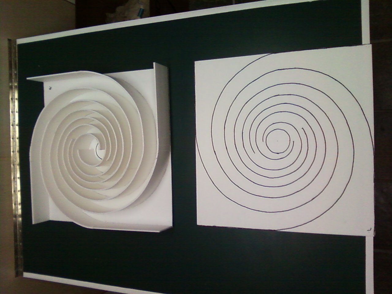

My next set will be 20"ers in a true spiral with 3.25" channel depth. With throats of 0.625", the area will about equal the Sd. Here's the start:
Jsouder,
Those 20 in true spirals look really good. Can't wait to hear how they sound.
Nice job.
Nice job.
