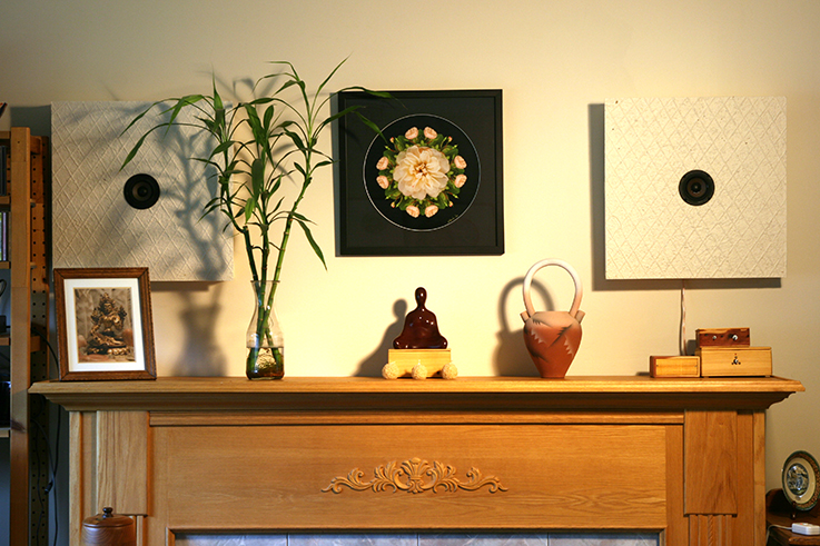

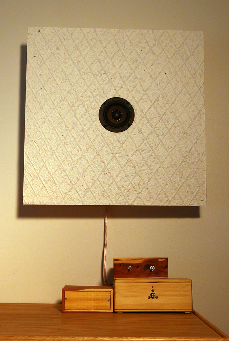

Well I finally completed the 16" Cornu build and must say they sound great. And that is with a pair of brand new TB W3-881SJF's. I can only guess how they will sound when broken in.
Yesterday evening a friend came over and we spent a couple hrs. listening to a variety of jazz and classical. I haven't been that blissed out listening to music for a long time.
Thanks to all for your help and encouragement. 😀

Those look great prezden. Is that a wallpaper on them? I might have missed you telling us.
Also really glad you like them. Your reaction sounds similar to many of us.
Big difference from the closet door ones?
Prezden,
Very nice job! They look fantastic mounted on the wall - I am happy to hear that they sound great and you are enjoying listening to the music. The cornu is what made me want to listen to music again - it has a special sound. Do you mean the W3-881sif clearance drivers for $10 ea? There is a good deal in great sounding and nice looking speakers for you. What depth did you make the 16 incher and which plan are you using?

Thanks guys
The front cover is a heavily textured hand made paper but wall paper would work just as well. I also made the front 1/2" all round bigger than the actual box so you don't see the edges and It gives them a sense of floating off the wall.
I got the drivers from Solen for about $16. each.
Thanks guys
Your handmade textured paper looks great on the Cornu's. Where do you buy it or do you make the paper yourself? What amp are you using to drive the 16 inchers?

I buy the paper from a local specialty shop. Unfortunately it only comes in 20x28" sheets so a bit limiting in size.Your handmade textured paper looks great on the Cornu's. Where do you buy it or do you make the paper yourself? What amp are you using to drive the 16 inchers?
Right now I am using an ODAC, JLM 06 pre and a 2024 amp. I'm hoping to make a gainclone for them in the future.
cheers
Prezden,
One other question. Are your electronics (pre and power amp) housed in thos little pine boxes on the lower right? At first I thought they were just keepsake boxes but noticed knobs and toggle switches on the front, Very earthy in keeping with the hand made paper baffles! Nice.
Yes they are. I get to combine 2 hobbies in one 😀Are your electronics (pre and power amp) housed in thos little pine boxes on the lower right?

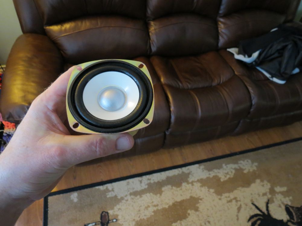

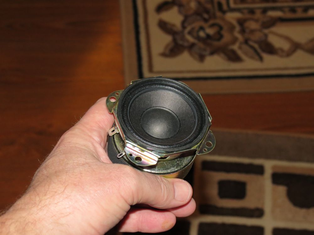

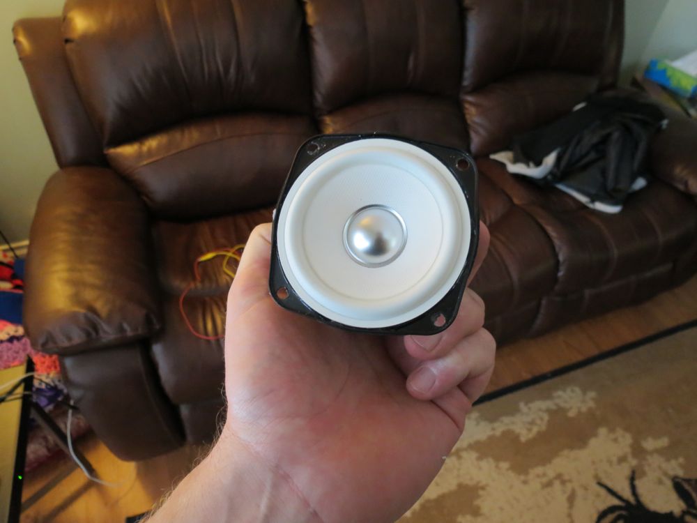

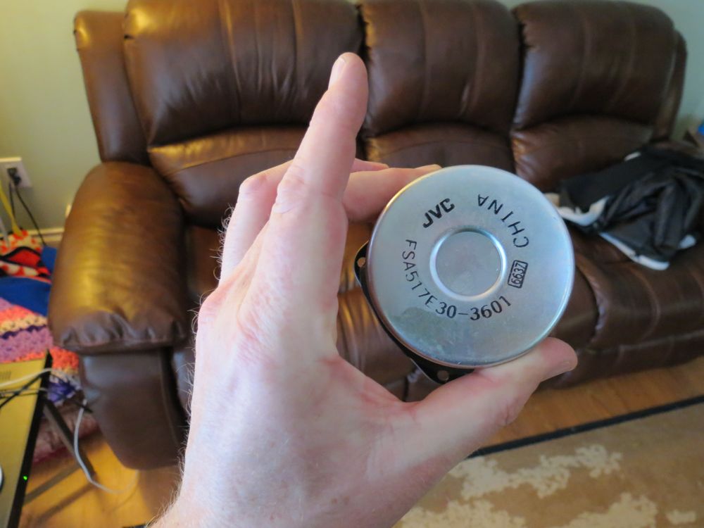

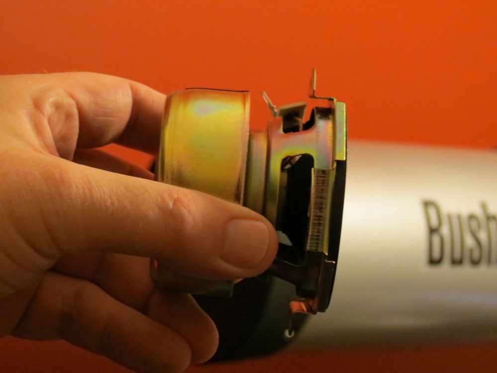

Since I can't really help myself I stopped in at not one but two different Sally Ann's.
What I found at the 1st resembles the LG in appearance but they are a little light in the top end. Made by JVC in China they were solo in small ported boxes. They have a stronger bass but not good as a tweeter. Kinda half way between the Fostex 125's and the LG's. On axis they are fine but fade quickly off axis.
