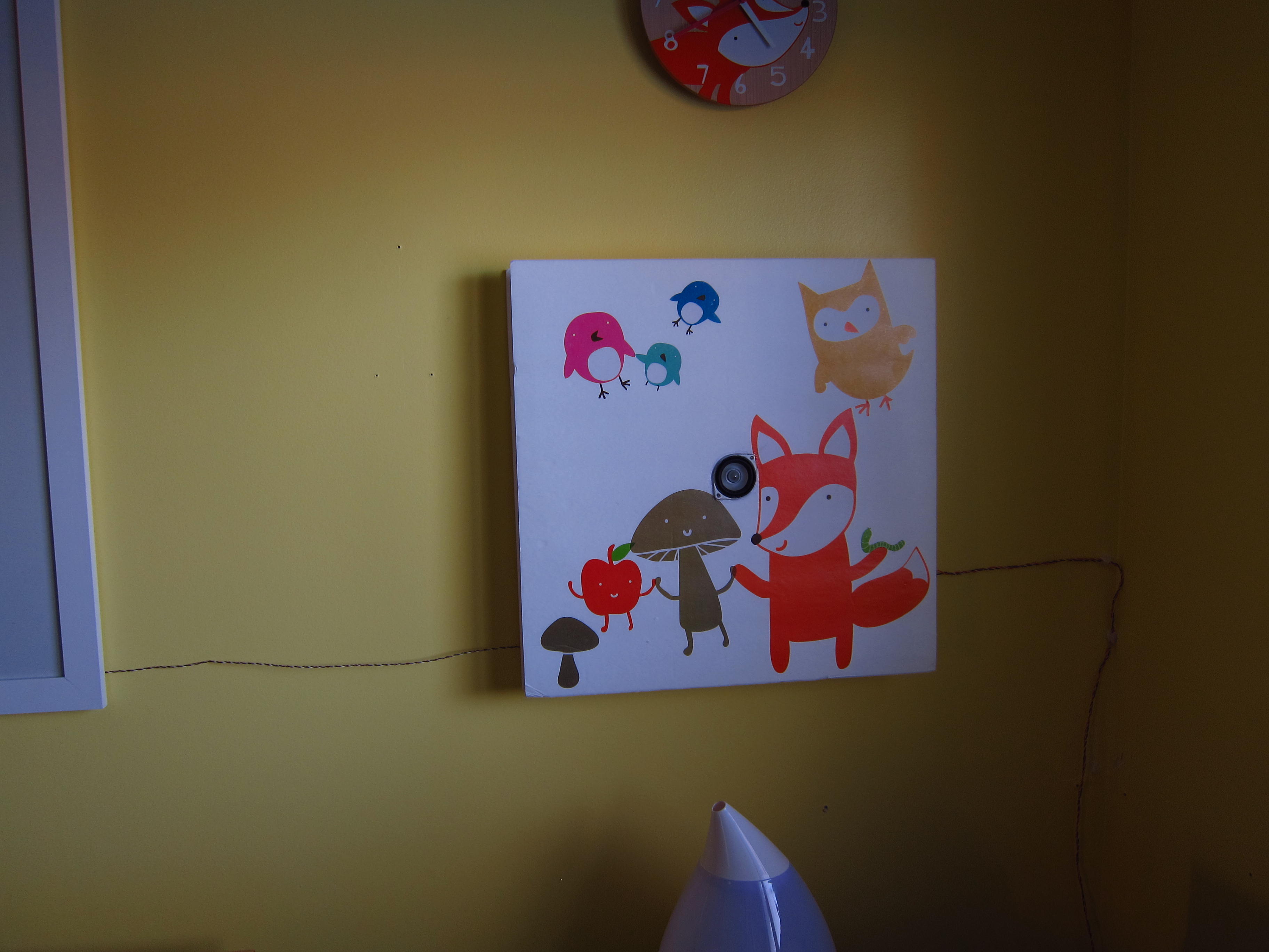

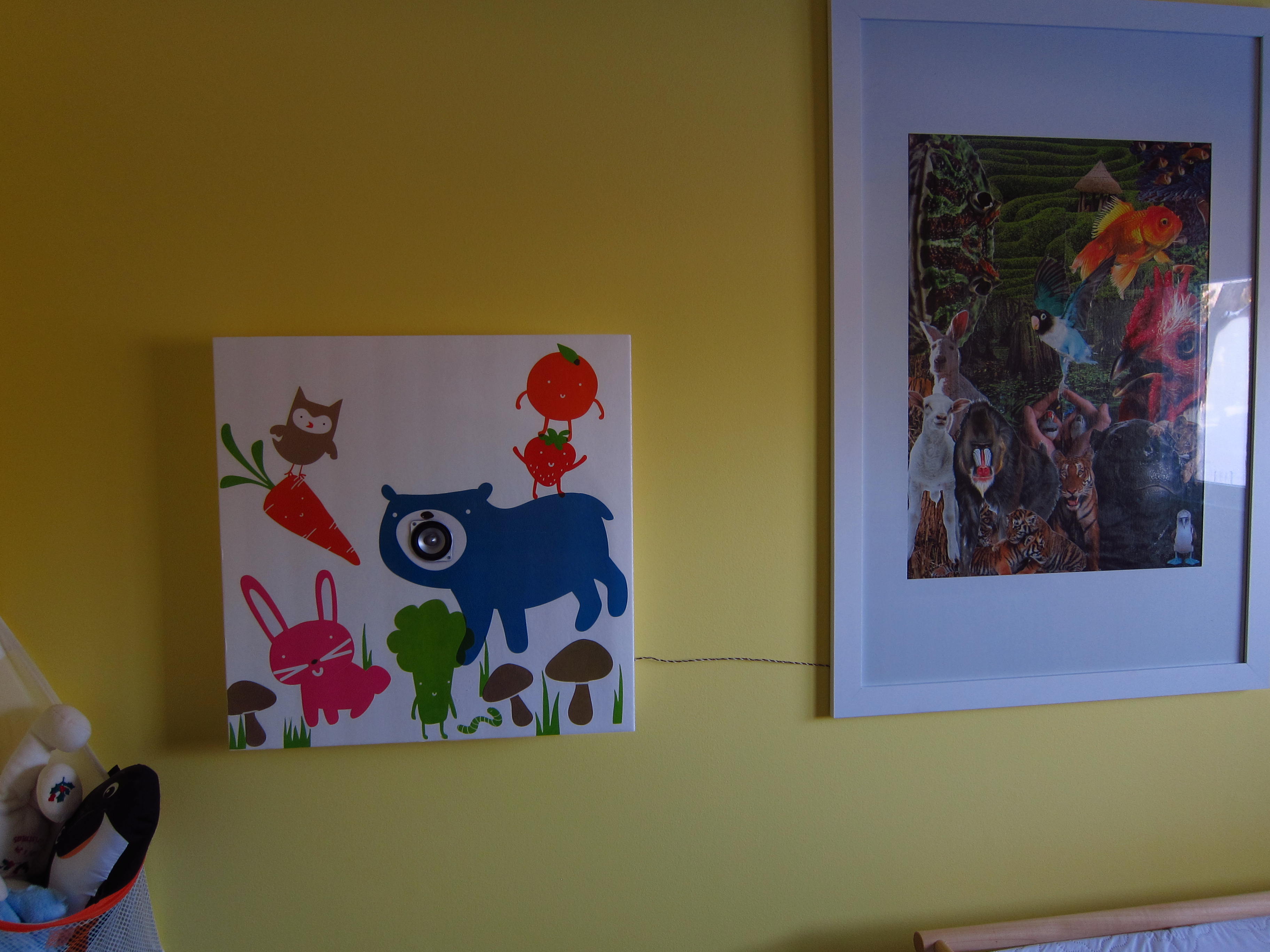

I built a pair of these a couple weeks ago for my son's room. 20"^2 x 2"D - 2" drivers from a logitec speaker. I didn't put too much care into the build but they sound pretty good and look okay. Unstuffed they sounded terrible (!) but are great with a fistfull of wadding. Thanks for the idea guys!

The artwork looks great, did your son paint them? 20 in is probably too big for the 2 in drivers as the fs of the driver is way above the low freq of the horn, but hey, it sounds good!
Congrats!
Thanks for sharing.
Which Logitech model?
Congrats!
Thanks for sharing.
