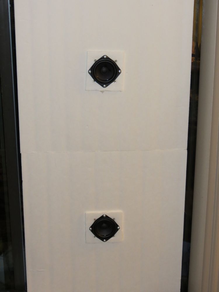

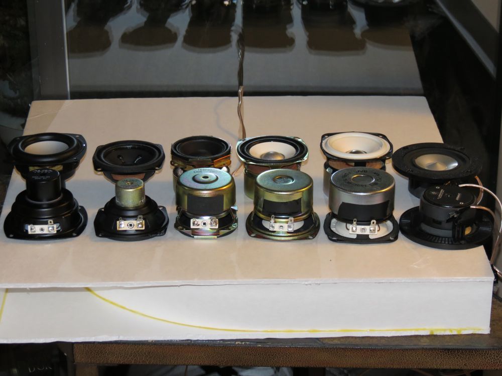

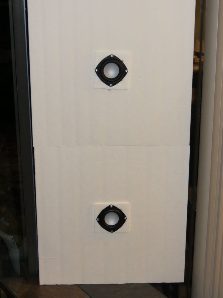

Package arrived from planet10 with the two new sets of Aura drivers. The $2 AS3's are better than expected.
Hard to see but the other mounting holes have been filled with hot glue.
I got a reply to my PM to Hersh (Sebastien Pitkanen). He said that when he did the cornu, he talked to Daniel and the double layer plan with the semi-curved design was supposed to be the final optimized design. Apparently there is supposed to be something to that design and having 8 flow channels or horns that makes a difference. It would be interesting for somebody to make an exact copy with two layer horn in foam core in the full 70 cm size and use recommended driver (Monacor or FE108Esigma) and do a measurement. Anyone have a FE108ESigma handy?

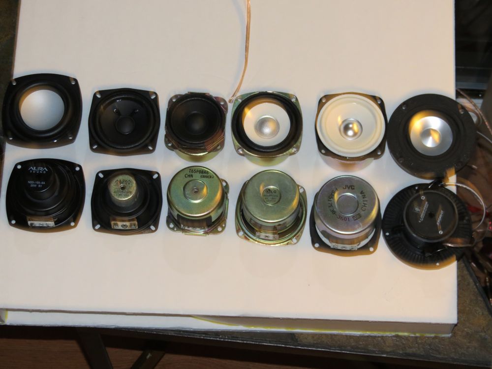

How do they sound, Cal?
Four of them sound good. The two that I wouldn't recommend for this application are the slightly smaller chinese driver with the recessed flange (third from the left) and the Jordan.
They all need to be pushed right against the wall to achieve decent bass, no wiggle room on that.
The $2 Aura is no slouch so it definitely wins the economy division.
The more expensive Aura and the JVC drivers are similar with the LG's slightly in the lead. But as mentioned the jury is still out, too soon to say for sure.
