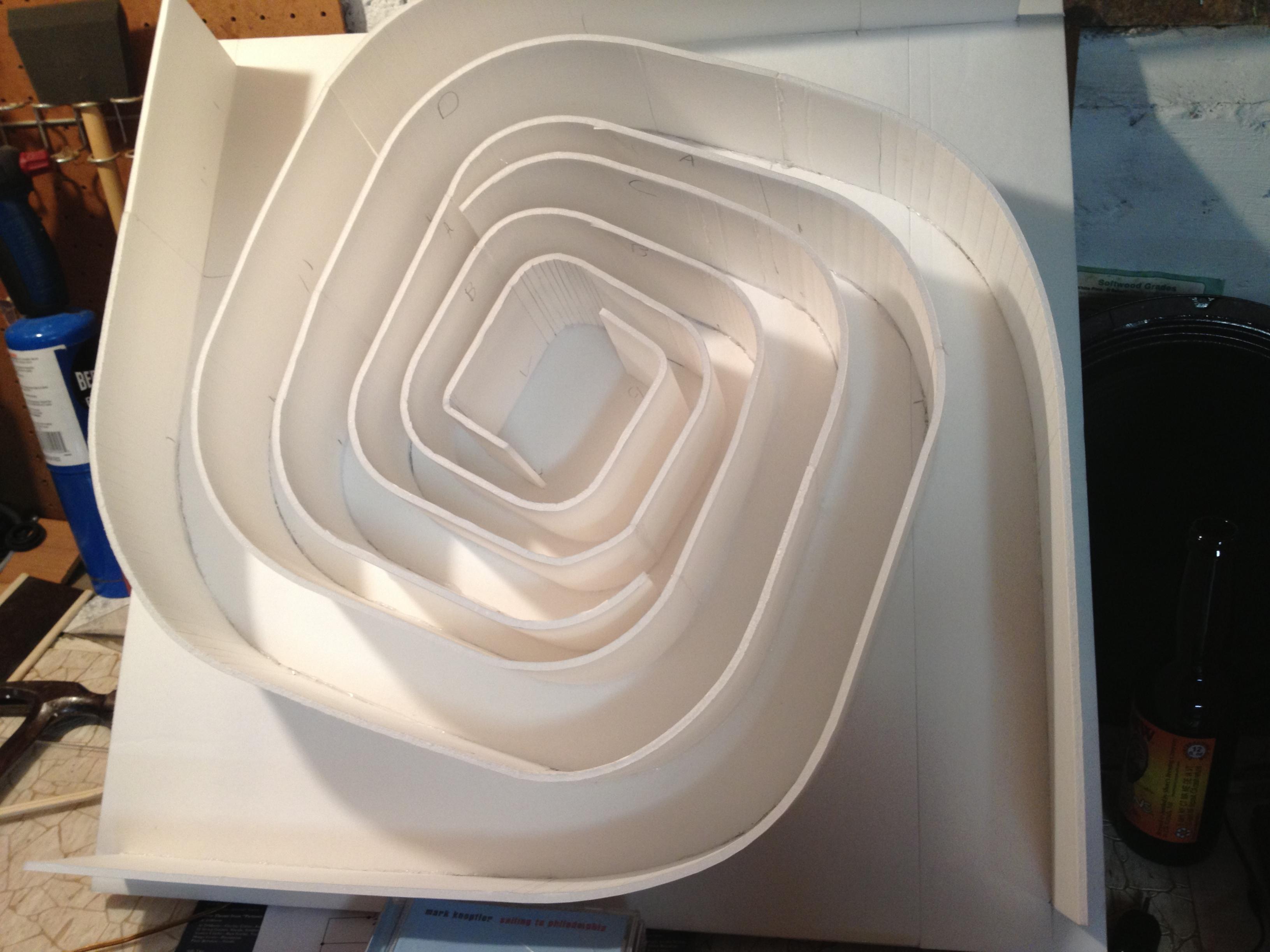

Ever think of building a Cornu Spiral horn? Now you can!
Mr. xrk, I got some spare HiVi B3s. Are they good for your 20 inch design ? I shall keep the
throat 3 x 1.2 inch. Since they are heavier, I guess double foam core board for the panels is
required.
Another question, what is the major difference between the foam board used in the cartoon boxes and
the foam core board ?? Can I strengthen the foam board by sticking the self-sticking wall paper ??
Kambule,
The HiVi B3s should work just fine, I would reduce throat a bit to match 30 cm square Sd.
Two layer foam will be strong, not sure if needed. Can always add if you do. Wallpaper won't really add strength unless it is thick and adhesive is strong.
The foam used to pack things in boxes is typically expanded polystyrene beads (little white balls) that are fused together into a shape with a mold. It is also used to make insulation panels, as I learned, from Bob Brines and Cal, and is called "bead board". The foam core boards that I use is a closed cell foam that is formed between two sheets of paper to give thickness and strength to the paper face. I think this foam is formed by a chemical process that generates gas bubbles to expand the polymer (rigid polyurethane) rather than beads fused together. Here is an example of the type of foam boards that I use: Elmer's White Foam Board | White Foam Core Board 20" x 30"
I picked up my foam core today and plan to start this weekend. My build will be a 24 inch, 3 deep, Vital Tc9, and wood front/back.

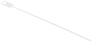

One thing that strikes me since stuffing is so important...why not use a Zip-it to pull out the stuffing if you have too much? Those things pull amazing hair balls out of a drain...
Recurve,
Good idea, we have discussed attaching string to the stuffing in a mesh bag to enable removal. A foam core back also allows surgery to cut small windows to adjust foam. I found that contact paper works as great temporary seal tape for foam core to allow stuffing test before final glue.

I got a reply to my PM to Hersh (Sebastien Pitkanen). He said that when he did the cornu, he talked to Daniel and the double layer plan with the semi-curved design was supposed to be the final optimized design. Apparently there is supposed to be something to that design and having 8 flow channels or horns that makes a difference. It would be interesting for somebody to make an exact copy with two layer horn in foam core in the full 70 cm size and use recommended driver (Monacor or FE108Esigma) and do a measurement. Anyone have a FE108ESigma handy?
Just to clarify, this was essentially the same as the current cornru dimensions, just with the addition of the divider and the math to adjust accordingly? It is not double the depth, correct?

The commercial Cornu uses the same plan as posted by Hersh and later redrawn by Planet10. The depth is 5.5 inches I think for both layers but there is a 0.4 in thick divider. So the actual flowpath height for each channel is 2.56 in deep. So it is like building two 27.5 in horns with a 2.56 in deep set of channels per side then capping with two facers. Of course the middle board has to have a big hole in it.
