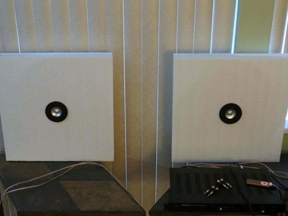

Your edges and cuts look very clean. How was it building in all foam this time? And you are killing me with anticipation.... how do the Jordan's sound in the spiral?
Looks fantastic! Congrats
Thanks X,
They sound better than in any other box I've tried. There's actually a hint of bass. 😉
Is it my imagination but those Jordan's resemble Mark Audio's in frame, cone, and terminal locations. What is the Fs of this driver?
Other way round. Mark used to work for Ted Jordan before starting Mark Audio. The drivers are old enough that I can't find much on them but this is about the 3rd generation of the 50mm cone drivers. There is only a surround, no spider so you have to be careful with excursion.

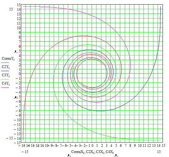

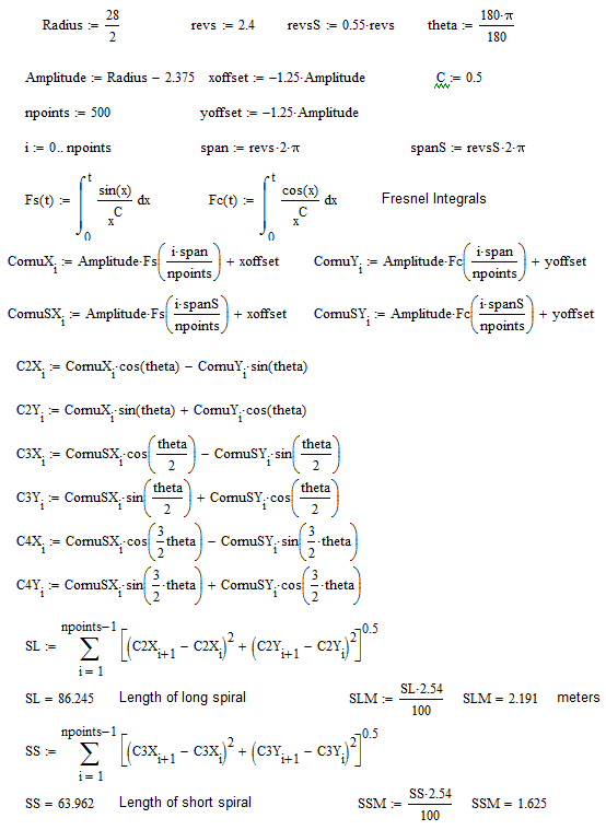

I was wondering what a Cornu horn would look like if we were to actually use the true Cornu function which is also known as a clothoid. The cornu spiral is defined by the cosine and sine Fresnel integrals in the complex plane (x is real and y is imaginary). I worked this up in Mathcad with inputs for speaker exterior size (in inches) and the number of revolutions which then controls the length of the paths. The true Cornu spiral function has a much tighter spacing near the middle between channels and has an expansion that fully uses the entire edge of the speaker. So for a 28 in x 4 deep speaker, the horn mouth area would be 28 x 4 x 4 = 448 square inches or about double what the current design we are using. However it has much smaller throats (about 0.25 in wide) and a larger driver chamber. Note that the throat area is then about 2 square inches which would make the expansion ratio for the horn 224! Attached below are screen shots of the code in Mathcad and the resulting plot of the channels for a 28 in speaker with channel lengths of 2.2m and 1.63m - the two distances needed to help fill out bumps and dips in horn resonances. One can vary the spacing of the spiral to make it collapse to the middle quicker to widen the channels by adjusting the constant C. However, when C is not 0.5, the function is no longer a true Cornu spiral.

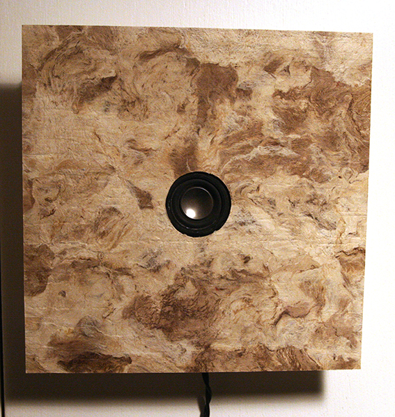

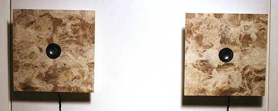

Well I have finished the babies. They are 7 1/2" square x 1 1/8" deep. Using a cheap little 1" 4om driver and I can't believe how good they sound. The shrillness is gone since sealing them up and the bass is quite good listening to some string quartets. Cello is full and smooth sounding and the soprano is great without any shrillness. I've matched them up with a little 8 watt TPA3110 amp from Sure running on a 12v battery. It's really quite amazing what a cheap little speaker can sound like.

Awesome job, they look great! What did you decorate them with? I really like the look. I saw some similar 1 in aluminum concave cone pc speakers the other day for cheap. Now I want a set for my office. This is about the right size. 8 watt amp is pretty overkill for these babies, no?

xrk- Thanks for your encouraging comments.
For the front panels I mounted a heavily textured hand made paper on a piece of matte board. I cut it 1/2" all around bigger than the boxes to give the a sense of floating off the wall.
