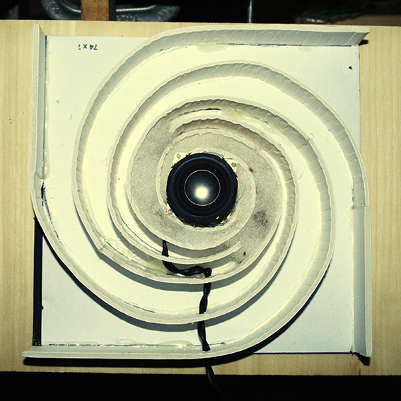

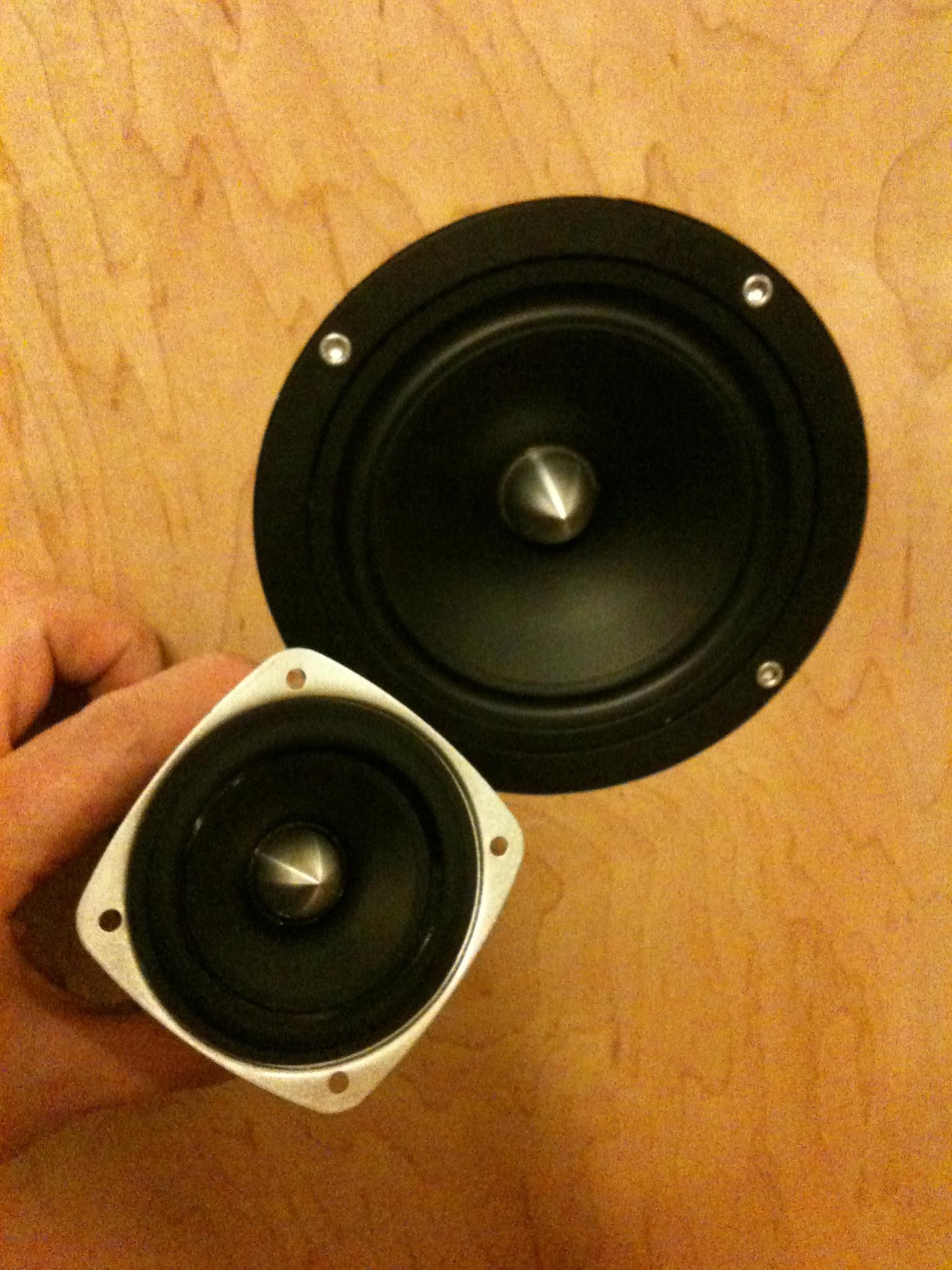

While waiting for the drivers for my 18" Cornu I decided to make some babies. They are 8" square with channels a bit over 1". Right now I have only done 1 to see how it would work out. The driver is a crappy one I pulled out of an old portable iPod box I had lying around. I hope to replace them with some Aura NSW1-205-8A's. For these ones I used Cal's rounded curves as they were much easier to fold.

I am thinking the same thing. I have some LG drivers and some Jordan 6T's that I might have to throw into the ring.For these ones I used Cal's rounded curves as they were much easier to fold.
Cool! New record for smallest Cornu. How do they sound?

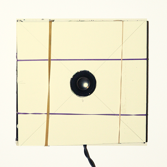

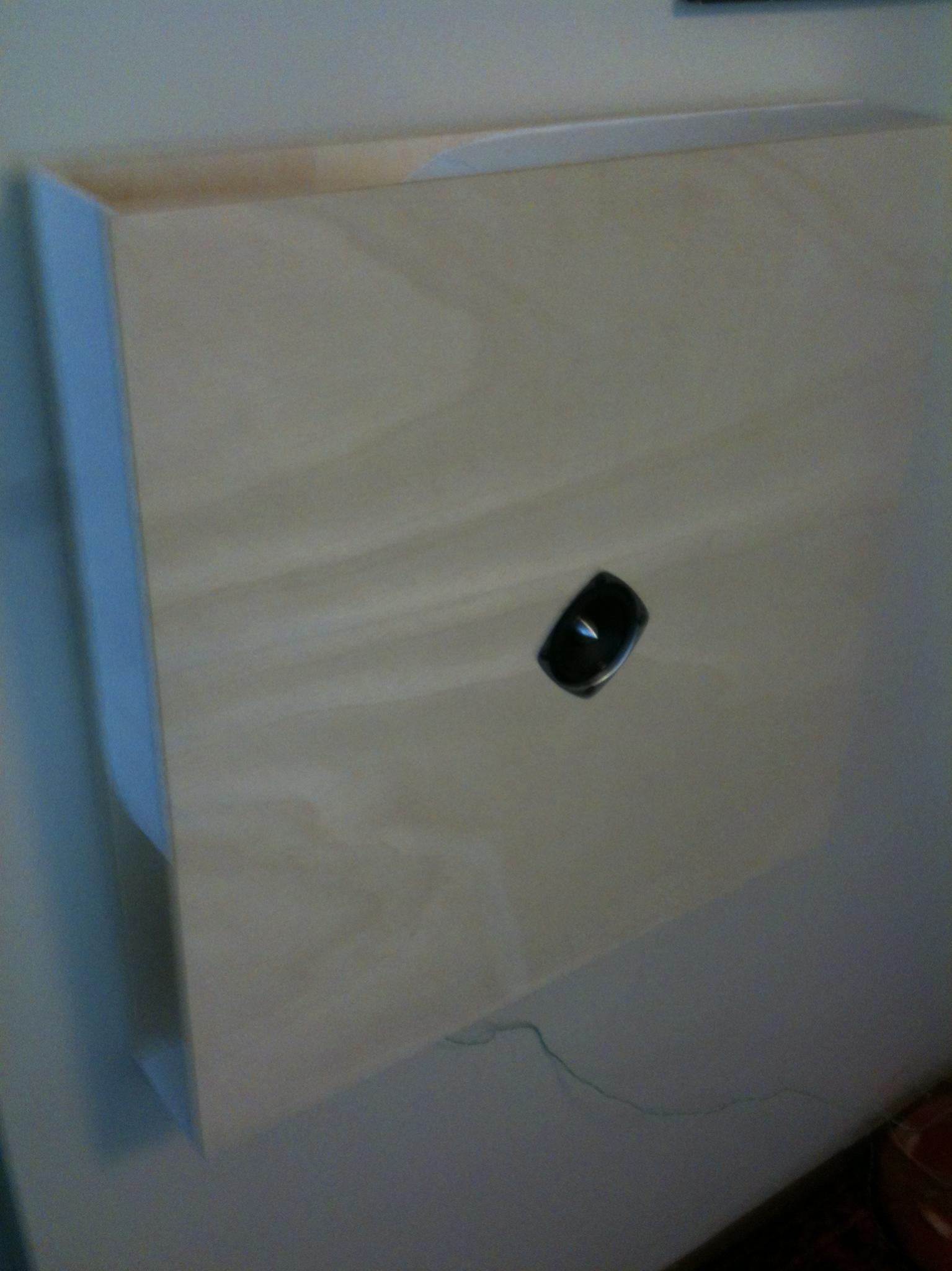

I've built the second little 8"er and got them up on the wall. They are held together with elastic bands right now while I test them. The best word to describe the sound is shrill. Listening to some string quartet music the soprano really screams at you while the cello is kind of lost in the mix. This could well be the cheap little drivers that I put in there. I'm sure they would sound better sealed up properly with some better speakers in them.
I bet it is because it is not sealed. The leaks will kill any bass from the horn. Glue them and try again, the drivers should work fine.
Would it help to take some of the dampening out? Right now the centre chamber is stuffed and the inner channels up to where the second channels begin.
On a different note: I tried scoring the foam board by making shallow cuts with a t-square about an 1/8" apart across all of the channel pieces at once then cutting them to width after. This way the curves were pretty much the same on all the baffle pieces. Seemed to work pretty well 😉
A little driver like that only needs some stuffing in chamber. Take it all out of channels.
