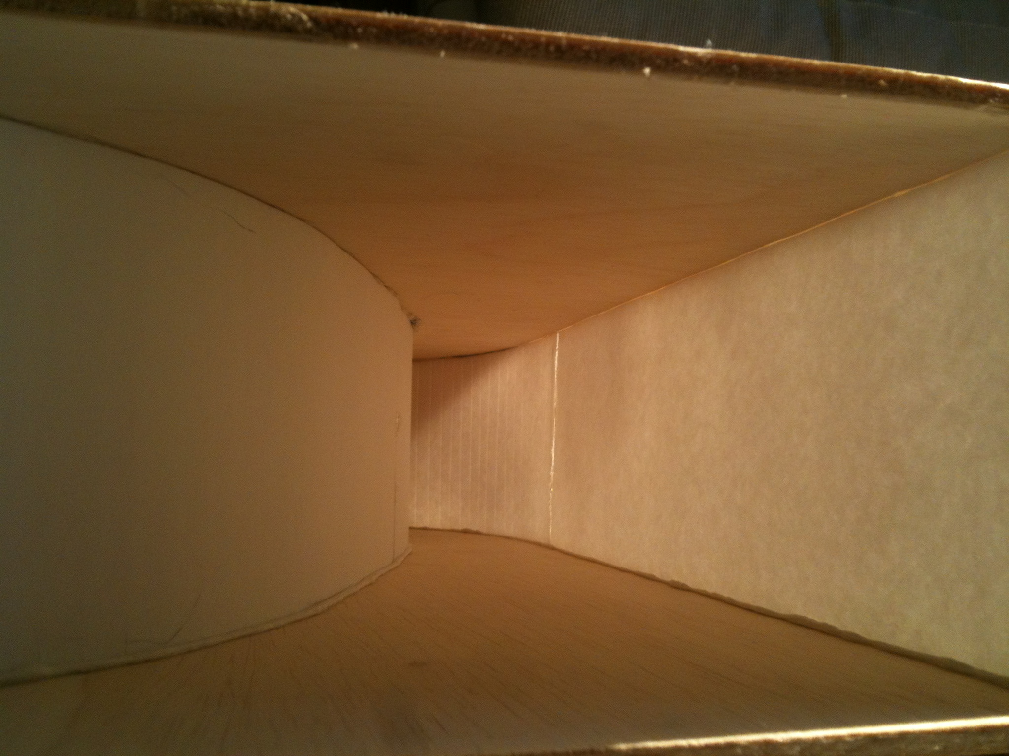

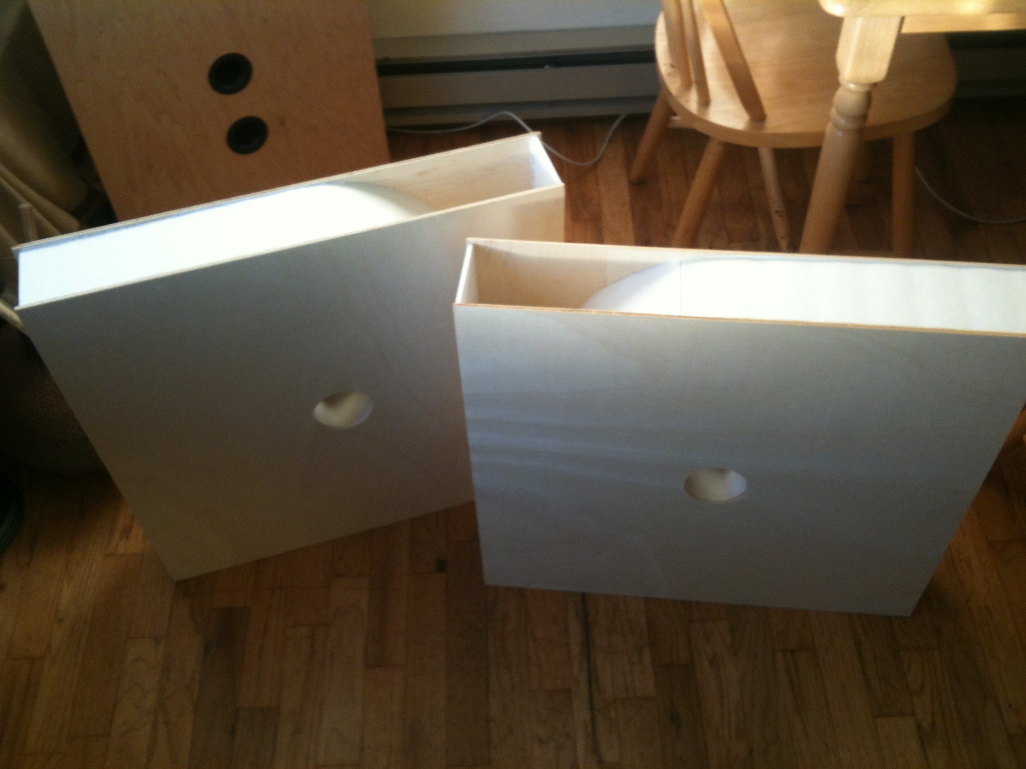

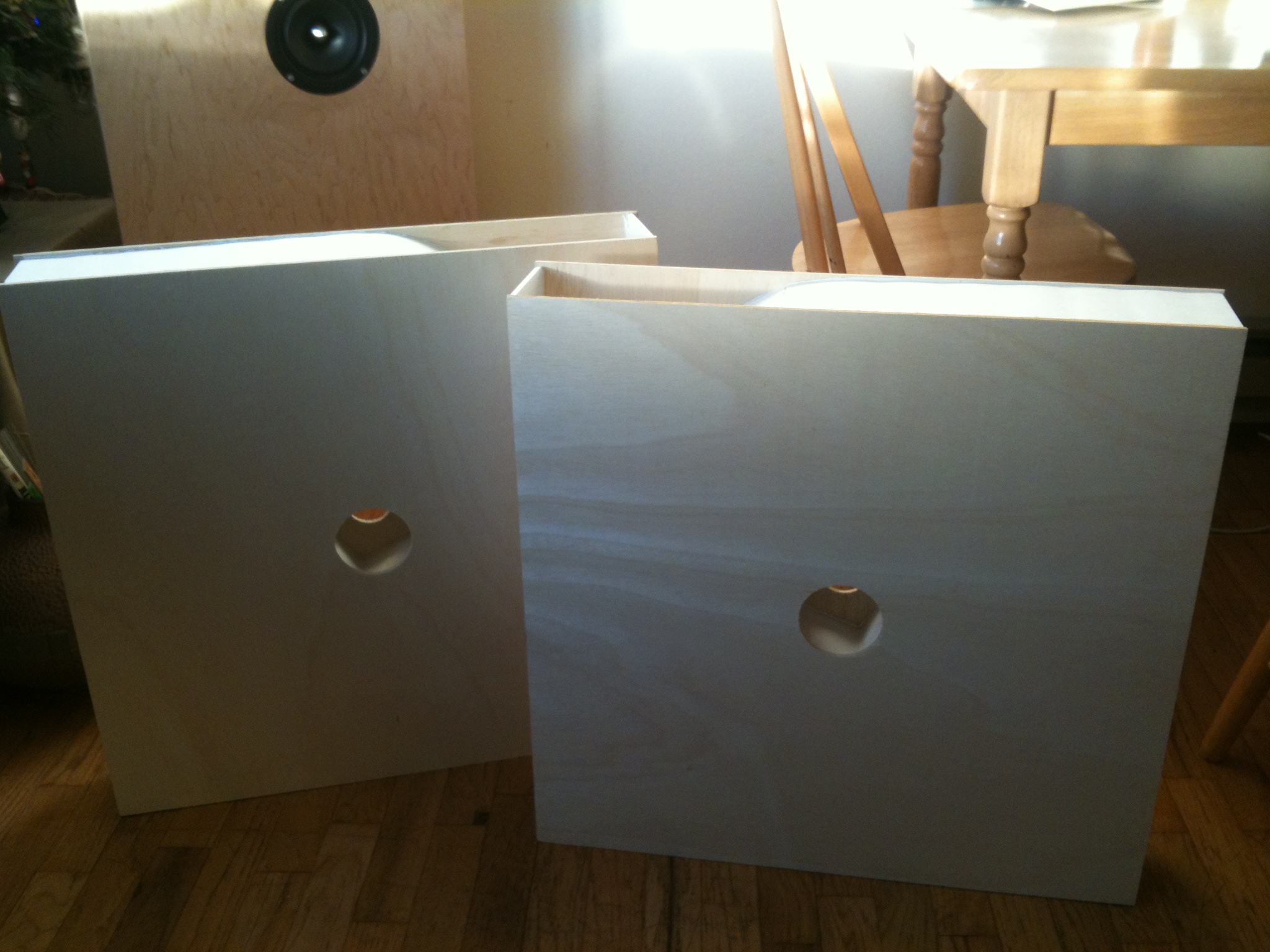

Good news, folks: my cornus are all sealed up and ready to go. All I'm waiting for now are the drivers and terminals. 🙂 I even bought some wall mounting hardware. Drivers are due to arrive on Thursday, so stay tuned.
Looks great Chaz. Hopefully the drivers will arrive when expected. Can't wait to hear your thoughts.

It's 1/4" plywood but I don't recall if it's birch; it was the cheapest plywood I could get. 🙂 It's 24"x3.5" depth (4" including the ply). The driver is the TB W3-926SDF. If I like these speakers, I might experiment with higher-quality drivers.Chaz,

Thanks xrk, I'd be lying if I said I wasn't hoping for good results myself! By the way, after the speakers are all assembled I will have them tested for frequency response and phase and report back. That may take a few weeks.
