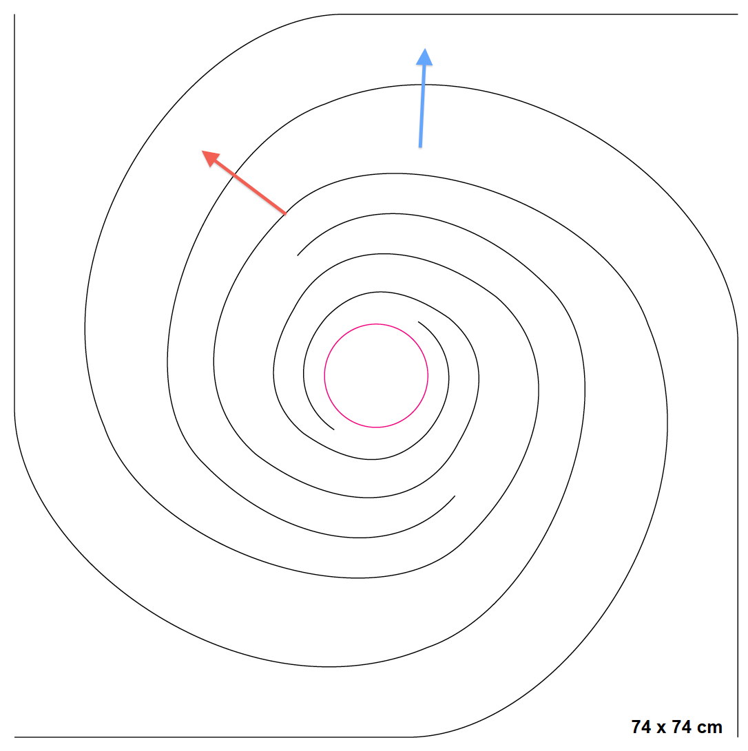

I had a look at the PDF I downloaded and I have some concerns. The channel is wider at the red arrow than the blue. Is that a problem?
Cal,
The easy fix if you are in a hurry is to hand draw the spirals to make the round parts transition to the flats in a way that the tangent (slope) is zero. This can be done by moving the square external boundaries out to allow for more expansion of the curved part. It probably doesn't make too much of a difference.

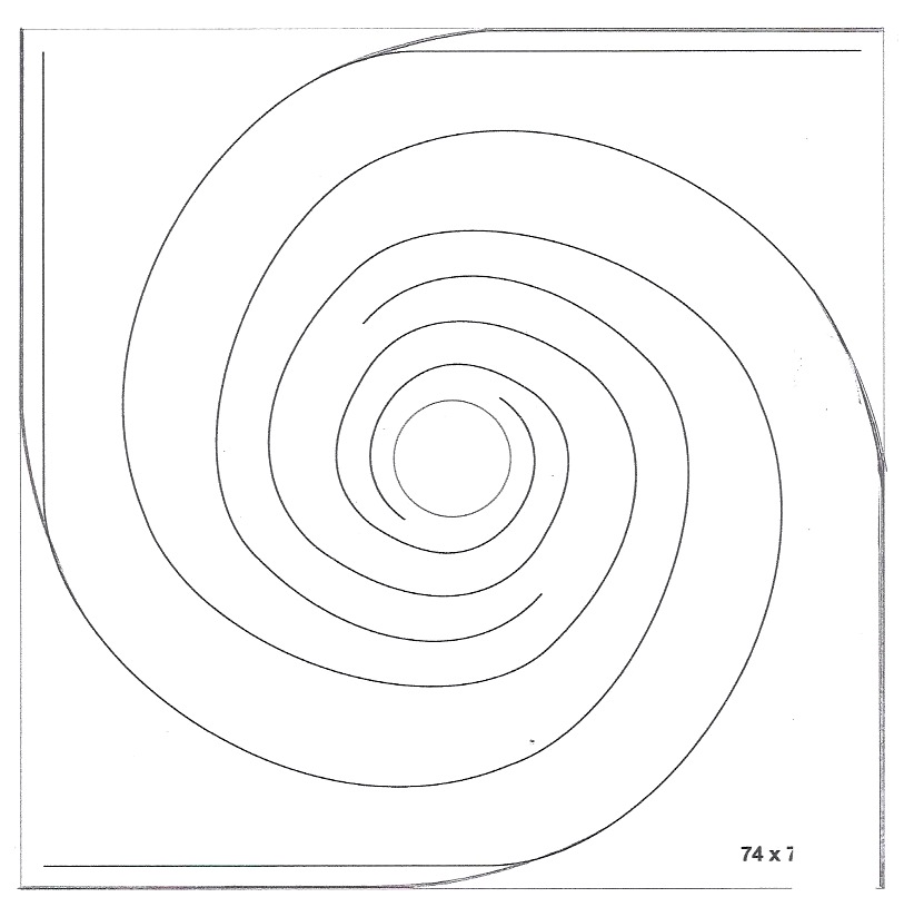

I have done a hand rendering of the new curve for the spiral drawing so I have something to take to the repro place. Wasn't that hard, just continued the curve to the outside of the page and it eliminated the narrowing near the mouth. Crude but usable.

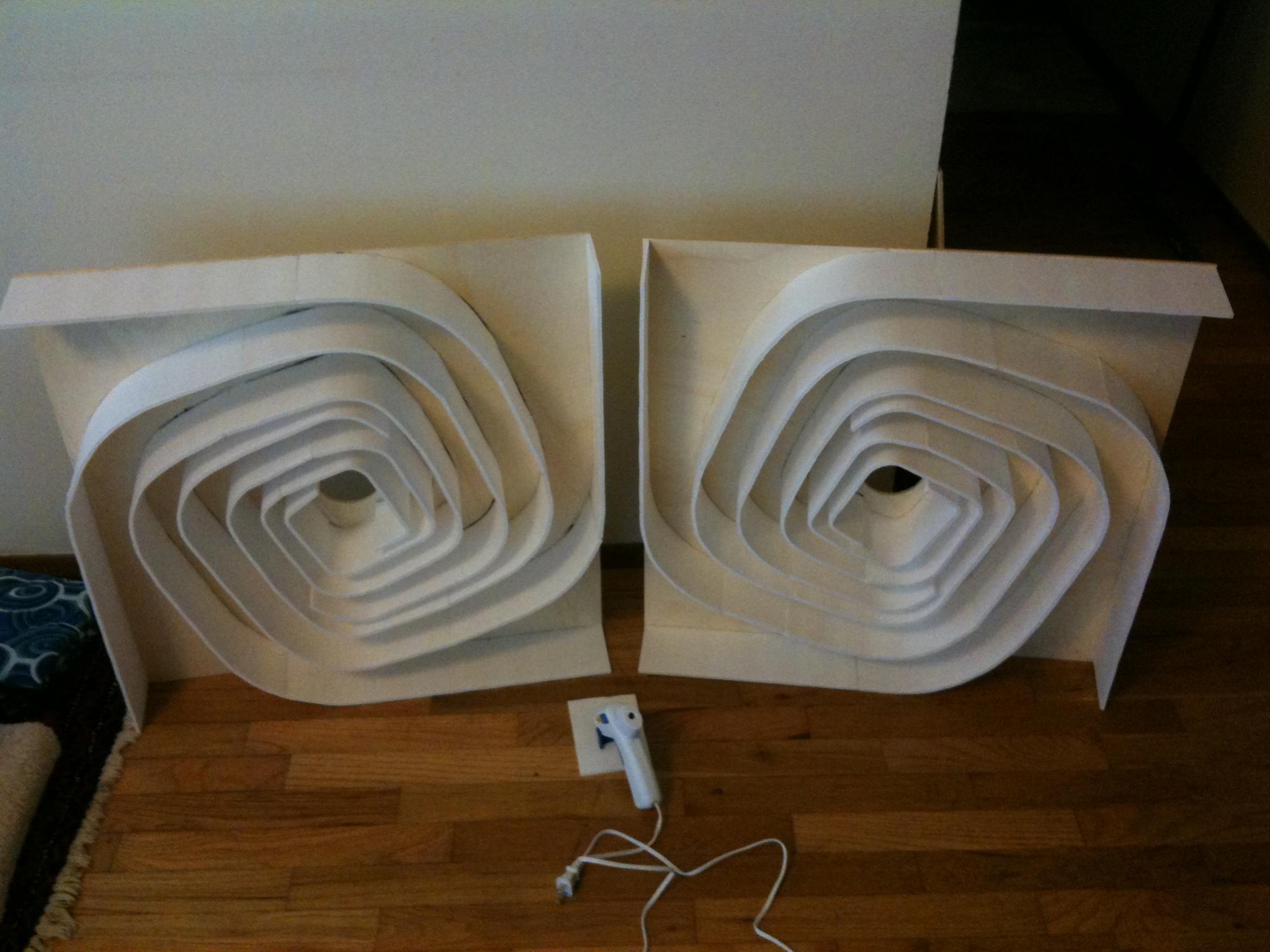

Okay, some progress has been made. I'll admit that getting started was a bit tricky, but I got much better as things rolled along. Unfortunately the chamber and horn throats are a bit crude but there's no going back now. 😱 I haven't even checked how far off the throats are from spec (11/16" by my reckoning, for my driver).
Next is to stuff the horns and glue the backs onto the cabinets. I may or may not wait for the drivers to arrive before I do this...
that was my mistake! i hadn't pay attention to channel wideness while i was focusing to curving lines..
i made one more drawing just for experiment to get truly spiral paths which can be adjustable for scaling..
btw, i don't want to cause any mess about pdf files and this is the original cornu layout for who wants to build the original;
