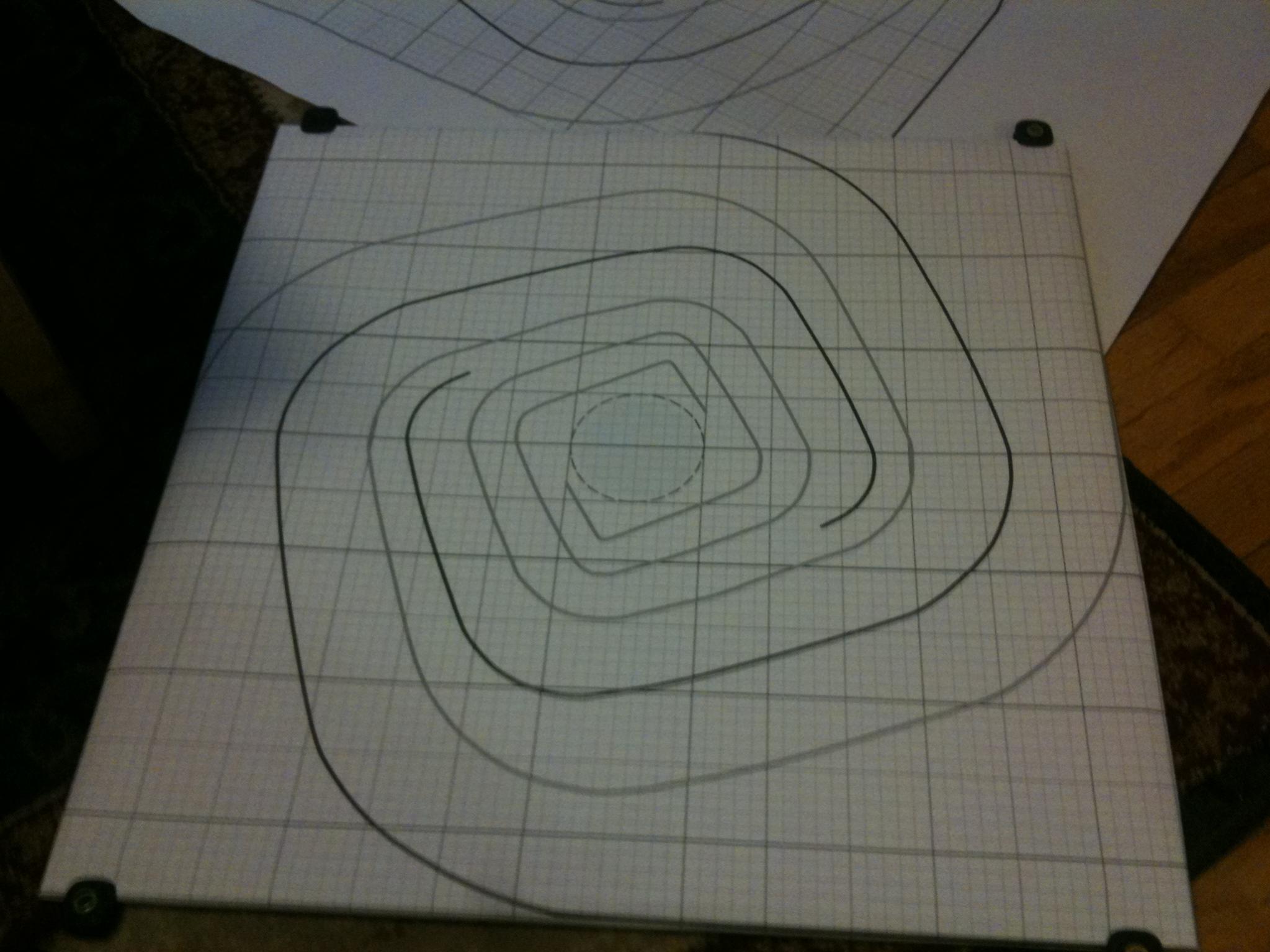

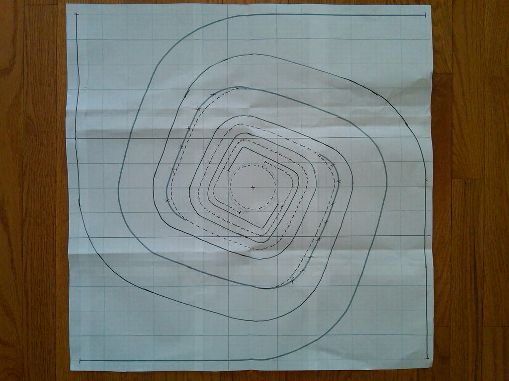

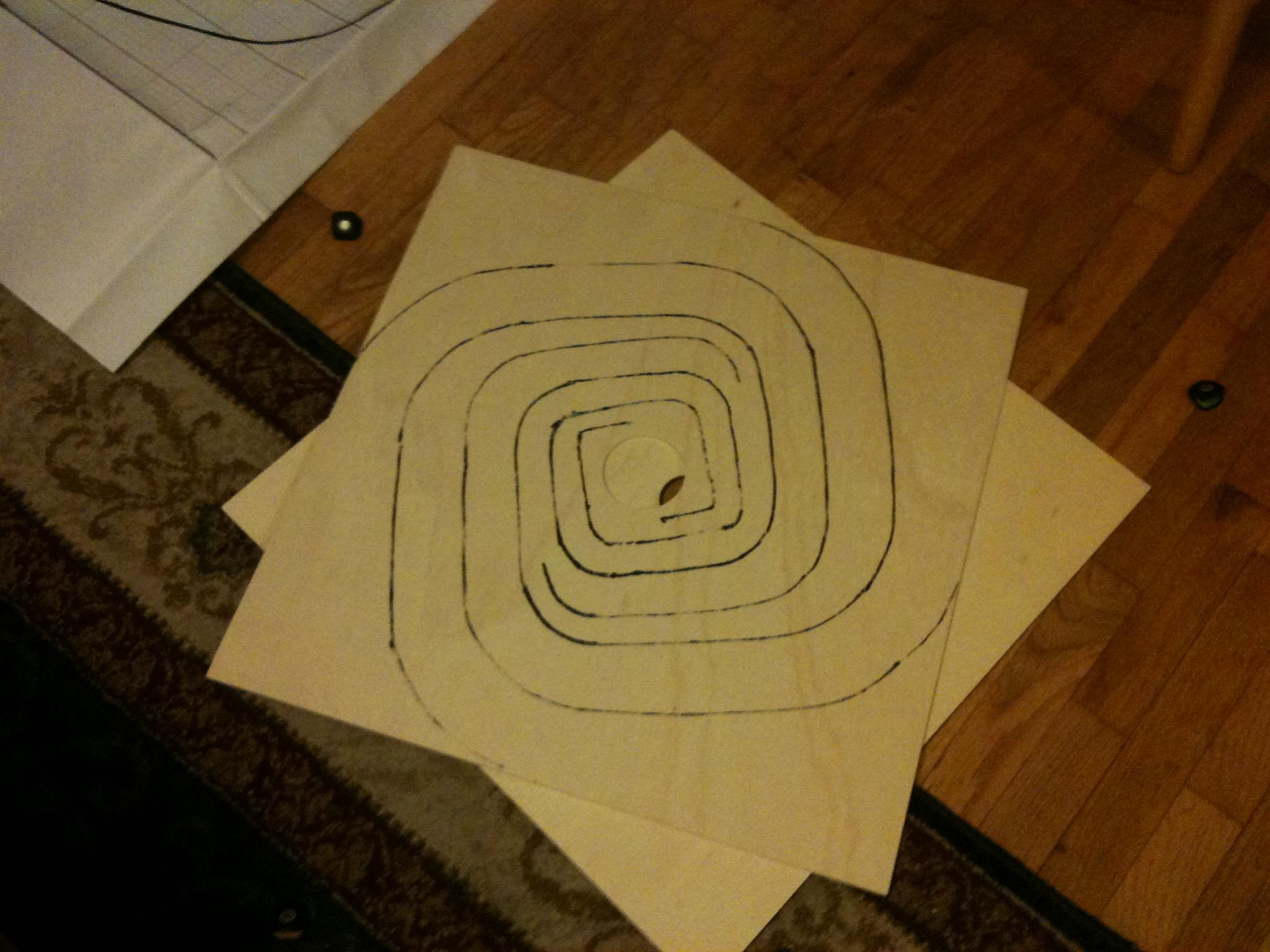

Yesterday I got the design printed, then I copied the pattern onto the baffle with a heavy marker. Images below. My drivers aren't coming until the 3rd so I have some time to get around to gluing. I also bought some polyfil to stuff the chamber and the first third of the horns. Since I'm planning to glue right up, I will only have one chance at horn stuffing; should I err on the side of too much than too little?
Chaz,
Great that you are warming up your glue gun now! You might try gluing a string to wad of stuffing and leave string hanging out to adjust or remove. Might need to put stuffing in cheesecloth sack to pull out. Good luck!

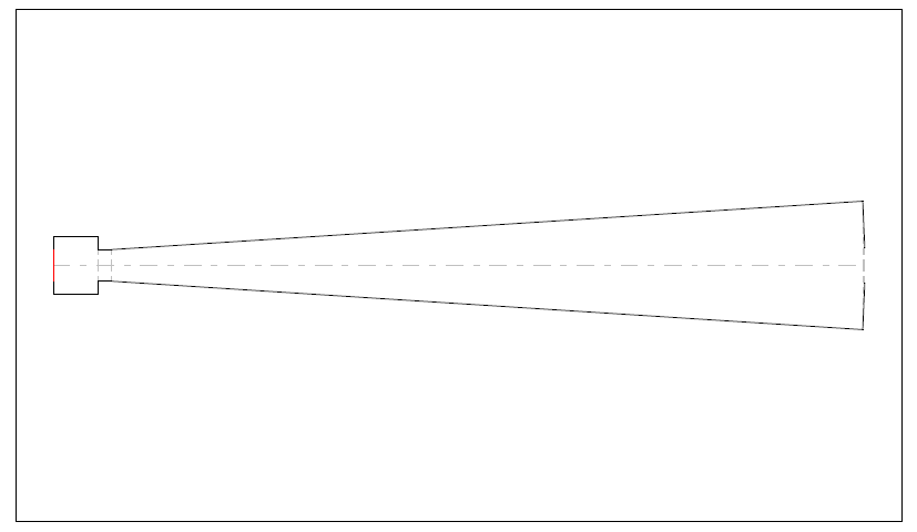

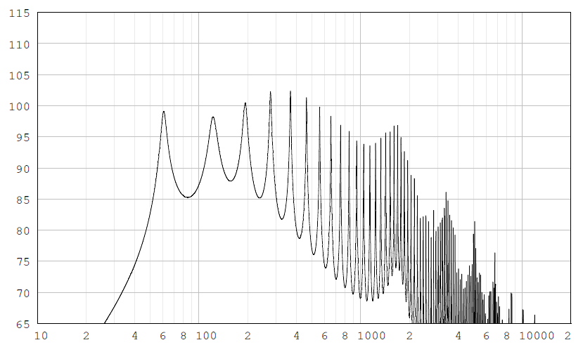

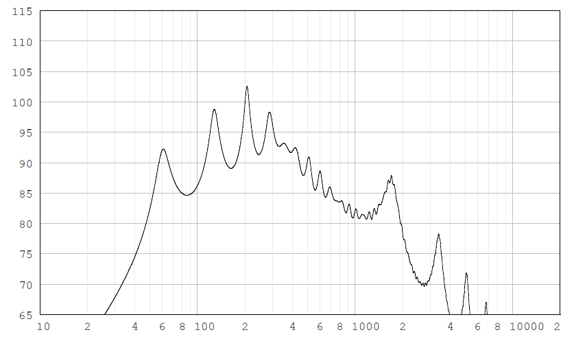

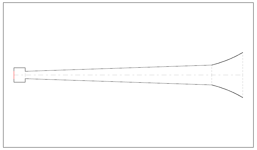

I am testing different horn designs in HornResp and going off-design from original Cornu now. I started with a clean slate and tried various horn profiles that will produce deeper bass extension while having relatively even levels of peaks in the mid-bass region that are equivalent to the main low bass peak. The thinking is if they are even they can be attenuated and smoothed out with stuffing to match the characteristic SPL curve of the driver. The constraint is that it must be rolled up in a spiral and start from a driver chamber. What I ended up with is a linear conical horn with a restricted terminus to both reduce the bass gain, and to pull the bass extension lower - essentially a mass loaded transmission line. This design can be made without curves, and in fact I think use of straight sections only will provide excellent filtering of the HF resonances that the horn produces. My fear is that due to the abrupt terminus with a restriction, the way the sound exits the edges of the cornu and fills the room may be compromised - it may not have the magical wide image as a result.
The simulation assumed a 4.5 x 4.5 in x 4 in deep driver chamber with 4 paths leading out starting with a 0.4 in throat (each) to a 6.34 in mouth that has a restrictor plate capping it to allow only a 0.5 in wide x 4 in deep exit vent (each). The overall size of the horn rolled up is about 31 in x 31 in x 4 in deep. Quite a bit bigger than the original cornu, and this is only for a smallish 4 in driver (Daytion RS100).
Attached are the schematic diagram of the HR design and SPL simulation. Please let me know your thoughts on this approach. All wrong and ruins magic of the curved bell mouths?
Mass-Loaded Voigt. You can reduce the ripple by tapping the driver in part way down the line (Hoe you would do that phyisically is a different challenge.
