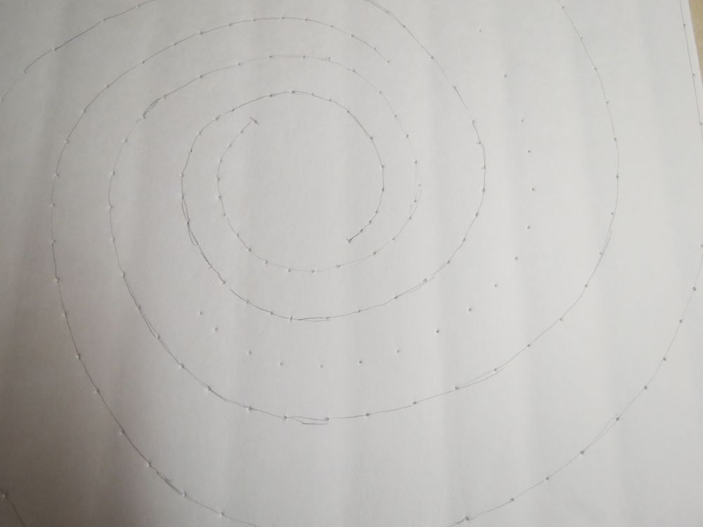

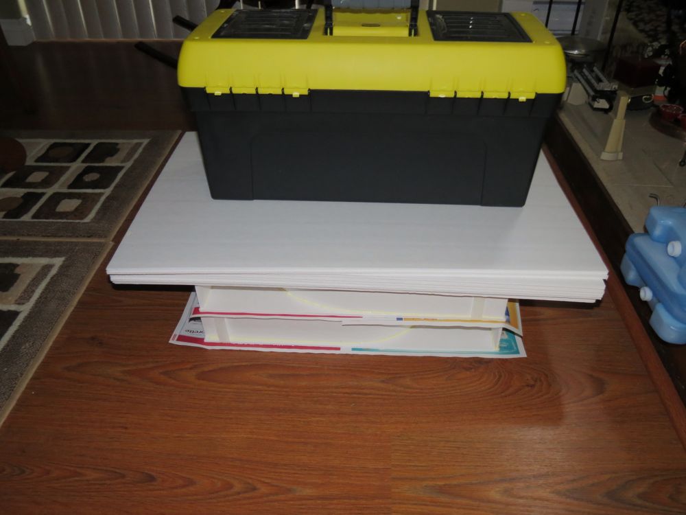

Long live the spiral horn! This time the 50cm.

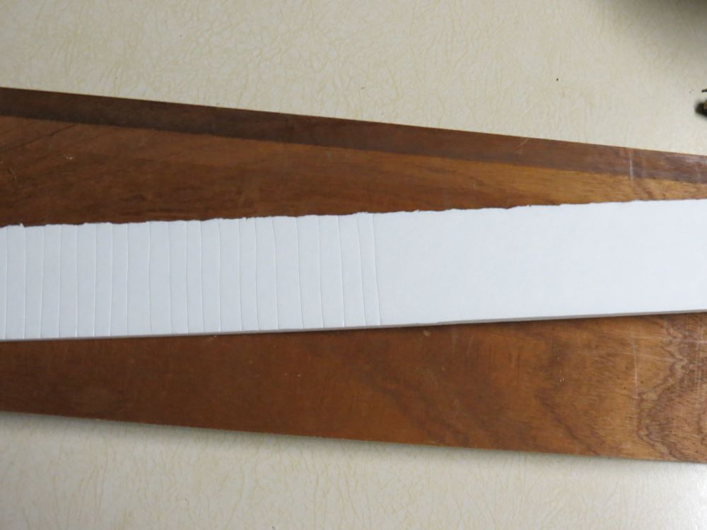

I really do like the speed when you poke holes and do a rough hand trace. And you can see how many scorings I do for the looser corners, about twice that many for the inside near the chamber. She's all glued and waiting for tomorrow.
You can see I still seem to have some sheets leftover, hmmm... Mind you my wife gave that look when I told her what I was doing last night and today so I had to use the old - you're right honey, I'm gonna call up some buddies and go hang out at the strip bar instead. Suddenly she took a keen interest in speakers again. I love my honey 🙂

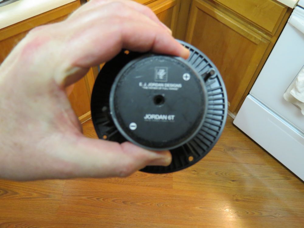

These are the Jordan 6T's that I plan to try.. The channel depth is 5.8 cm and the width at the throat is 2 cm.
I have always wondered what Jordan's would sound like in a cornu. Based on your channel depth and throat width I assume the Jordan's have Sd of 23 cm^2? That Sd may be a little small for driving a 50 cm as we may be seeing this effect on Chaz's build as he is using 30 cm square Sd on 24 inch cornu. The Vifa has 36.4 cm sq Sd. Which plan did you use - endia's curvy one?
If I measured correctly it's 27 cm^2 for the driver and who know how close I was on the actual throat openings. Tomorrow's honey-do-list looks clear until about noon so maybe I can give them a test.

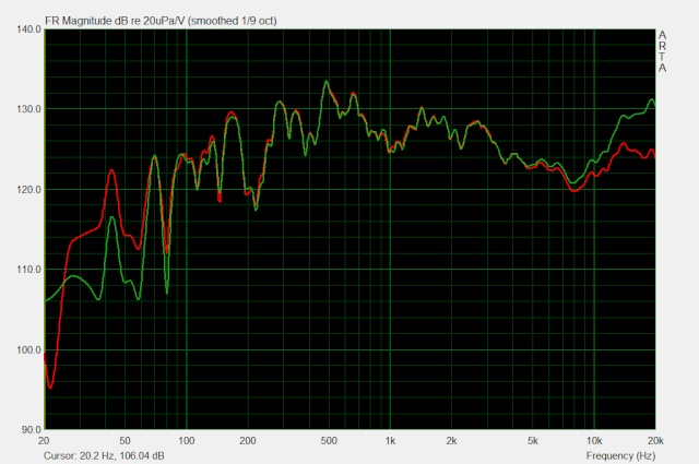

Some measurements.
Loudspeaker hung on the wall, 170 cm (5.6 ft) from the floor, 140 cm (4.6 ft) from the ceiling, microphone (not calibrated) at 1 m (3.3 ft), gate of about 6 ms.
The red graph should be MLS, green the sweep.
Frequency response is more irregular than that posted by Pano (here) but the same notches at 50 and 200 hz are presents.
I cannot exclude I did something wrong, I'm not an expert in measuring loudspeaker.
PS: happy new year 😉

That is amazing that the little Fountek has output at 45 Hz.
Yes, it shoudn't 😛
I think it could be room reinforcement or environmental noise (or me doing something wrong).
PS: when I wrote my post it was a bit too late for me, in the graph posted by Pano there is no notch at 50 hz.

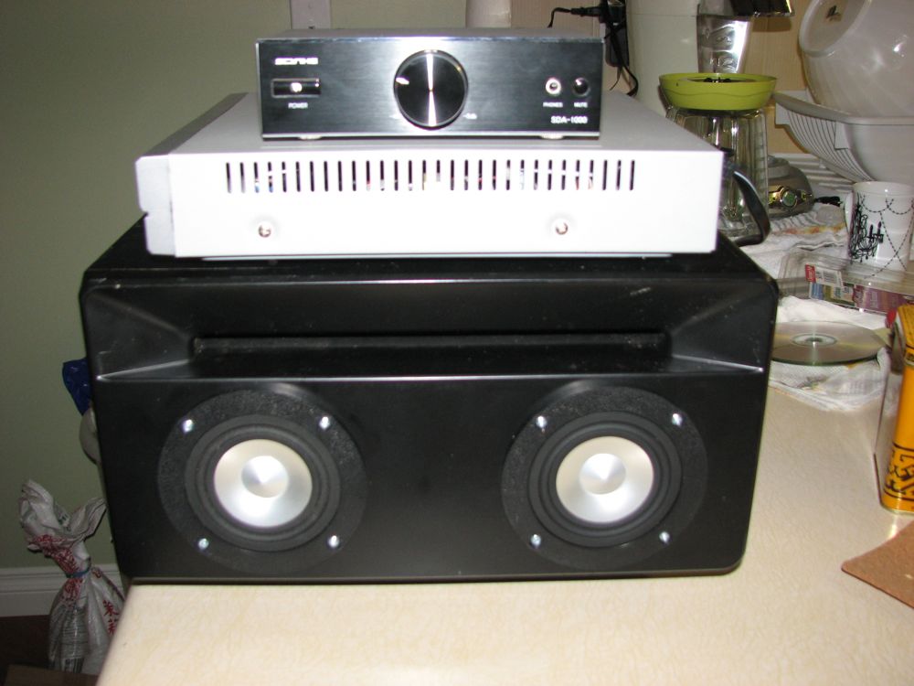

Xerxes,
Very nice build! I like your setup. How does the reel to reel tape sound on the cornu's?

Ah thanks! This is my little vintage setup which i love, the reel to reel sounds good and silence is silence...no cracks or noise. I must say I prefer my turntable but the Tape brings back good old memories.
The sound of the Cornu is still a little hollow but the longer I play the more the frs8 loosens up so I will wait with new stuffing.
I am curious at your horns, I will take a peak
