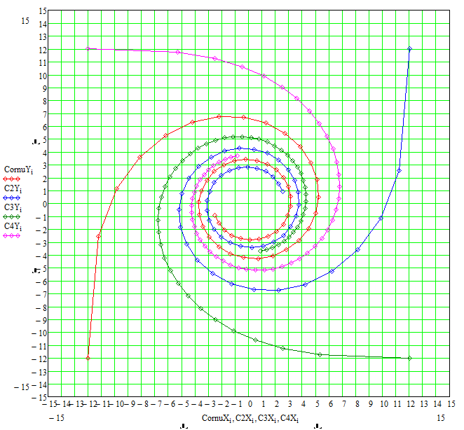

I was wondering what a Cornu horn would look like if we were to actually use the true Cornu function which is also known as a clothoid. ...
Nice work. Did you notice something something pretty significant? The resulting horns closely follow an exponential length/area law. You can model single-spiral (divided 4 ways) Cornu horns in Hornresp using a single exponential section, and the multi-length horns like the one in your post in AkAbak. I'll modify (simplify) my AkAbak model accordingly.

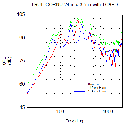

Don,
I have re-spun the cornu generator to make a reasonably sized horn than I can build: 24 in x 3.5 in deep, driver chamber cross sectional area of 148 cm^2, chamber volume of 1312 cm^2, channel lengths of 147 cm and 104 cm long, the throat cross sectional area (both) is 31.3 cm^2 - which will provide a mild level of compression for the TC9FD Sd of 36.4 cm^2. The horn mouth area is 2168 cm^2 I am still doing the bifurcation. See attached plan. I did a simplistic sim in HR for each horn independently and then combined them after the fact to see if the bumps and valleys help cancel out. I still plan to to use the TC9FD with this. I am still unclear how to specify the channel width as function of distance in Akabak for the true cornu. Thanks for trying this in Akabak.
Xrk971

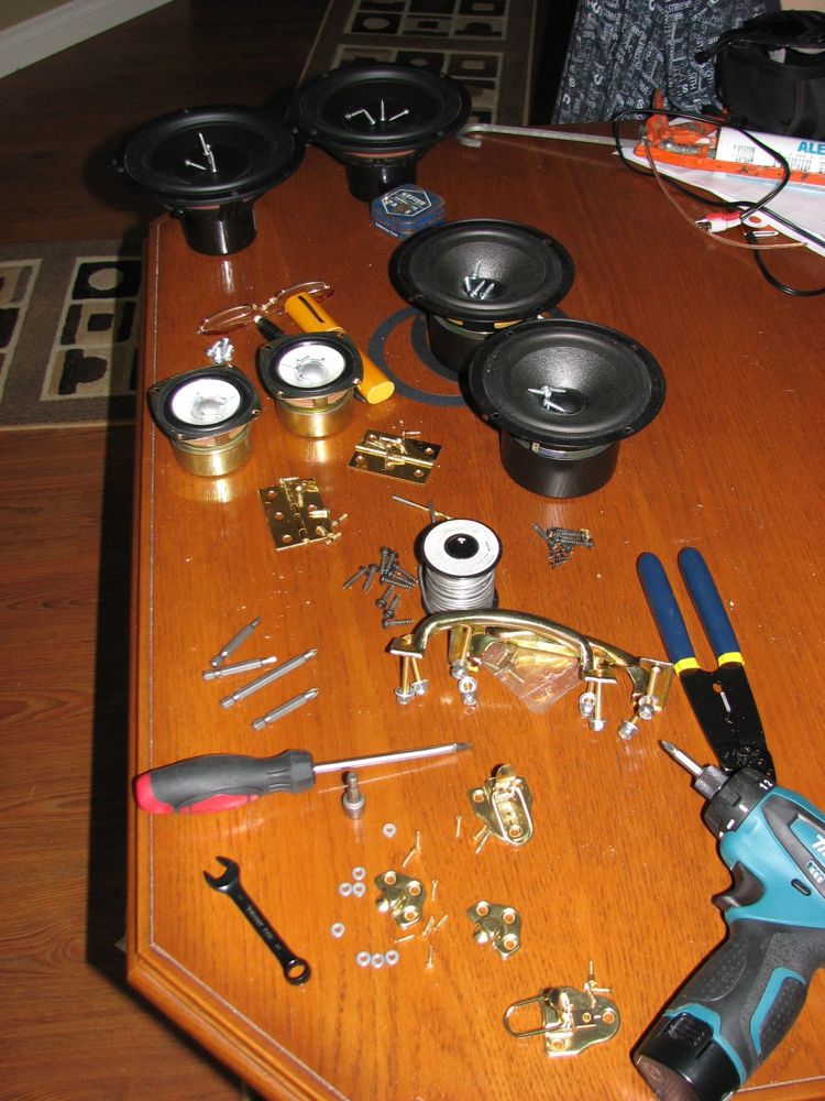

What are the LG's?
Short of pulling them out this seems to be the only pic I have of them. They were originally used as tweeters in the 'Toolbox' as it is similar to a FAST system.
Don't let my wife see this pic or I'm in trouble. I tell her I always cover the table.
