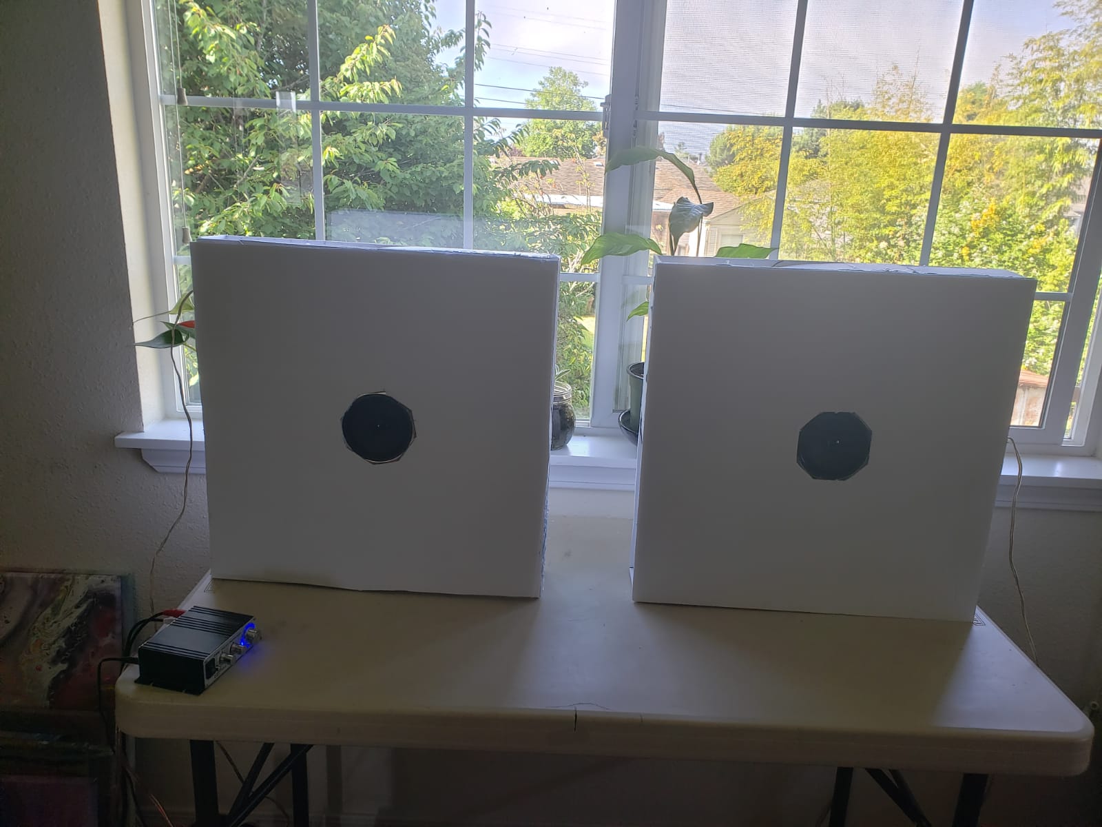

First time project finished: Upholstered Cornus

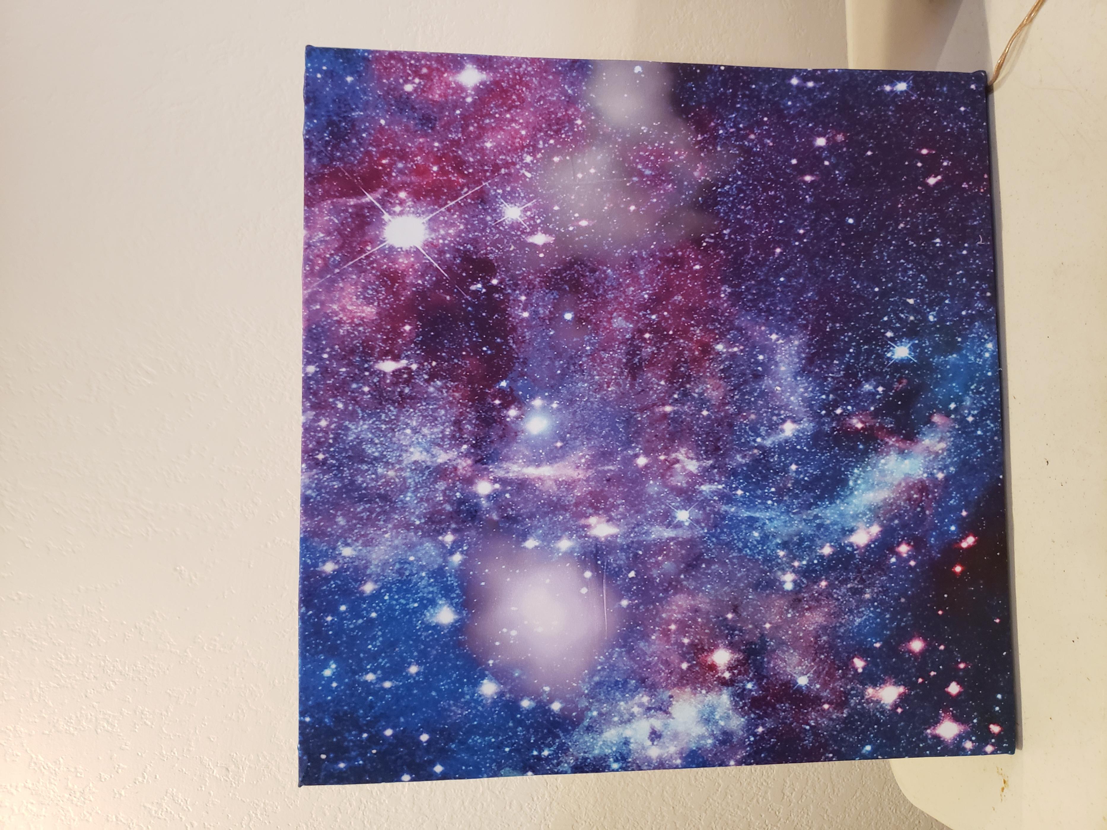

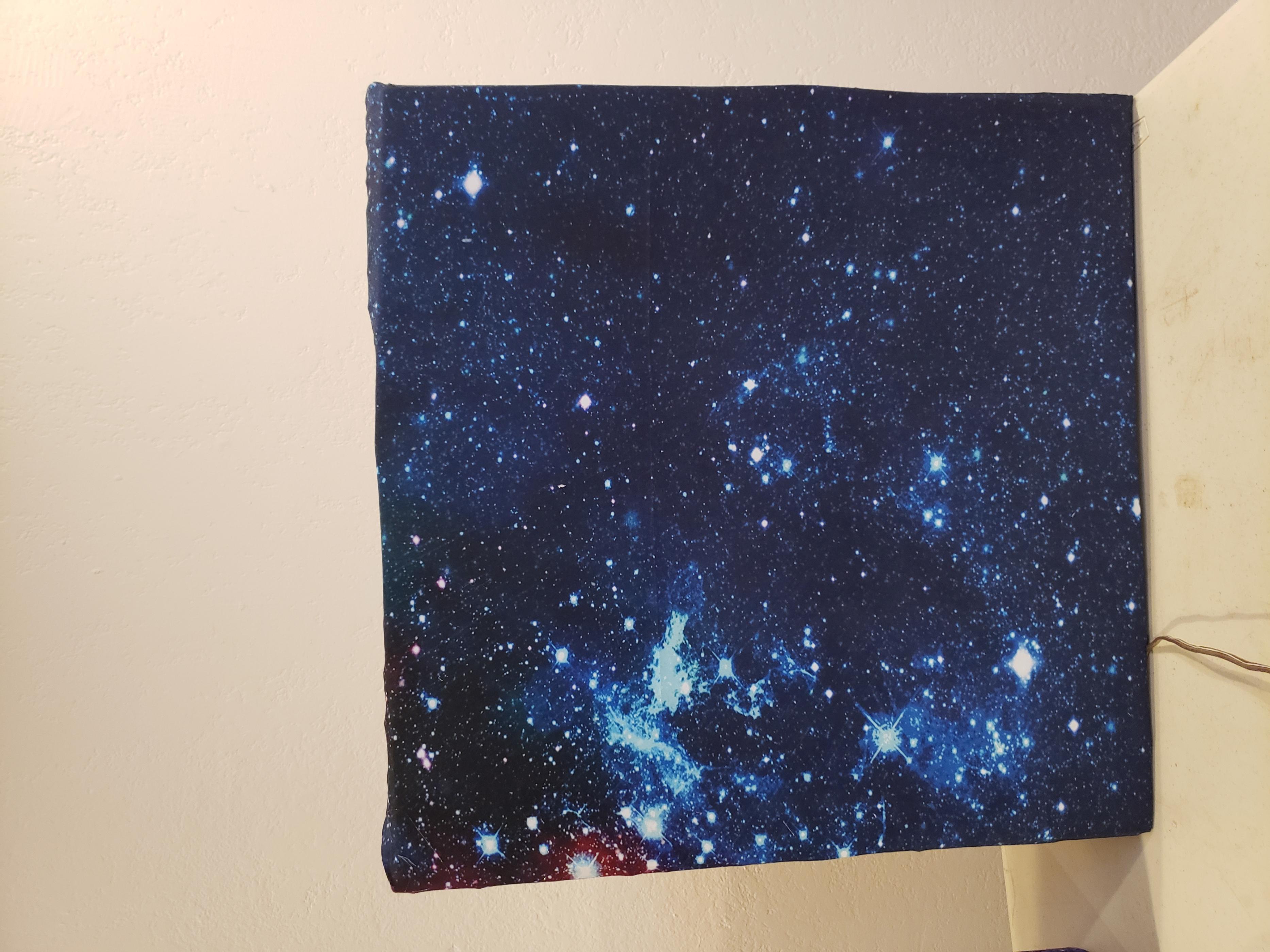

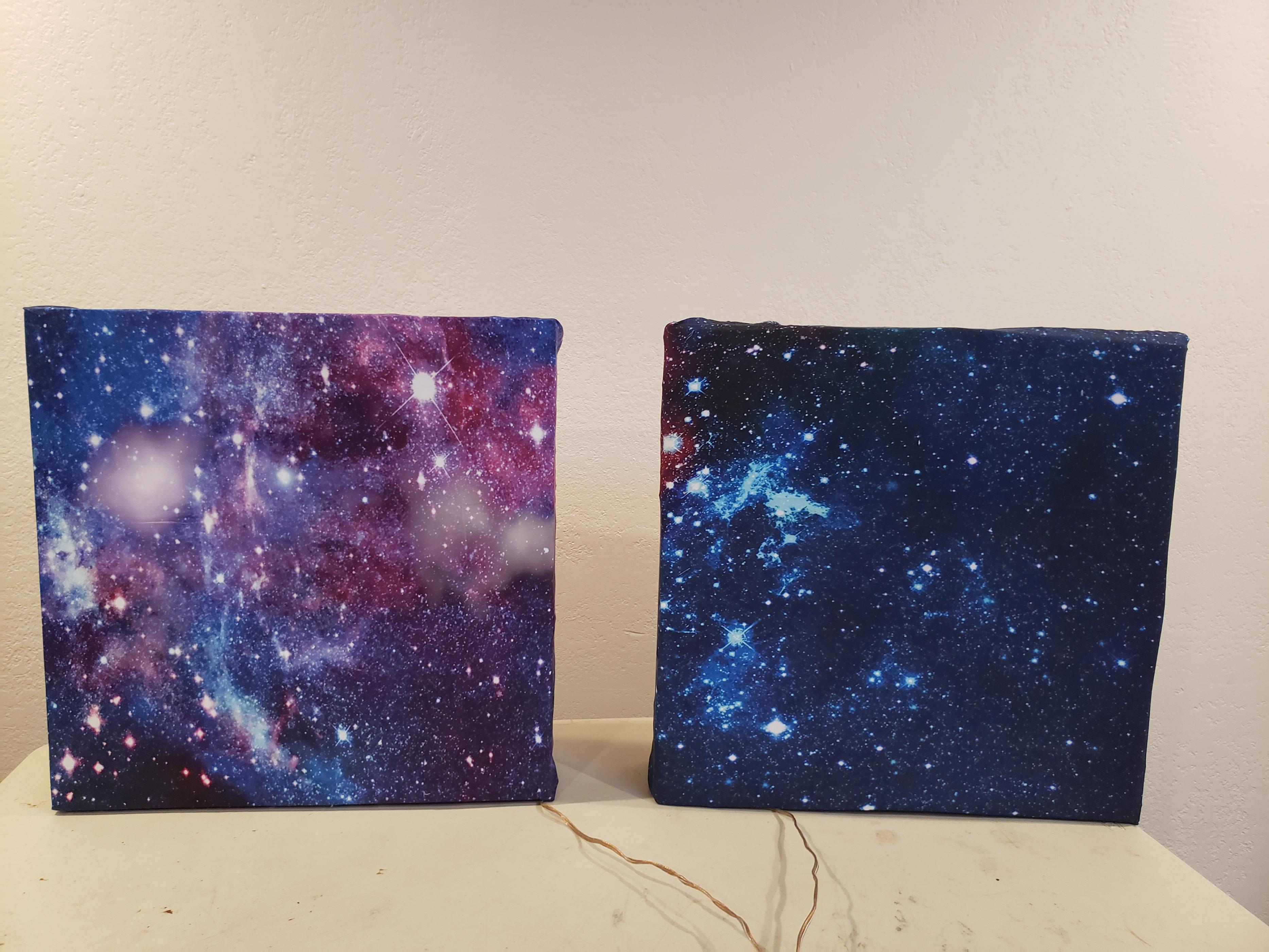

The cloth came in, so I was able to finish this project today:
Upholstered Cornu
Reasoning:
My girlfriend needed some speakers for her bedroom and the only real place available was wall mounted. These with a subwoofer have already gotten the lifestyle piece seal of approval from her.
Construction materials:
Foam core boards from Dollar Tree
Hot Melt Glue
PL300 Foam Board Construction Adhesive
Sublimation printed Galaxy tapestry off Amazon
Hardware:
Cheap full range driver from component stereo speakers I found on the side of the road
Polk PSW110 subwoofer that I purchased for $20 (with failed capacitor) and repaired.
Lepy 20w per channel class d amp.

Really Nice! Speaker or art???
So the driver is mounted flush on foam and fabric covers the driver front? Great execution. They look just like a wall hanging printed frame art. Very nice!
Same as these right? But now upholstery fabric Covered - how are the kids and highs coming through in the fabric?
Yes, these are the same and now covered in fabric.
It's not very scientific because I neither did a side by side or any measurements, so I can't tell how much the upholstery is dampening the speaker..
We did listen to them for over an hour while eating dinner, they were sitting on the carpeted floor angled a little up to our listening position. I kept forgetting that I was listening to hand made upholstered foam core cabinets with subwoofer support.
They sounded great, especially for what they are.
How acoustically transparent is the printed cloth you used? Can you see through it? They look really nice!
The fabric is fairly see through when looking towards a light source. I'm not sure how acoustically transparent it would be considered and I don't have the tools to measure it.
I did however use a different speaker and listen to a slow frequency sweep then put the cloth over it and listen to that same frequency sweep. I couldn't tell much of a difference to my ears.
