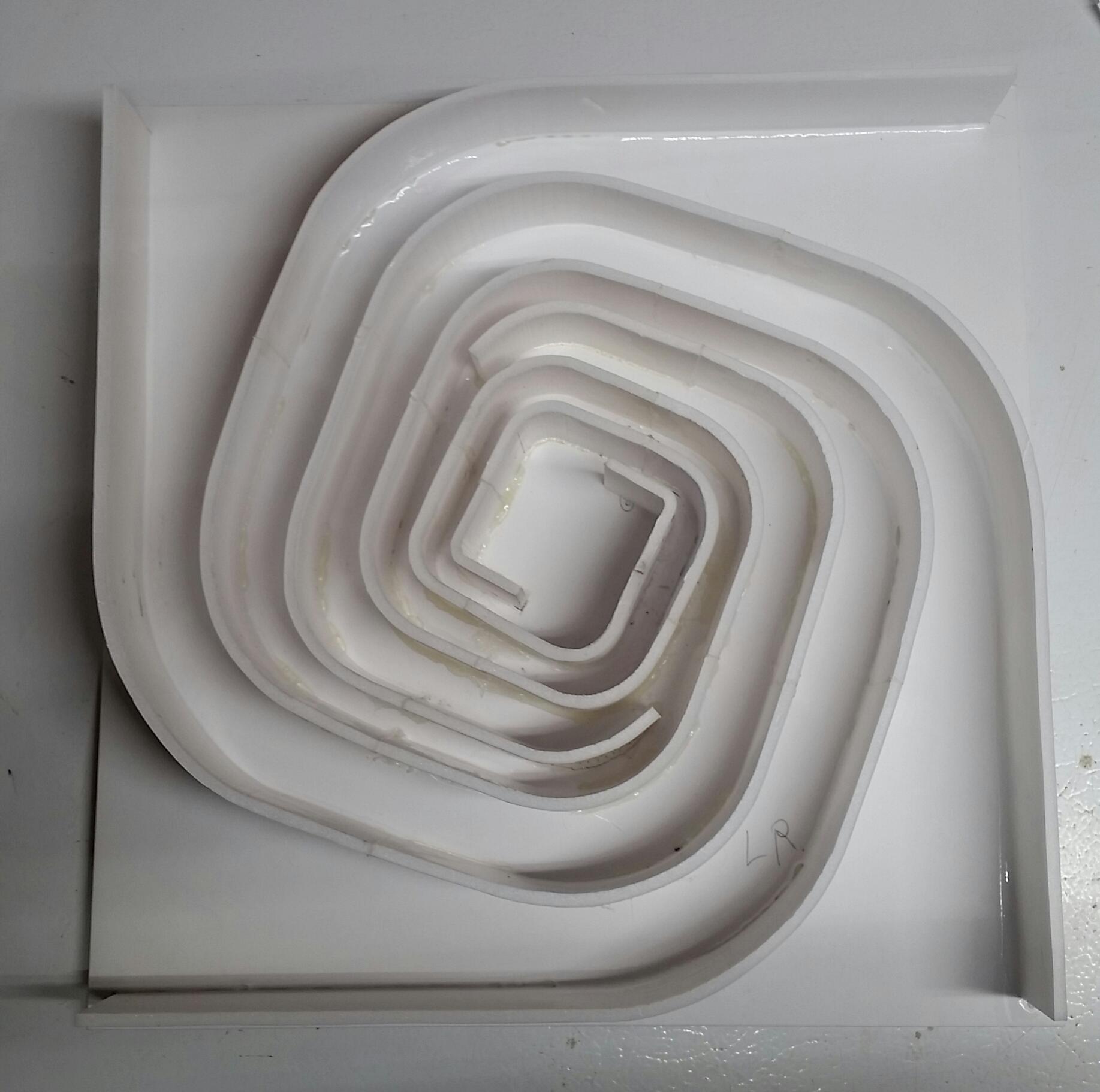

Well, I read about a third of the way through this thread and built one speaker for an Aurasound Whisper. Let's just say it was a good learning experience learning how to make foamcore make those tight bends. 😱
So now I'm going to build two more using what I learned. (Make shark gill slits on the inside of a bend and only glue down short pieces.) But before I do, would someone be so kind as to tell me how deep to make it and the throat area? I'm using the pattern I found here and have it drawn out on a 14" square. The first one I built 14" square by 3" deep and the throat area matched the Sd of the Whisper.

Thanks. I'll build it 2" and then compare it to the 3" I did already.
I'm about 3/4 of the way through this thread now. I have a pair of RS 40-1354 drivers and may have to try them in a 3' by 5" Cornu.

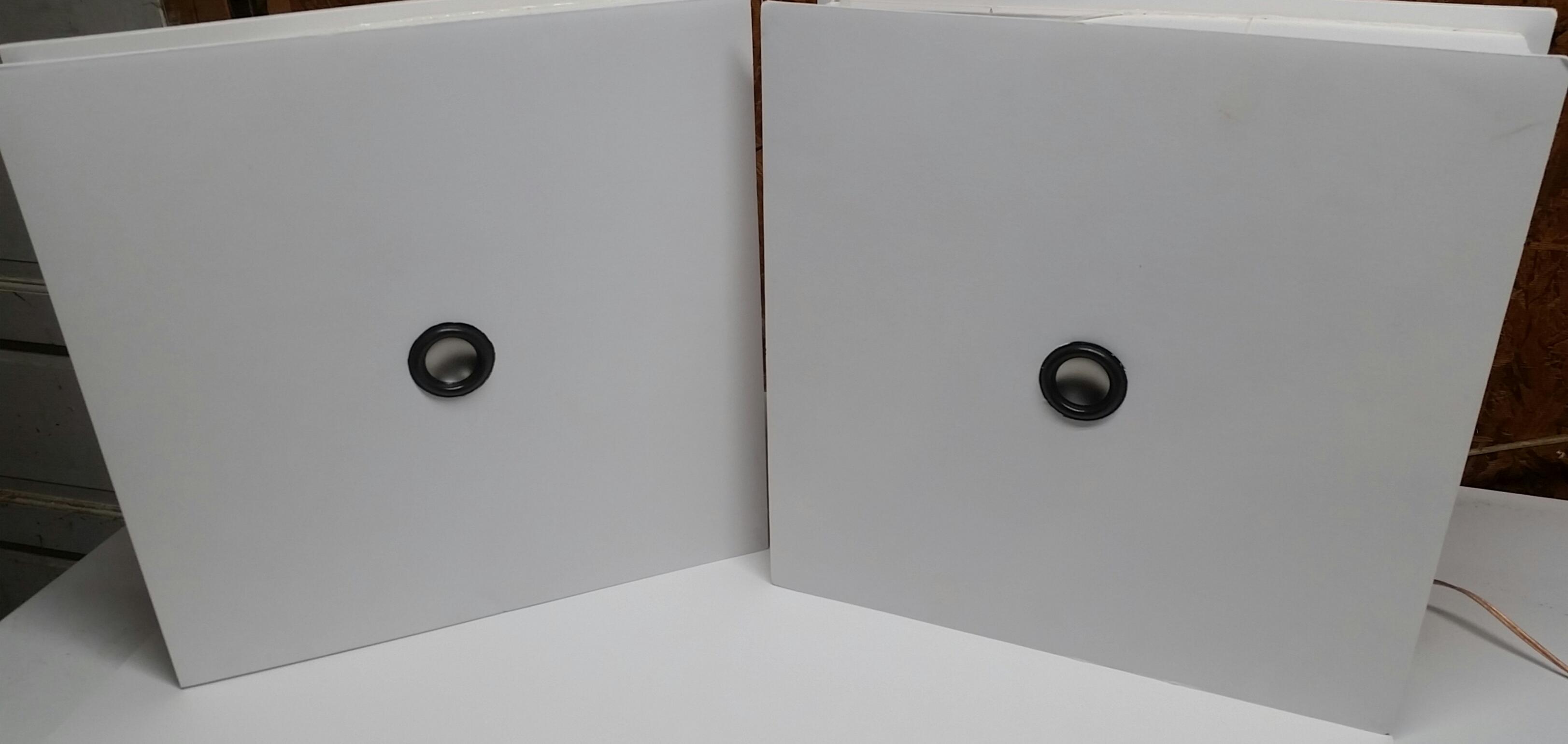

This weekend I finished reading this thread and finished my second Cornu.
Keeping in mind that I listen to primarily acoustic music (bluegrass and folk) but I'm really impressed with these. Acoustic bass is apparent enough to enjoy my music and I really like the mids and highs of these small drivers. The 3" sounded a bit hollow, but I stuffed the horns and I really can't tell much difference between the 2" and 3" deep versions.

Very neat and nice work, Db6546! Glad they worked out for you. This is the first pair I have seen with these small 2in full range drivers.
As X says, very tidy work.
Is that one of the 35mm (cone Foster/JBL drivers?
dave
Thanks, guys.
The driver is an Aurasound Whisper. They were $12.50 on sale.
Aurasound NSW2-326-8AT Whisper 2" Extended Range Speaker Driver 8 Ohm

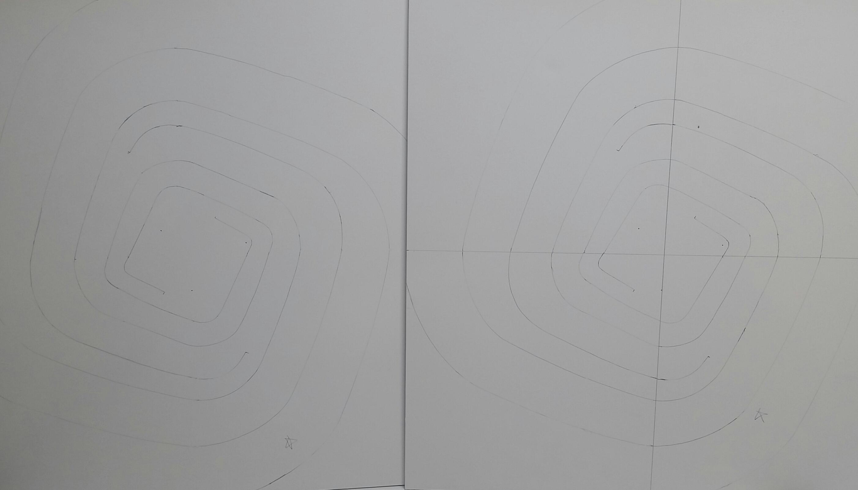

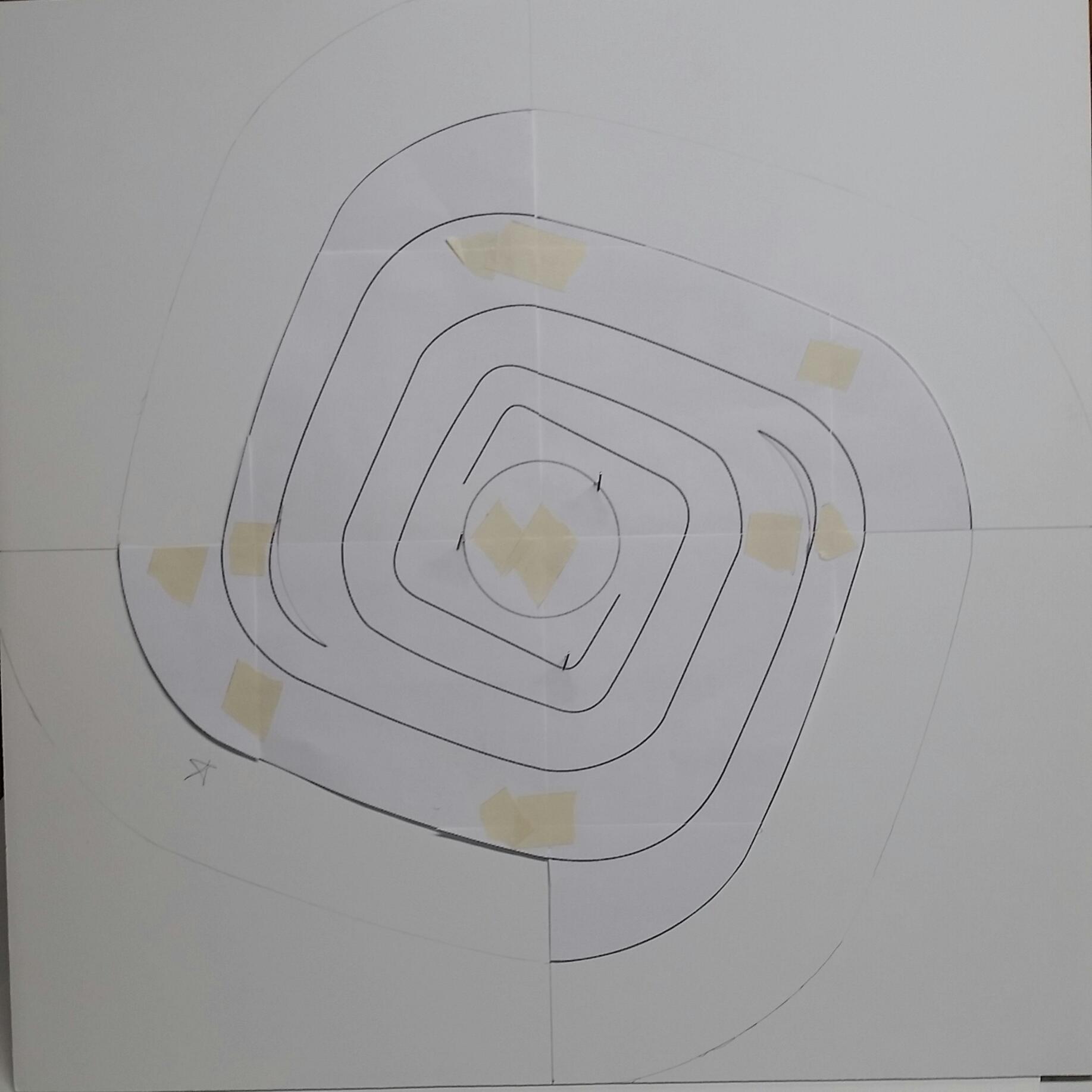

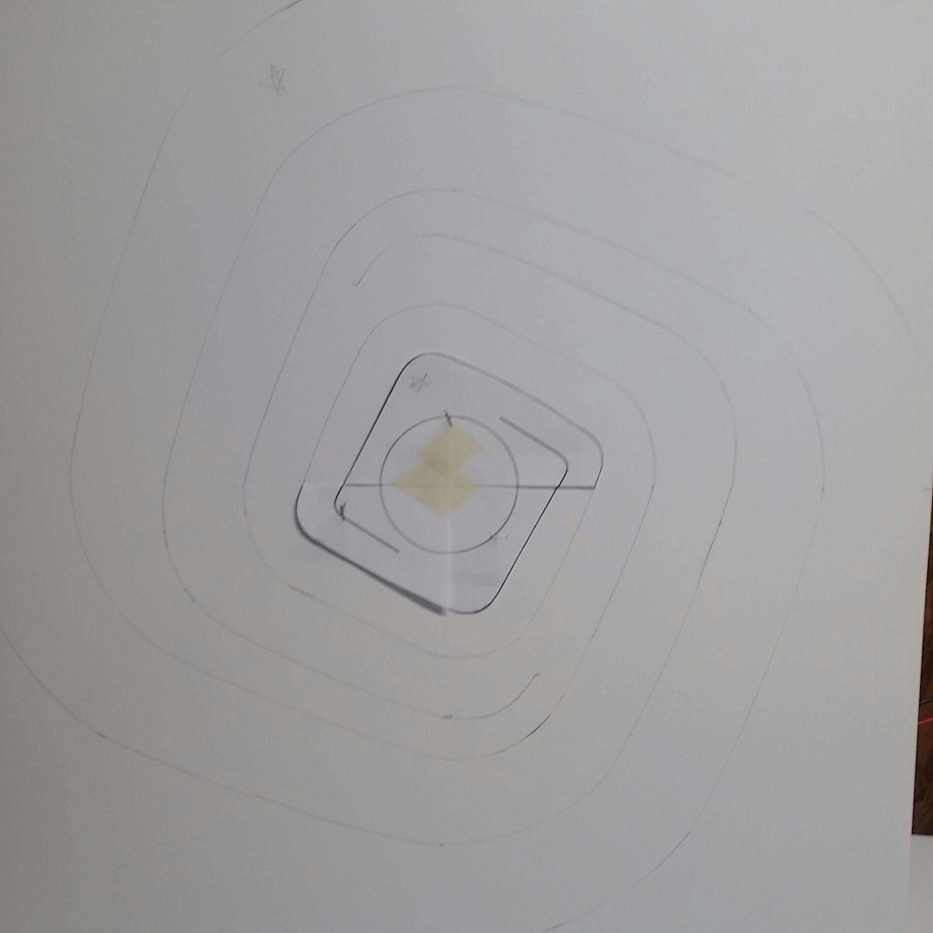

I started laying out the 20" plans on the bottom plates and didn't feel like poking all those holes.
So I came up with another approach. I laid my plan on the bottom plate and pushed three pins in for alignment. Then I put the pattern on the second bottom plate and pushed those pins in again. Now I can remove and replace my pattern on both plates and keep the pattern aligned.
Then I cut the pattern on the outside line in 90 degree segments. I traced the pattern outline, put it on the second plate, and repeated.
Cut on the outside again in 90 degree segments. Trace again.
Repeat. Once you get past the second set of vanes you can cut in 180 degree segments.
It turned out pretty good. It's more accurate than the hole poking method I used on my first set. It may not make any practical difference, but satisifies my OCD. 😀

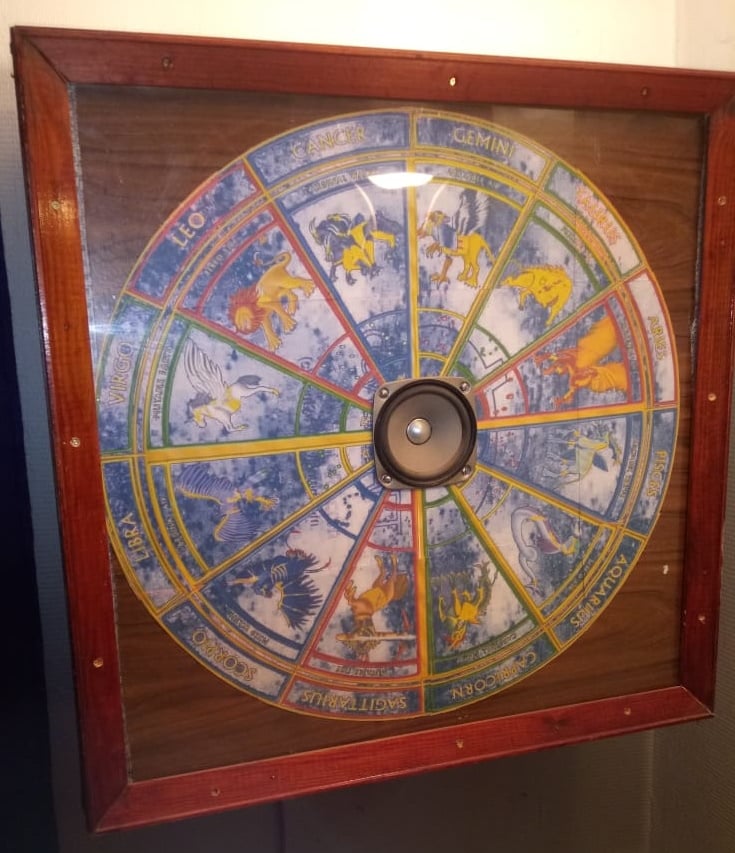

i built these for my wife with Fostex FF125K
You will not be disappointed. That driver in that size Cornu is still the finest I have built to date.I have a pair of RS 40-1354 drivers and may have to try them in a 3' by 5" Cornu.
Damn the torpedoes, full speed ahead!
Wasn’t yours already worked over?
Stock they have some ringing that takes some tweaks and long brealin to minimize.
dave
dave
Bravo! Nice job. How does your wife like them. The astrology motif is genius. I know lots of people who are into that.
