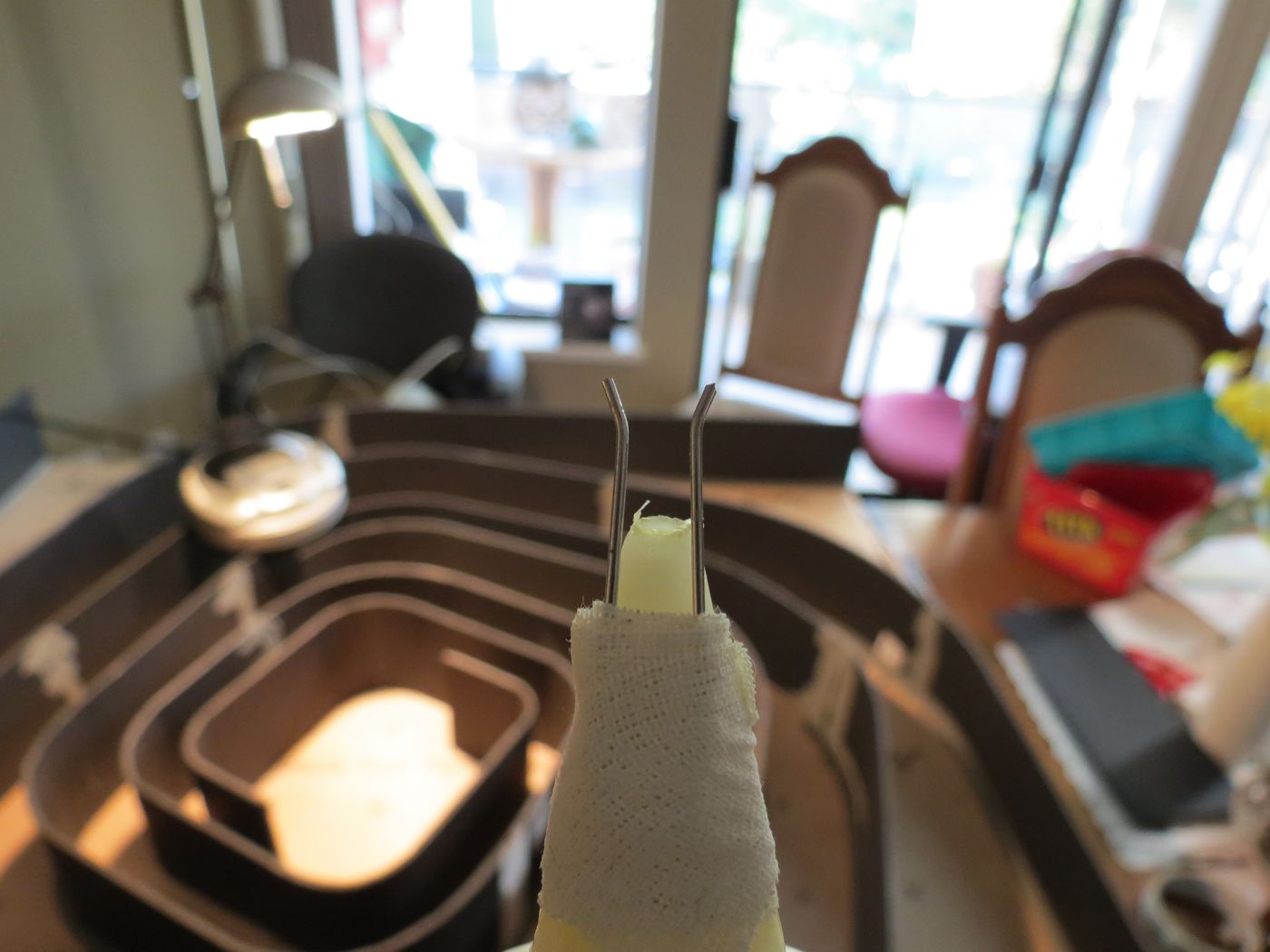

What are we looking at in the foreground of the second pic? Can we see a pic of just it?
...well you know the story. 🙂

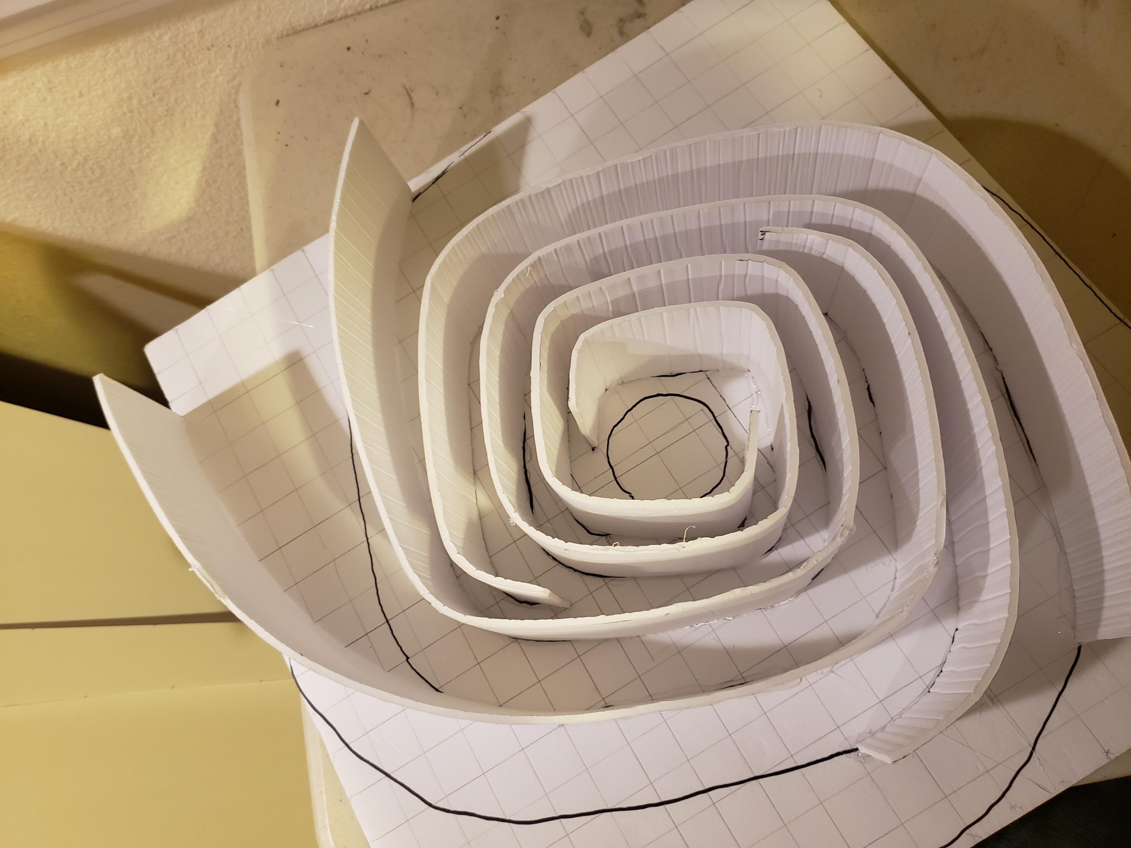

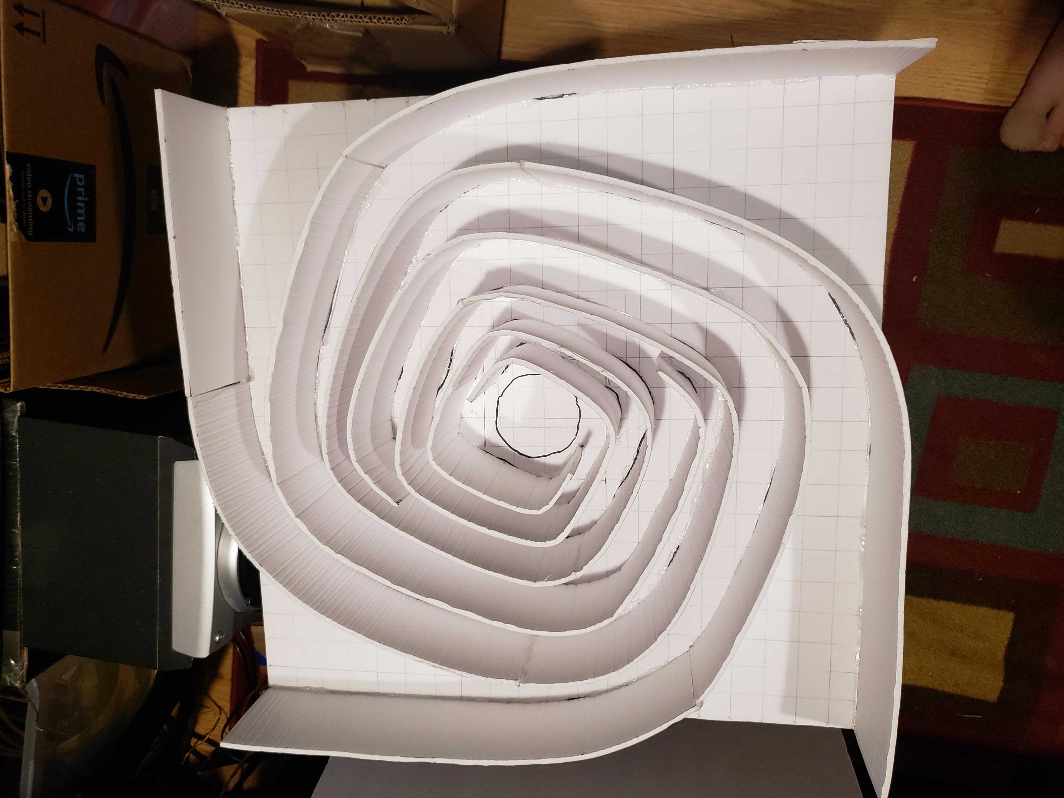

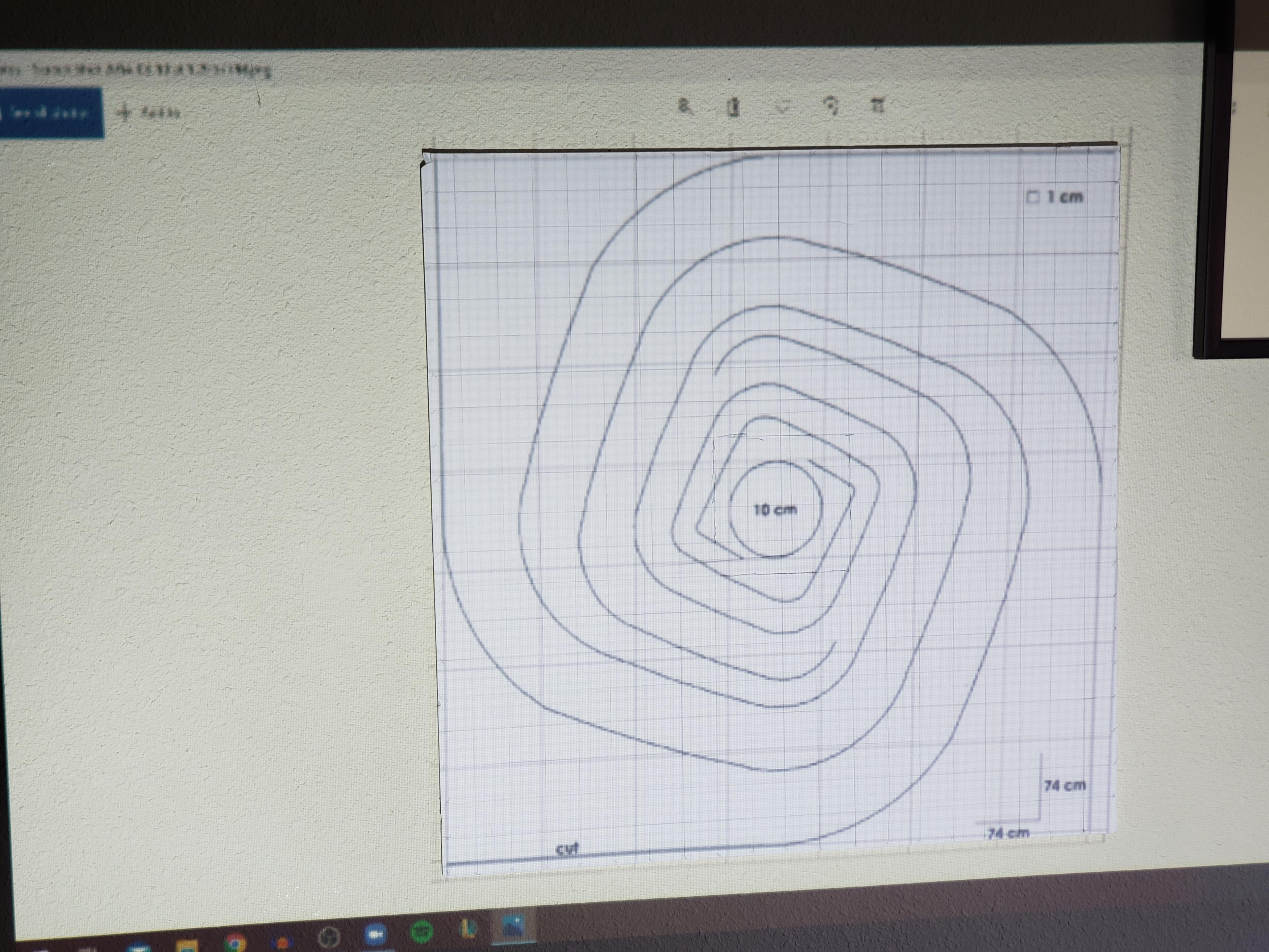

I had a couple of 3.5 inch full range drivers and someone close to me who needed some audio on their wall so I thought I'd give these a try while I wait for the drivers in my other speaker cabinet obsession to show up.

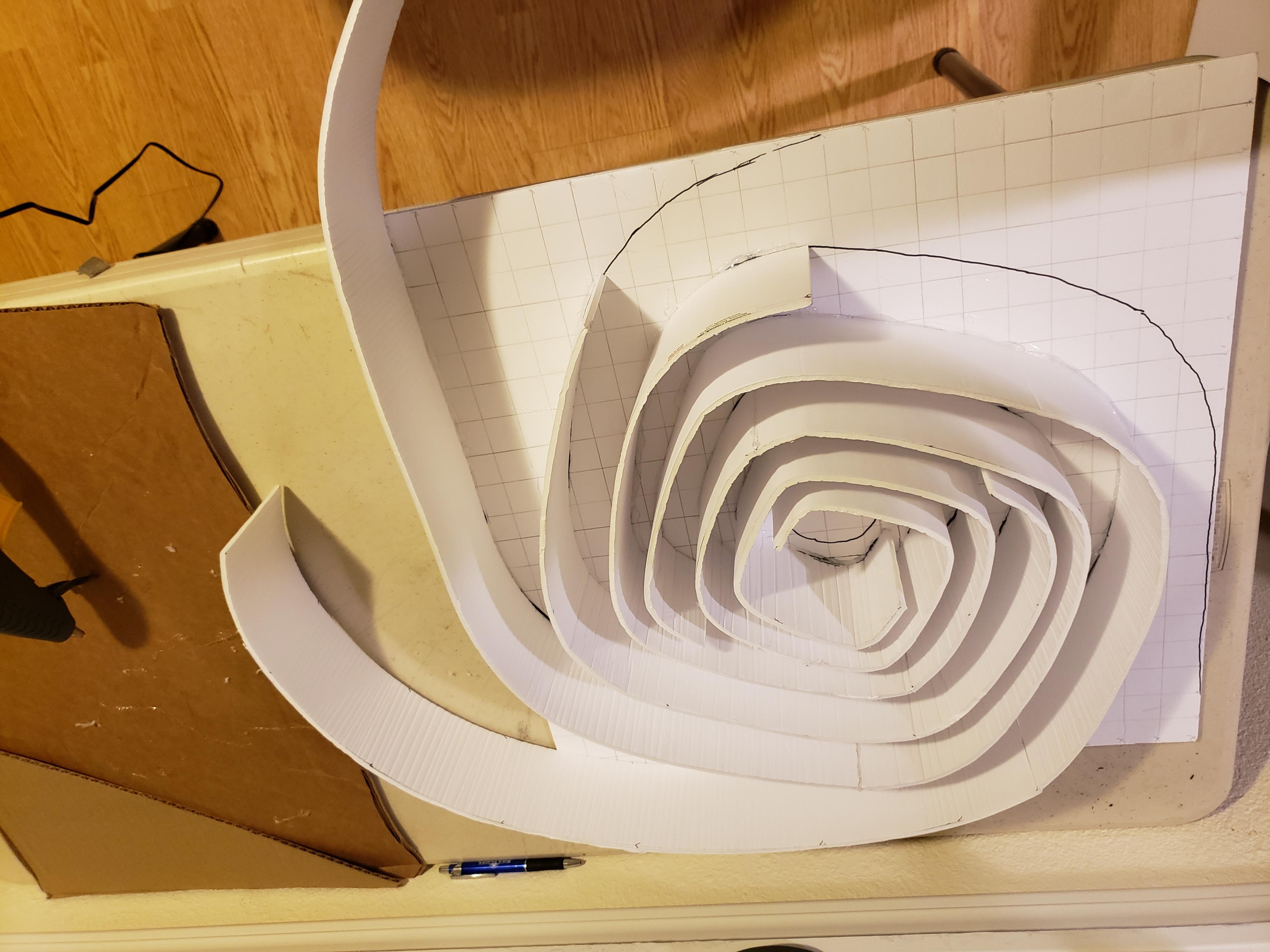

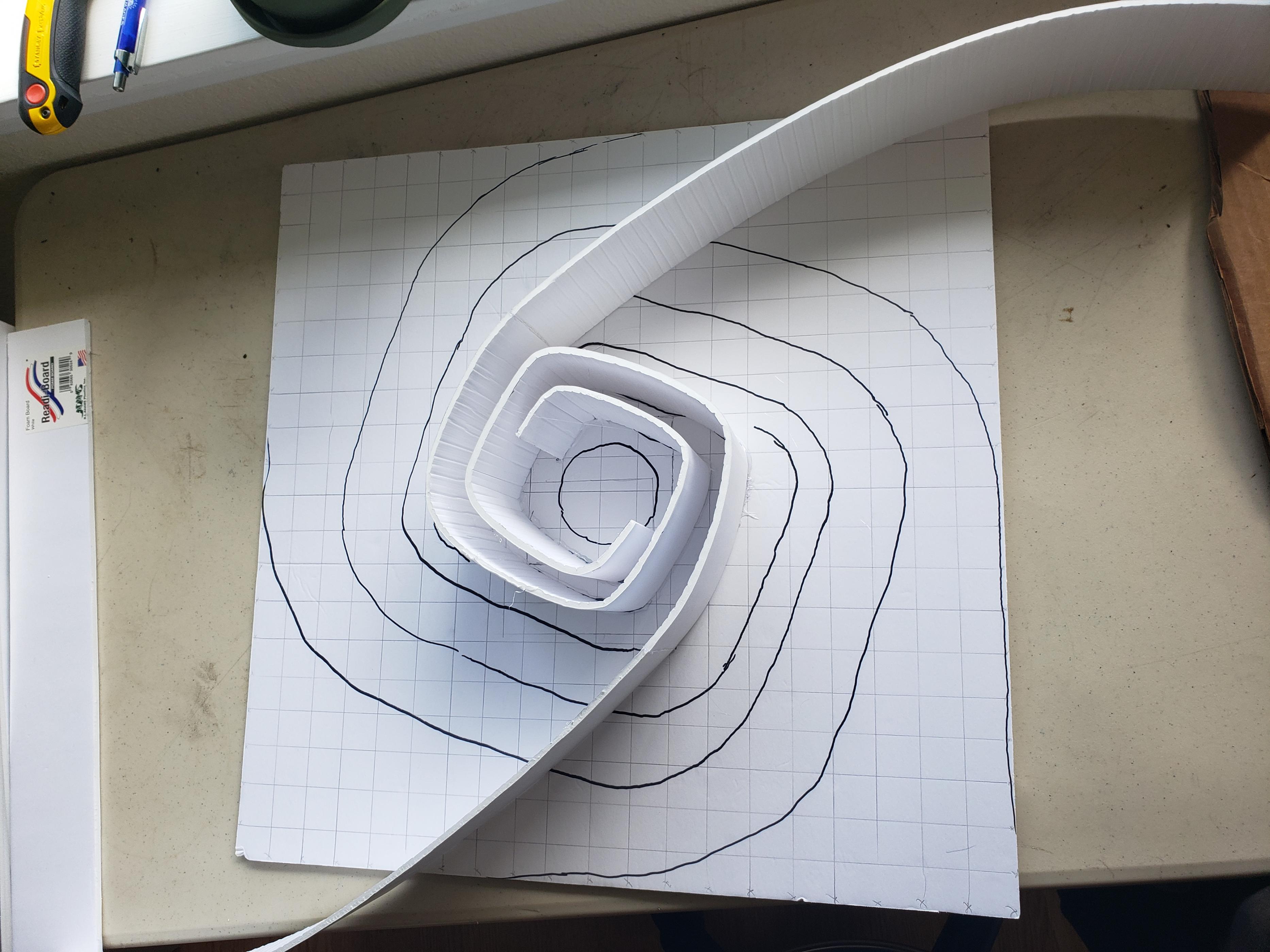

I ended up making a 20x20 base, taping it onto my wall, and using a projector to trace the pattern I'd be gluing with.
Hoping to get the front panel glued on tonight.
Good work. I see you did it by compressing the foam rather than slicing it? When I tried that, the facer delaminated.

Is it even possible to make one of these that can be dis-assembled / re-assembled a few times after finishing? Glue one side, screws into the edge along the horn length on the other? Small embedded plastic drywall fasteners along the horn length? Just to end up with a flappy, buzzing mess?
I'm trying to imagine the skill it takes to apply glue along all that edge length, then "wing it" putting the back side in place, w/o smearing the glue all over. What glue has that long a work time while staying put? Obviously folks here and elsewhere do it successfully -
I'll be right back with a post that shows you how to glue the second piece.
EDIT: Here you go Joe. Simple but extremely effective especially since that is a 48" Cornu that entails 46 feet of foam edge to glue.
https://www.diyaudio.com/forums/full-range/225622-building-cornu-spiral-horn-62.html#post5339219
Also you make a jig to align the pieces. A wall works for one direction and you can use a carpenters square taped to a block of wood for the other direction.

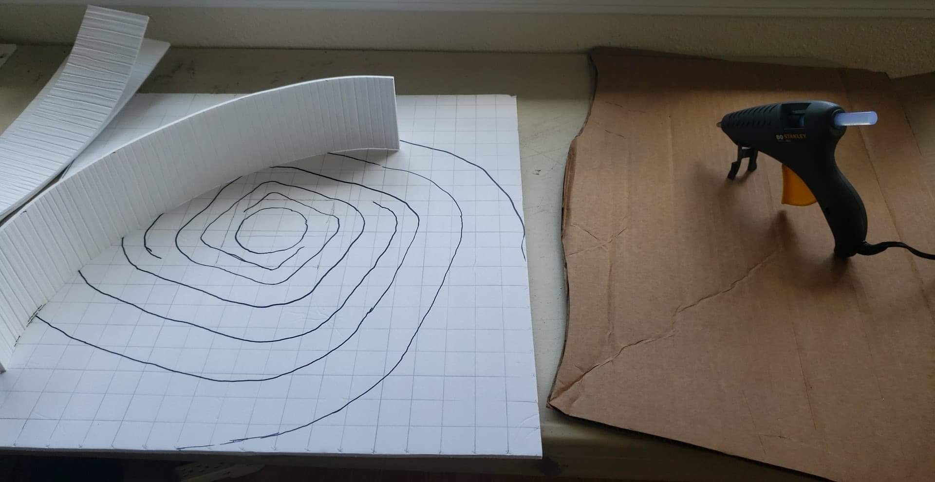

Any reason why a 10x10 inch units with 1.5" drivers would not work? I was given a broken Soundcore BT speaker that could be parted out.
I found some thin corrugated cardboard that can be easily curved into shape and scaled the spirals to the 10" size. The foamcore would be too tight for the inner spirals.
Might make interesting sounds behind desk........
I see no reason why not. If you keep in mind that a 1.5" speaker is only going to go so low anyways, then making the horn much larger might be a waste. Besides, they're inexpensive and not very time consuming.
Not sure how easy to incorporate the cardboard into the mix is going to be. The way I see it, the cardboard is going to be easiest to bend in line with the corrugations but that means the edges you are attempting to glue the baffles to are the open parts of the corrugation. ie: nothing to hold the glue. The first piece will be fine as you can spot glue and then caulk but not the second piece.
