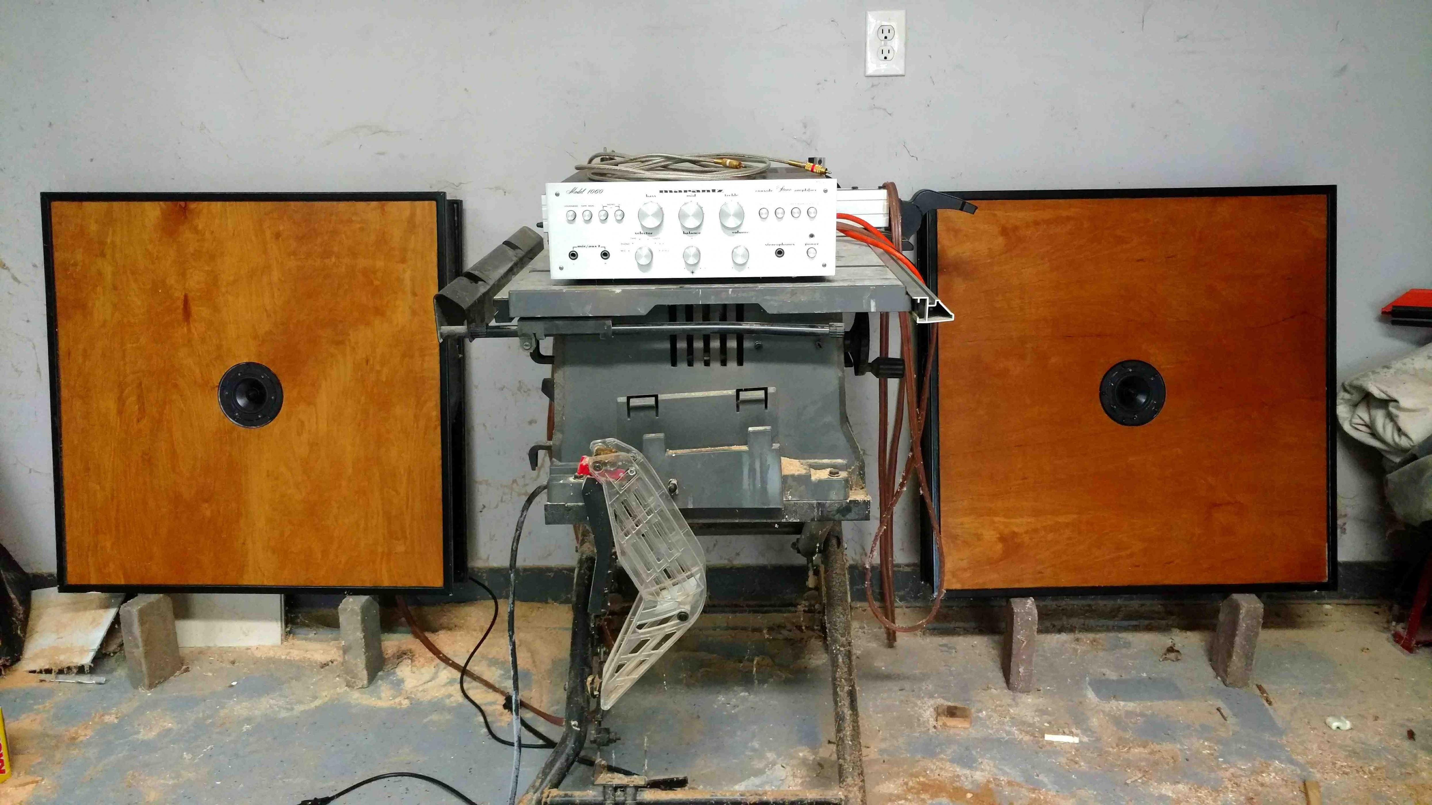

What happens to old abused Cornu's ? They get passed along to someone else for more enjoyment and abuse. I built these 30 " models several years ago for my son's college apartment. They have survived mostly unscathed do to the fact they hung on the wall and folks couldn't stack beers on them. They've been through four sets of drivers : 1 - TB-657S, old obsolete driver, sounded really good in them, little soft up top, 2- WB-1320, sounded OK, liked the 657S better, 3- Pluvia 7, nice driver, sounded the best, nice detail and top end, 4-Dayton RS-100-4, really nice base, fun driver, dull on top. So these ended up back in my garage after college graduation, now they are being donated to another lucky owner for continued enjoyment and I'm sure more driver replacements.

Nice vintage 1970s Marantz Model 1060 integrated amp to go with the Cornus. I hope you’re keeping that.
i'm also donating that 1060, it sounds nice, but can't compete with the Pass class A amps that I've built. Plus I have too much stuff.

Did the Pluvia 7s get blown? Terrible thing to happen to those nice speakers.
I'm guessing trying to run them at heroic party sound levels burned up the voice coils of all of the drivers. I stopped replacing the drivers after he burned up the Pluvia's, when my son had to spend his own money to replace the drivers he cheaper out and got the Dayton's, and they still survive.

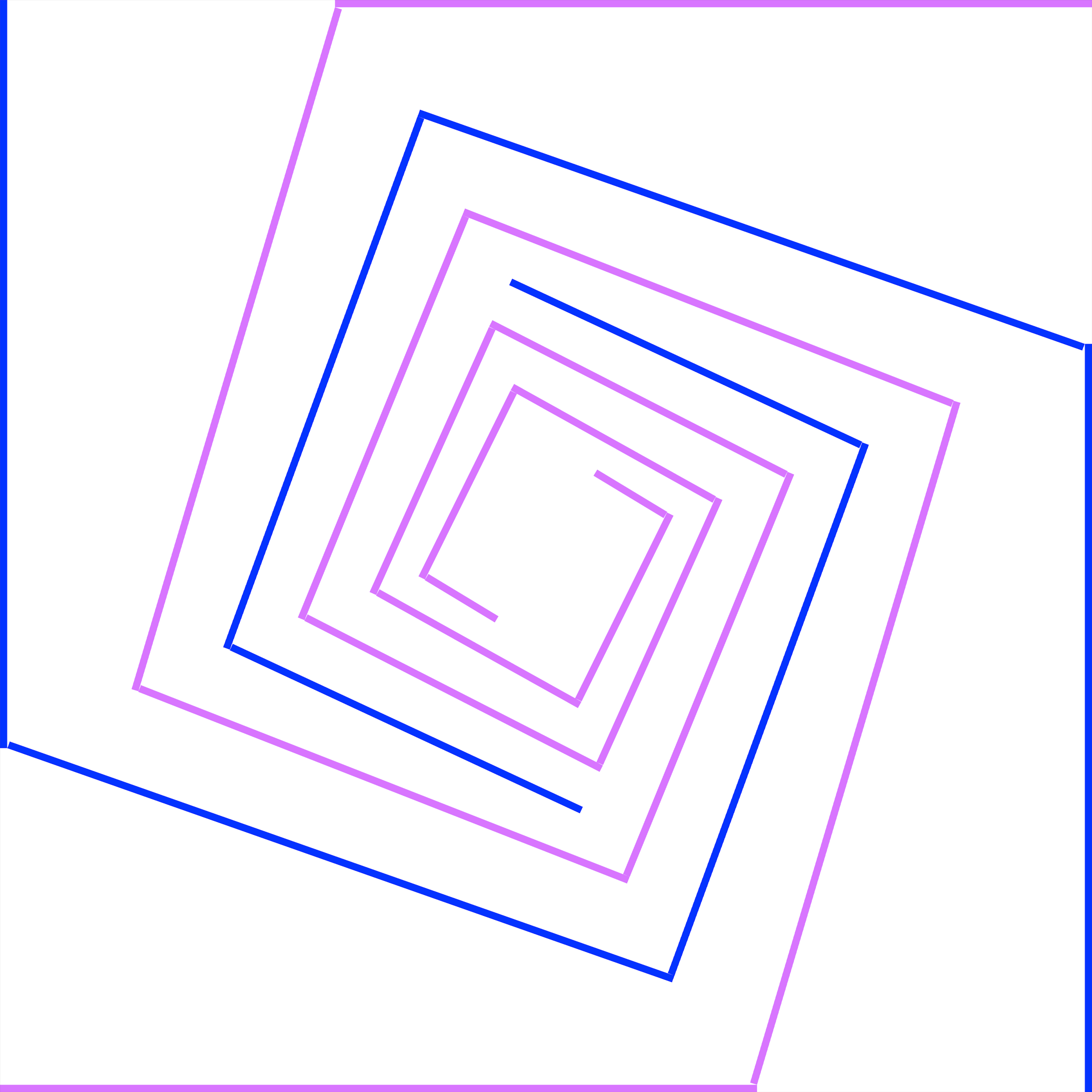

I haven't even finished up with my last build, and I'm already planning my next. Since my previous attempts at easy build versions of cornus had issues, the first with very short horn lengths, and the next being a TL and not a horn, I decided to take some time and make a proper template that was more true to the dimensions of the original. Here's the (p10 inspired) design. This is a 75cm version; I needed the extra centimeter to account for the thickness of the foam board (5mm) and make the straight lines work.

What if we keep initial lining just like yours (semi straight) and remaining half with spiral formation?

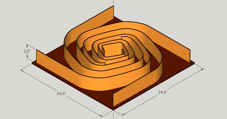

As I said in my presentation I am a carpenter and I want to do them with the minimum possible cost. For this I will take advantage of a board of 244x122 cm (4x8 ft) 8mm thick, the spirals will be made with 4mm plywood flex.
I want to make them following the pattern of the cornu_orj pdf, the dimensions mark 74x74 cm which I suppose is the max measurement that fits a standard piece of plastic cardboard. To fit them in the measure of board would have to scale it up to 61 x 61 cm, (2 'x 2') the question is what would be the internal height of the speaker? If originally they are 4" their scale would be 3.3" is that correct ?.

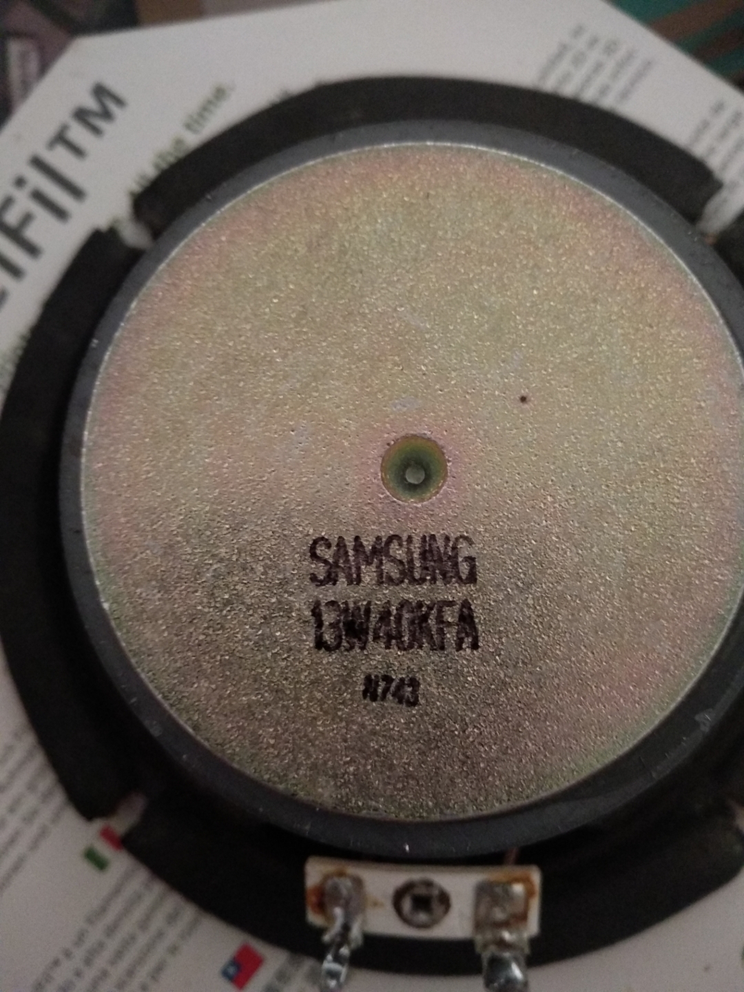

I have 4 "speakers that a friend gave me where there is no more inscription than the one shown in the attached photo, of which I cannot find more information.
In any case it is an experiment, I am not asking the Z dimension of the baffle for this transducer that we do not know but for a transducer that you can recommend me to buy in the future.

The Cornu is very flexible with the driver type. If you want ideal, pick one with a moderate to lower Qts (0.30 to 0.45) to have a stronger motor. Pick a 4in nominal for the 28in square size. Those are 5.5in deep.
A 3.5in driver can go with 20in to 24in x 3.5in deep.
I have used moderately high Qts TC9FD and it works well there too. A Faital 3FE22 (24in) or 4FE32 )
(28in) would be perfect. Get the neodymium motors.
Smooth response and high sensitivity with powerful motor.

In this case the 61cm (24 ") I will make the internal measurement of 3.5" and test with this transducer.

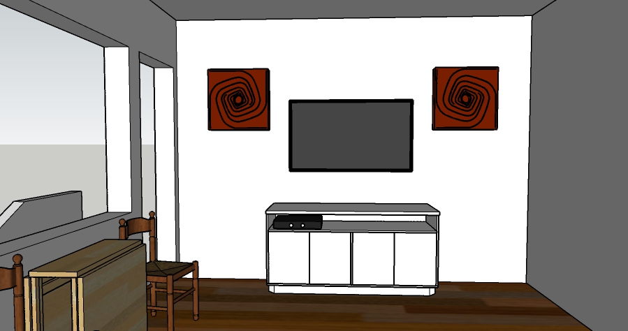

One question, do you make the symmetrical speakers, right and left turn (mirror) or are they both the same way? make them symmetrical or not can they influence the sound in the room?
This would be the planned position, I don't have many more options
