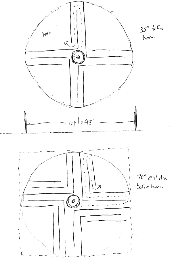

Has anyone tried designing/making the Cornus with a circular face and back rather than square?
I thought I had posted this but...
You could try something like this. I haven't made it yet, I guess we should have xrk's thoughts on the workability. ie: should we make it straight or tapered, expanding or contracting? How long should the line be? I think the bottom one has potential.
Interesting...I’ve been picturing spirals rather than right angles which may limit it to 2 exits instead of 4. That would make it a yin-yang Cornu. 🙄 I’m also hoping X will chime in. Curious for his thoughts.

Interesting design. The length of the channel is not expanding so it might have a trombone like sound. The final expansion is probably too rapid and you will lose a lot of efficiency. Try a more gradual expansion and you can still fold it like a labyrinth and make the final expansion a bit more like a tractrix.

I’m intrigued by Cal’s second sketch. With X’s recommendation to make the length expand as it goes along, it would be interesting to compare the same relative sizes of square vs circle (e.g., 24” x 24” using Dave’s scaling PDF (Foam Core Board Speaker Enclosures?, post #230 of the foam core thread) vs a 24” diameter circle using Cal’s right angle path) and see how the 2 path lengths compare.
One question that comes to mind is the expansion rate of Cal’s path? Maybe expand it at each turn so it isn’t so abrupt when it reaches the opening? As X has pointed out before the right angles will act as a better low pass filter than the curves of the spiral, if that is a desirable result. The 2 methods will provide for more driver flexibility as well.

Dave, he was asking about a circular baffle. We have already deduced the problems with a true spiral horn vs. that with 'corners'.
Guys, I have 2 minute hand sketch you are looking at. Two minutes 'cause these old hands take that long. As I asked, I have wondered about the expanding horn line, and it would be nice to know what the driver chamber size, throat size for each of the horns along with the expansion rate, the total length, and what is acceptable for the 'dump' into the exit horn.

The thing about having corners on the box (rectangular or square … is that that provides for a larger circumference for a larger mouth and greater expansion at the end.
